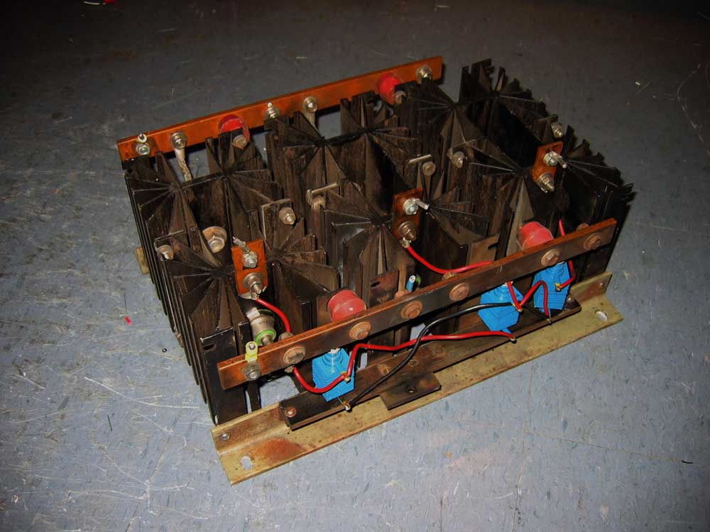

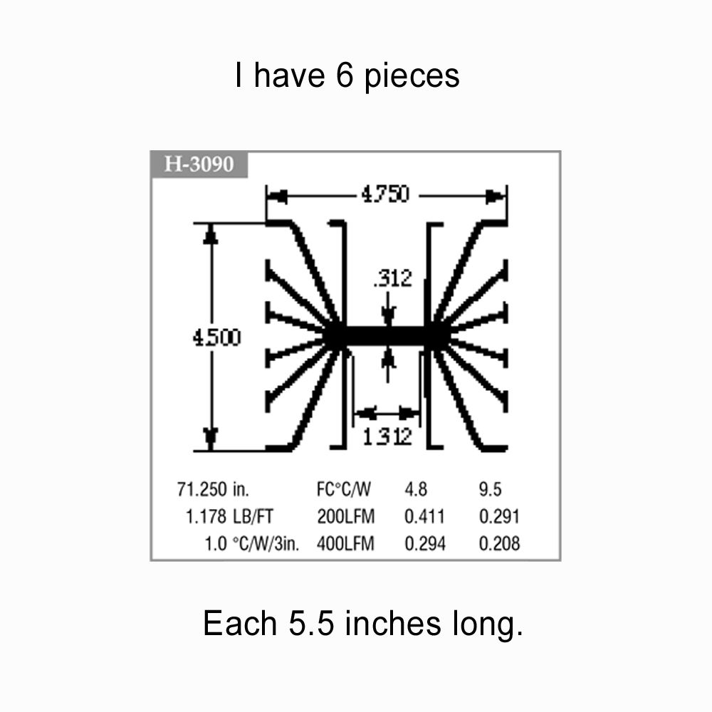

Heat sinks
I put the calipers on them and each one measures verbatim to the attached Wakefield. I don' tknow how to calculate what it can cool, nor do I know how to estimate such things on an amps output devices. I was wondering if you guys could give me some approximations? I aquired the amazing KSA-50 boards recently, perhaps a fit or even the 100? I guess it is pending bias current and number of output devices.
I'm looking for ball park #'s if possible.
Shawn.
whoops...sorry
missed the number and length part...
you have a total of about 0.1c/w, so you can dissipate the output from a ksa100 with little or no fannage...cool, literally and figuratively
Stuart
Stuart

Stuart Easson said:you have a total of about 0.1c/w, so you can dissipate the output from a ksa100 with little or no fannage...cool, literally and figuratively
Stuart
Thanks!
Good for two channels or one? I don't want fannage! 😉
Shawn.
well...
...as in all things there are way too many variables to make really definitive statements...
But if you build the amp with 44v (loaded, ~48v unloaded) rails (minimum for 100w/8ohms), and run the bias at 2.5A (~100w class A/8ohms) you have 2x44x2.5 watts per channel, or 440w total. With your sinks and close to perfect distribution of heat and airflow you would get a 44c rise above ambient, normally assumed to be 20c, for a total heatsink temp of 64c, ~160f. Your sinks would be a little too hot to touch, but nothing would explode...personally I'd start at 1.5A bias and slowly run them up to the point where the heat was about 'right', ie no burning of people/cats etc, but enough so the amp is 'slamming' properly.
So both channels, no fans needed there, but not a whole lot of extra headroom either...
As I said before, good find...
Stuart
Stuart

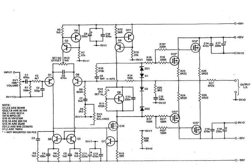

Zen Mod said:
even if I saw more than few amps with 150-180 K in feedback leg (and I mean on bip based diff stage ,not jfet or mosfet) ......mebbe is 100K and 4K1 and 10UF more appropriate........in that case- 3db corner will be under 4Hz
I'm sure that difference will be audible.
who knows?
mebbe even without 10UF,just dc coupled,with one eye on the scope 😉
just an example

film caps in NFB loop
Hi Zen,
when you read the article that goes with the JLH80W, you see that he chose the parallel pair of 4u7F plastic caps first and then calculated the resistive components to suit.
The problem is that he chose too high a turn over frequency resulting in -1db @ 27Hz. The lower leg resistor value should be raised by a factor of 3 to 10 times. Then the gain is way below JLH's target, but much closer to the gain many others use today.
But the really attractive use for this technique (and still keep the low value NFB resistors) would be dedicated use for mid driver or treble driver when the high pass turnover point can be tolerated at 100Hz or even much higher.
