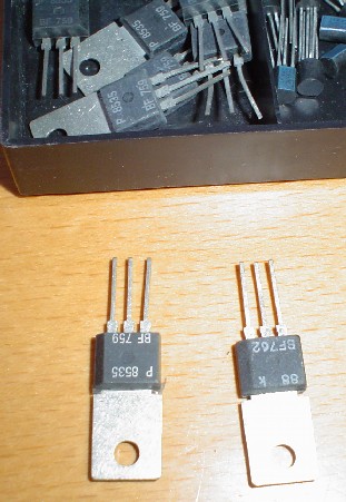

Motorola and even TI used to make a number of BD and BF devices in that longtail X17 package during the KSA100 days.
The ones that come to mind are Motorolas BD389/390.
100V / 1A / 25 watts, with lightning high Ft.
TI used to make 10 watter 250V BF615/616 and 300V BF617/618, but those were only good for 200mA.
Bare in mind that this KSA50 could be a modified version.
I seem to recall that the owner of the posted KSA50 resides somewhere overhere. In the late 80s and early 90s hacking together upgrades and conversions seemed a national sport.
I've contributed a few to the list of corpses myself.
Here's a pic of what those devices look like for the ones who are unfamiliar with them :
Of course P8535 stands for Philips, 1985, week 35.

A closer view
When i enlarge/sharpen the detail in PowerPoint it sorta looks like a GES logo.
Definitely not Motorola, but could be TIS(TI).
GE semiconductors was the only company to produce BD139/140s in a TO202 package, called BD139G/BD140G.
The longer flange neck definitely makes it a US production X17 imo.
European ones had the edges of the flanges really close to the body, like the Philips ones i posted.

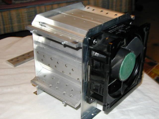

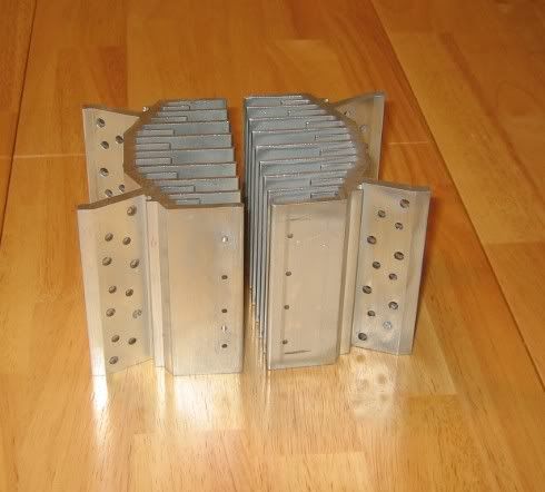

Hi Mark,
I am probably one of those who will use TO-3 devices if I go with the tunnels I have. I am contemplating using the chassis from my Aleph-X though since I am dissatisfied with how it sounds anyway. I'm not sure if it has enough heatsink without some sort of fan but it is tempting to try. It is set up for plastic devices. If I use the two tunnels I will have two fans running and 24 TO-3 outputs for the two channels. I suppose I could just run 4 pair per side, but since I have enough devices and the tunnels accommodate 12 devices each, I don't see the harm in running 24. Someone correct me if I'm wrong.
Here's some pics of the tunnel.
Here's some pics of the Aleph-X chassis.
Blessings, Terry
Blessings, Terry
Hi Still4given,
what temperatures did your tunnels achieve in the 50Klone @ what dissipation?
Looking at your pics the short tunnels taking 12devices may be a bit small.
I see nothing wrong with running 6pair for each channel, you just need to adjust the quiescent current for each so that the total matches the 100Klone requirement.
It will be dissipating about 260W per channel which is quite a bit more than the 50Klone and nearly matching the stereo pair of 50Klones (310W/pair).
I thought you complained about the fan noise, have you got used to it? or found a solution?
AndrewT said:Hi Still4given,
I'll have to look back to see what temp I had. I am running 12 devices on the tunnel for the KSA50 in stereo. It doesn't over heat though. You are right, I did complain about the fan noise. I think it is because it is in my little studio and it sits at ear-level, about a foot away from a painted drywall wall. I believe if it were in a rack in a carpeted room it wouldn't be too objectionable. The solution I found for the fan noise was a Symasym, but we probably shouldn't go there again. 😀
