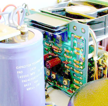

Mark A. Gulbrandsen said:... I wonder what those devices mounted to the bar are....?
A question I asked several times in the other thread and never got an answer to.
I remember posting that photo and asking the same question and getting ignored too. I would bet our KSA-50 is a mid generation KSA...
