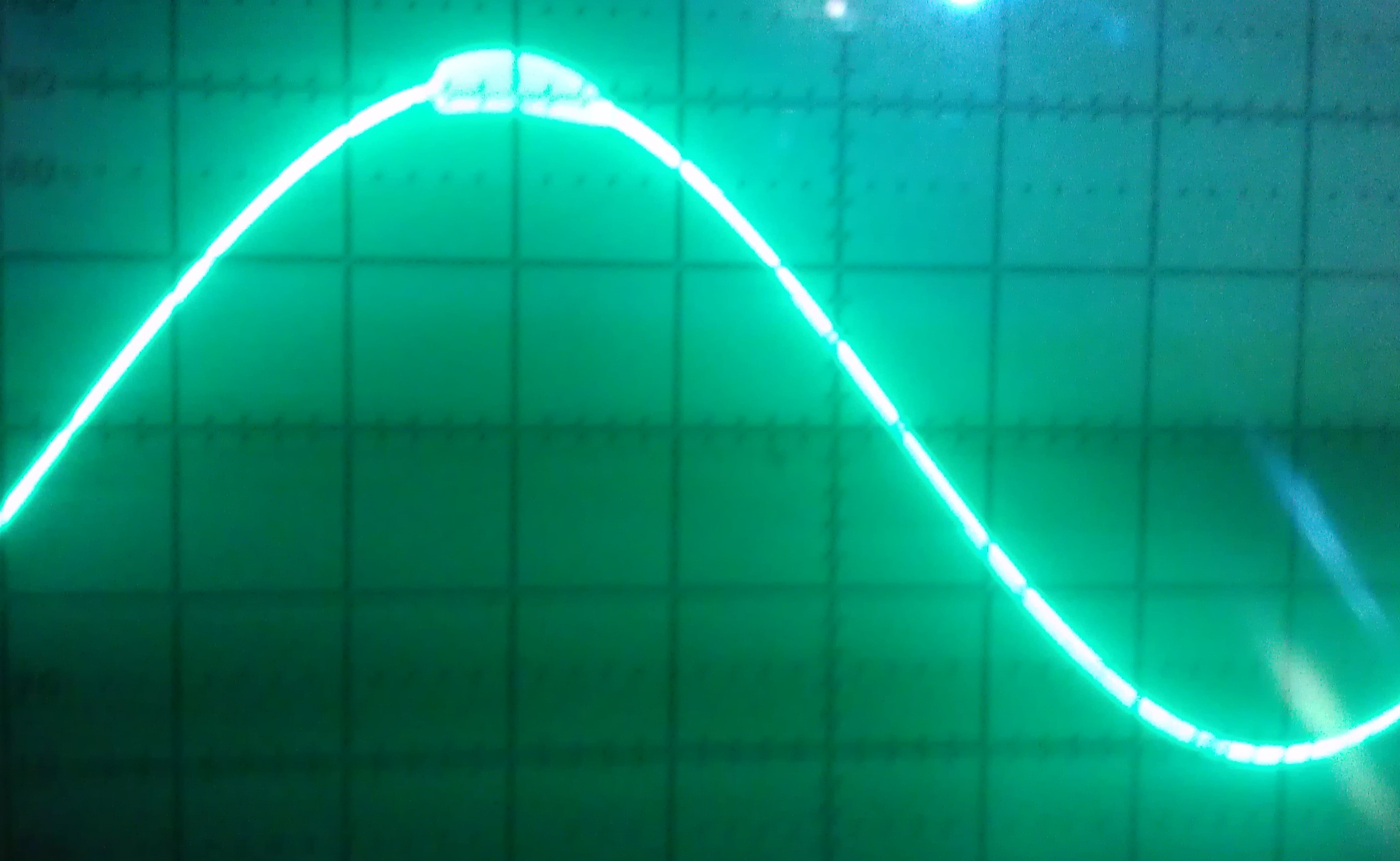

Testing my 3-chanel version of the amp on 4Ohm resistor I found that it rings on about 7MHz when going to AB.
I've tried to increase C6 and C5(Cdom) to 82pf, parallel R15(NFB resistor) with 20pf cap, but it didn't help. The only thing that helps is to increase bias till it in the pure class A. Please advise.

perhaps compare it to your working channels and see what is different, I think you mentioned you were considering faster VAS or driver, maybe that's where your instability issue lies?

All of the 3 channels show the same behavior, but I've pulled one of my monoblocks and it behaves completely normal under the same conditions. They share pretty much the same topology, except the misbehaving one uses SC4793 + SA1837 in VAS - I'm going to replace them with MJE15034/5 and see what will happen.
I've checked DC around 1N5309 and it seems to be consistent with 3mA current source.

Length of the wires to the bases of the output stage was the problem. Reducing it to 2-2.5" did a trickTesting my 3-chanel version of the amp on 4Ohm resistor I found that it rings on about 7MHz when going to AB.
What were the lengths before ....?

The length was about 4" IIRC
