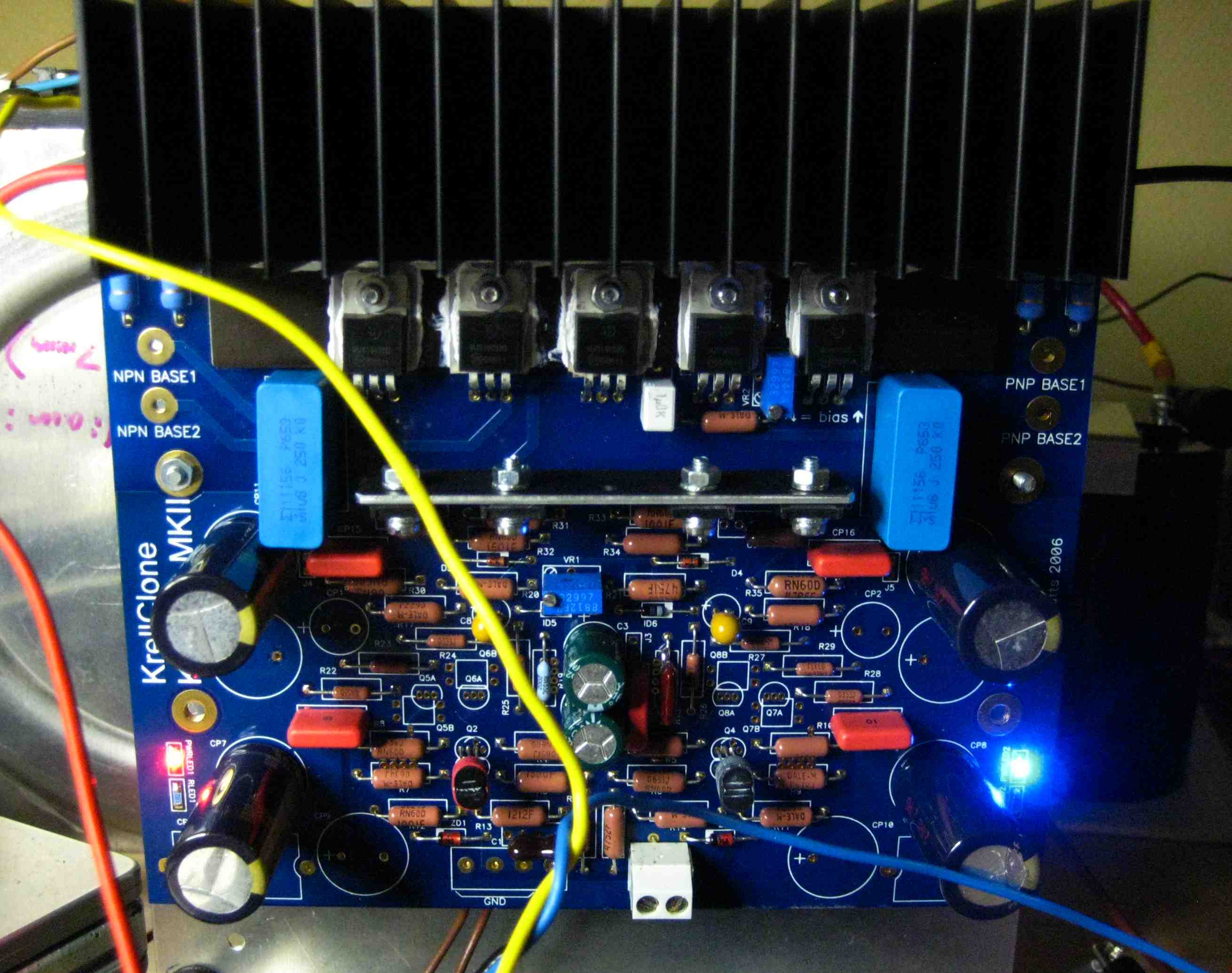

Finally, I have started to move forward with my own projects.

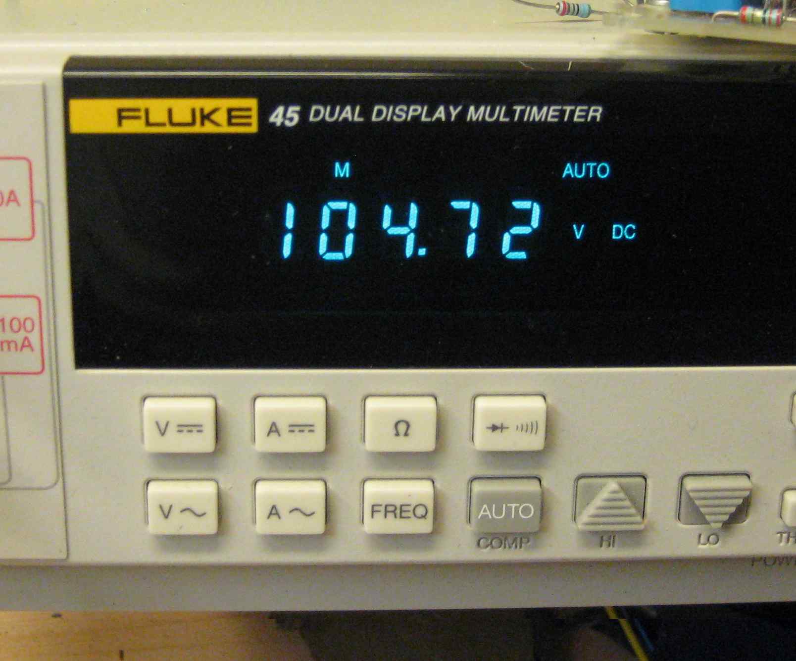

This night I managed to get one main board to work. I just connected the finished board to the DC power source and checked with 2 x Amp meters
for to have control over current/power drawn. It looked fine in the very first and I checked the DC output. I had to trim the bias pot to max bias for to get some current readings. At the maximum bias set it draw only 83 mA and the total power was calculated to be approx 9 watts. But that was enough for to check everything, also the functions.

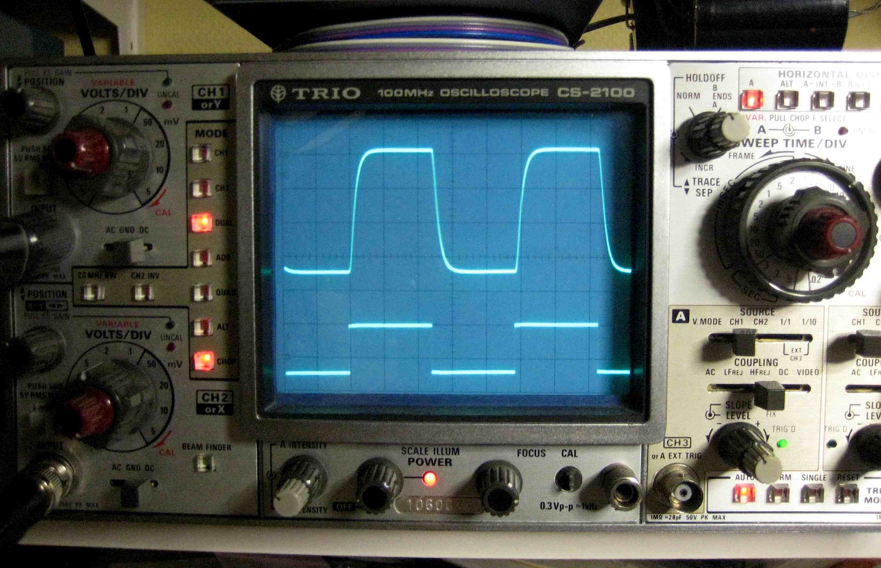

No DC on output, OK. Then I installed a resistor, 4W/1 kΩ paralleled over the output and GND and then I connected a function generator to the input
I checked with a sin wave at the first and everything looked good so far.
At a frequency of approx 170-200 kHz the output swing started to go down but that was Ok if taking to account the feedback capacitor
Then I also checked with a square wave and that was really good. I was a little bit curious of how it should behave if driving the amp with a square wave. And there was no surprises to see...
This main board was the first one ever checked and tested so from my point of view it looked promising for the 5 left..... I have a total of 6 main boards 🙄
Below are a few pictures of the test set up and of the mainboard under test.
