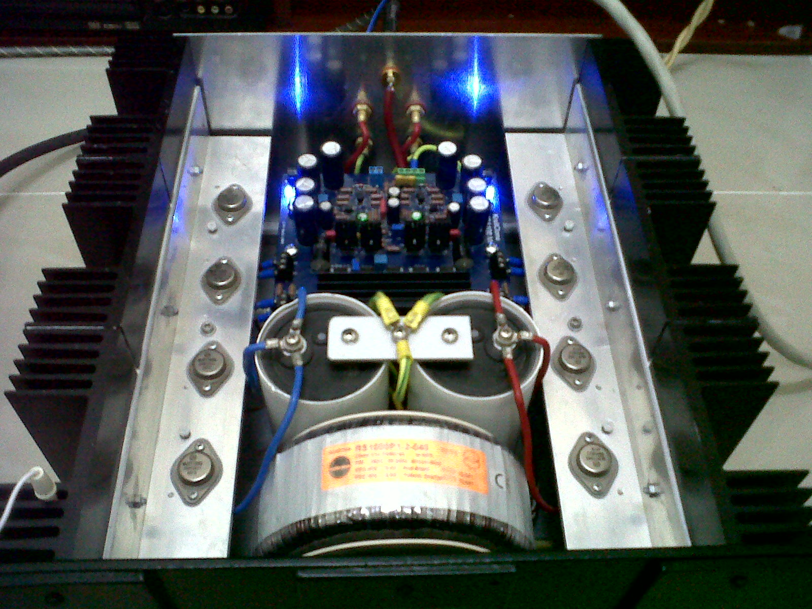

Thanks a lot guys. Man I was shocked when I saw that the wiki was gone. A thread that big and they killed the wiki. Looks like someone started a new so that should be good enough. I haven't decided whether or not to use TO3 or plastic yet. I am contemplating stripping my Aleph-X and doing a passive unit with plastic devices. I've never been satisfied with the AX and that huge coffin might make a nice KSA. I already have two KSA 50's, one with TO3 and one with MJL4281/4302. I have plenty to go either way. The plastics are enticing because I won't need tunnels or fans. I might go down a little in rail voltage too. Don't you just love DIY?
The regulated supply looks interesting too. I did that on my Low TIM.
Thanks, Terry
Hi Terry, just curious about the two you have built. Is there any substantial difference between plastic and TO3 transistors?
Not that I can hear. If I switch from amp to amp they are pretty much identical. I prefer the design of the one with the TO3's. For the plastics I put two flat panel heatsinks fin to fin to create a sort of tunnel. This pic is how I intended to do it but it was too tall so I stood that on end in the center of my case with a hole in the bottom under the sinks then put the fans in the back panel blowing air out of the case. This forces the air to be drawn in the bottom of the sinks. I think the sinks get enough air but the case gets really hot for all the hot air coming out of the sinks.
Here's a picture of the TO3 model sans the case.
yes I agree, TO3 construction looks very robust. I don't know how your fans are, but some of the quiet pc fans these days are incredibly quiet.
