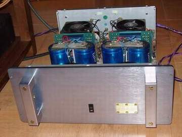

We just moved and I now have a larger listening room. So the KSA-50 wasn't quite big enough but it will,work in an upstairs system. Got my Aleph 2's out of storage and am running those. 100 watts class A is about right for this room so that's what made me want to take the KSA-100 prototype that's still sitting in the garage and finish it properly. The transformer in it now gives me 70 volt rails! So when I was doing the initial tests I used a 20 amp Variac to bring it down. I don't want to unwind this particular transformer because it's a 2KVA dual secondary transformer from a huge Crest amplifier.. It might come in handy to build that KSA-200 some day.

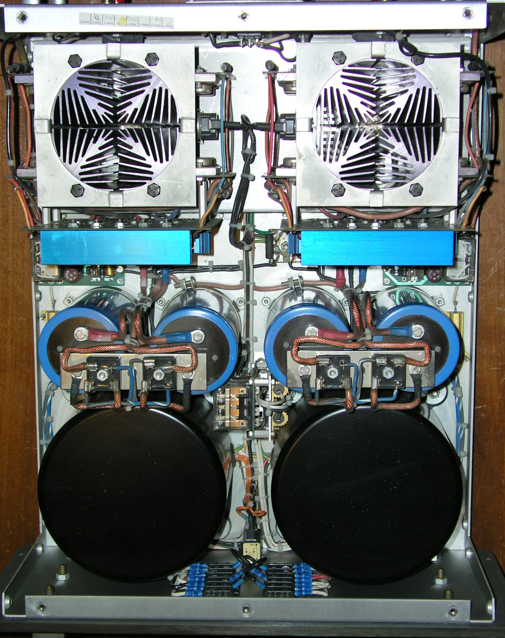

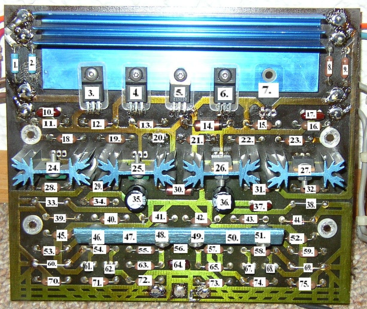

Hello,
I had the KSA 100 MK 2 and the KSA 100 MK1.
My MK 1 was one of the last Version.
Look at the Picture my MK 1 Board.
What ist the difference to the MK 2 Board
KSA 100 MK 1 is more musically as the MK 2.
More tube Sound, but a Little less bass control.
Bye Alex

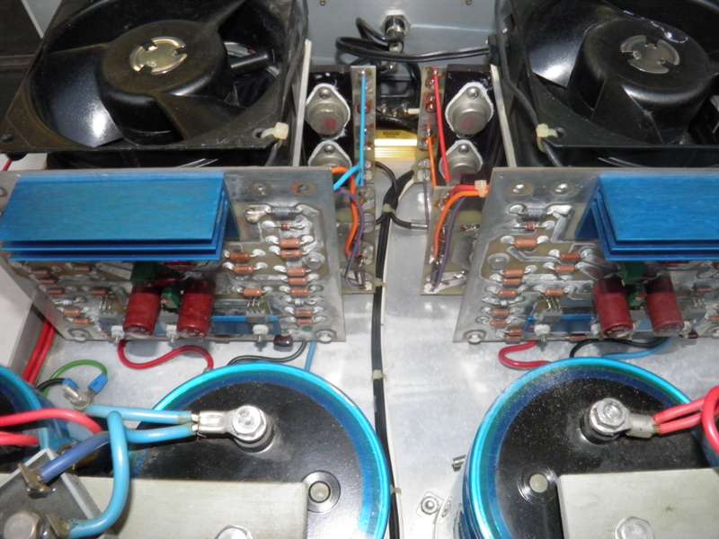

I found the MK-2 version to be the better one. It is a bit more complex than the Mk 1 version though. Here is a picture of the board from the KSA-100 thread It is the MK-2 version.
Hello Mark Allen,
Yes, a bit. Maybe better an lower impedance.
The KSA 100 MK2 have a other power supply with two rectifier and Sprague capacitors.
The KSA 100 MK1 is much more livelier and full tube Sound.
I can't see a difference to my MK1 Board and Mk2 Board.
thanks Alex

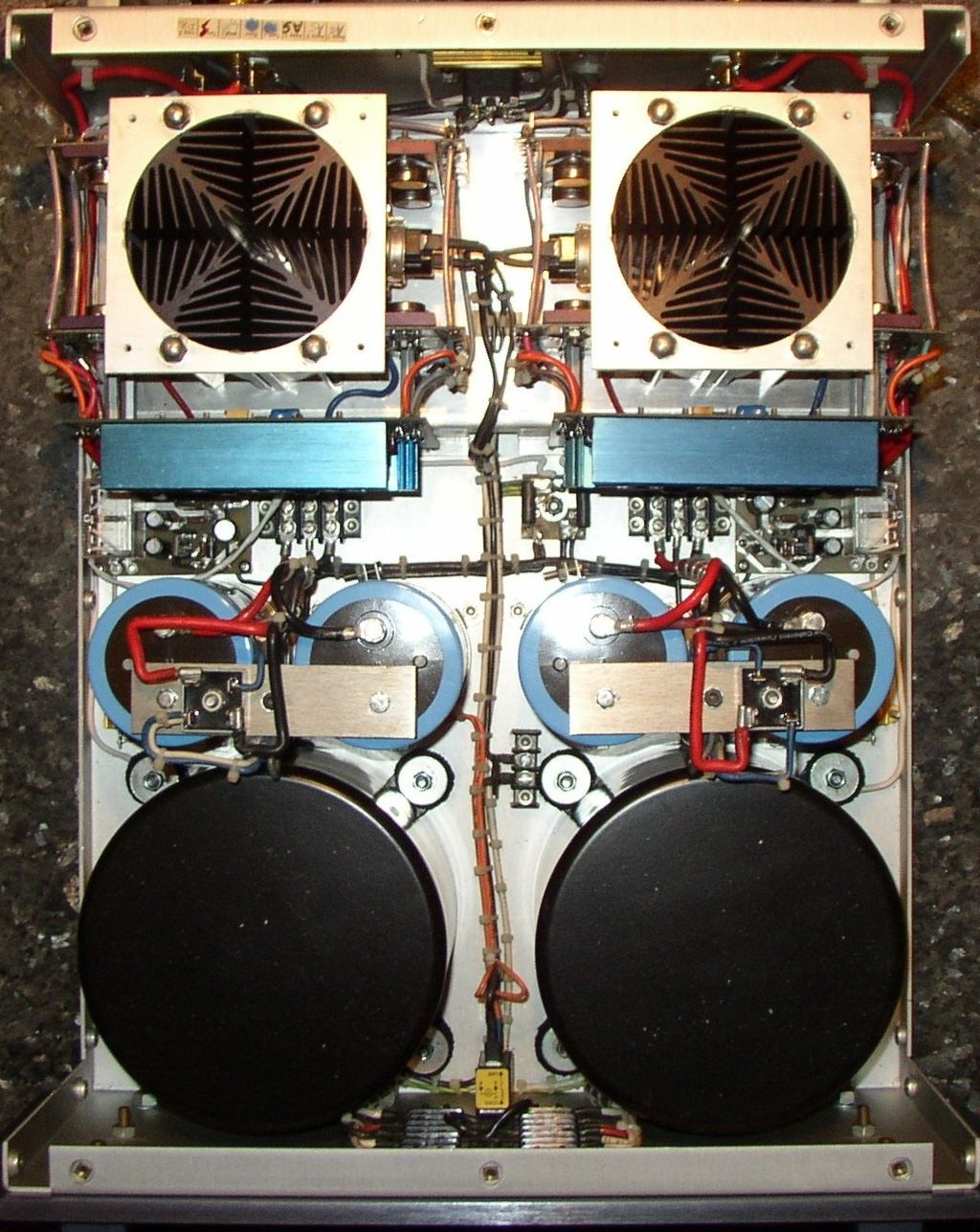

My MK 1 and MK 2

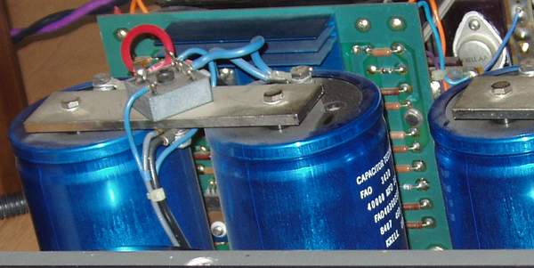

The first thing I'd be doing to that MK1 is replacing the 30 year old main electrolytic's. I see a 1984 code date on one of them!! I will try to post schematics of both types today so you can see difference.

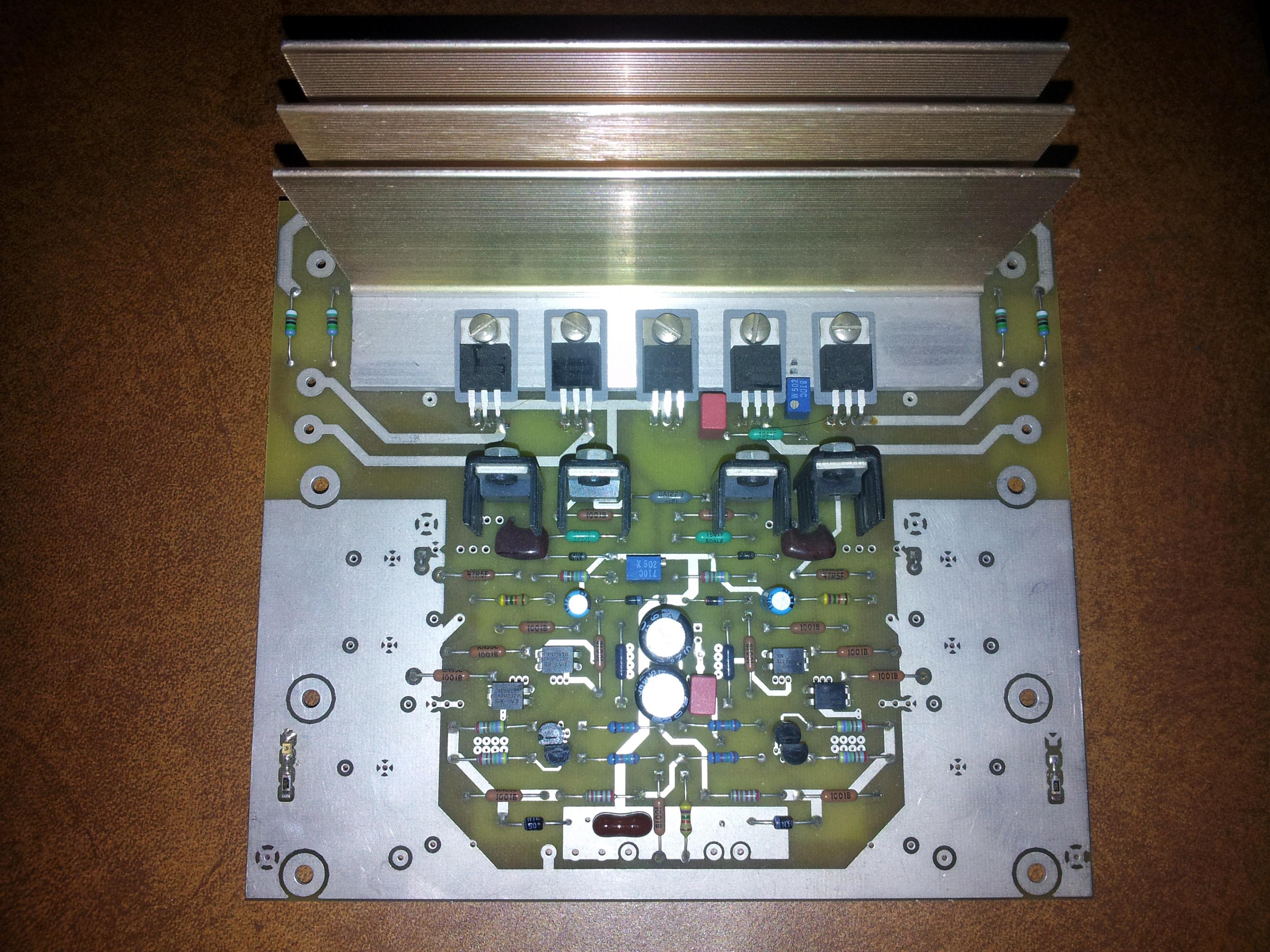

In the process of procuring parts for a 100mkII build. The pre-driver mosfets I'm planning on using are 2SJ313/2SK2013. How do we determine the proper region for these particular fets to be operating in? I've read the entire thread and I remember AndrewT saying that he'd put a resistor in series with a higher current rated diode to bring it down to roughly 3mA. Being that the 1N5309 is next to impossible to find (Newark says some are on order).....would something like these work?

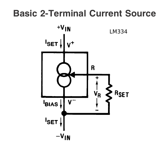

I'm curious if replacing 1N5309 with JFET current source is a simpler and better option then finding the original
1N5309

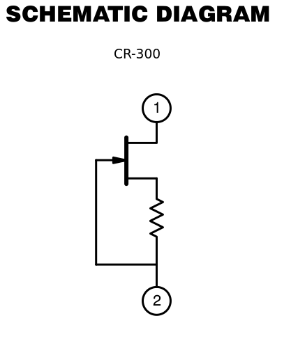

Indeed, the schematic/boards I'm using also spec CR300, which is a jfet current source in one package, as a direct replacement for 1N5309. But along with the 1N5309 is tough to impossible to get a hold of. The board I have also specs a LM334 in the D5/D6 position.
If going for the jfet/resistor as our D5/D6, which jfet/resistor combination would be suitable for 3mA, using 2SJ313/2SK2013 fets? I'm assuming a low noise jfet would be of some importance.

FYI: According to the newark website the 1n5309 is in stock, with more than 100 remaining...not that I bought any to test the hypothesis...

For the sake of trying to understand....I've been reading AN103 document (attached, and a bit beyond my knowledge), I realize it may be basic questions, but in regards to the jfet current source....Being that I'm using different mosfets than the original, 3mA was set for the orig VN0210N5/VP0210N5. I could compare datasheets, but not really sure what parameters need to match or be close. And....I'd like not to spend 60USD on....diodes
