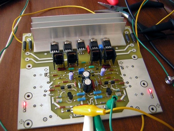

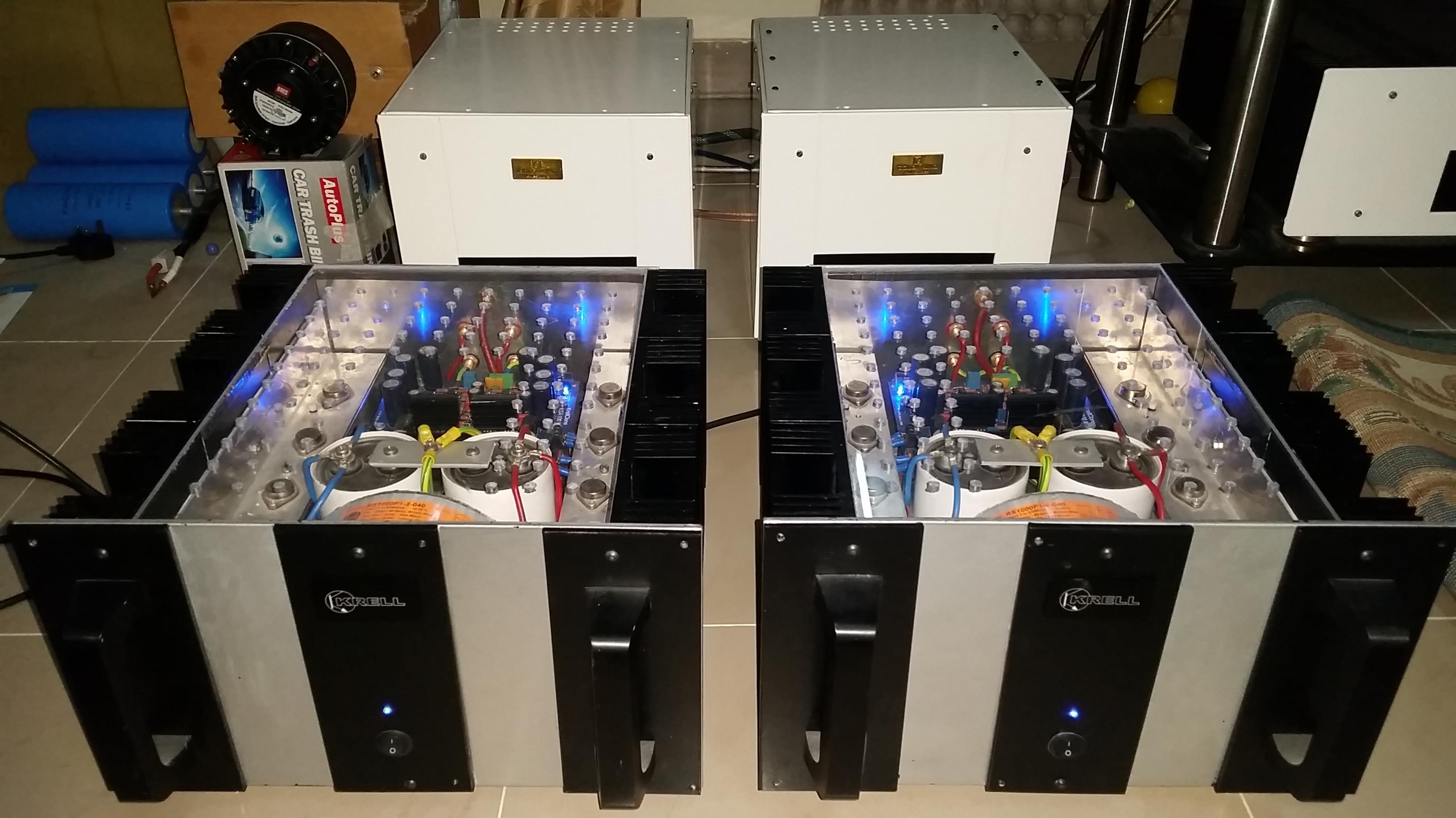

Completed and sounds great.

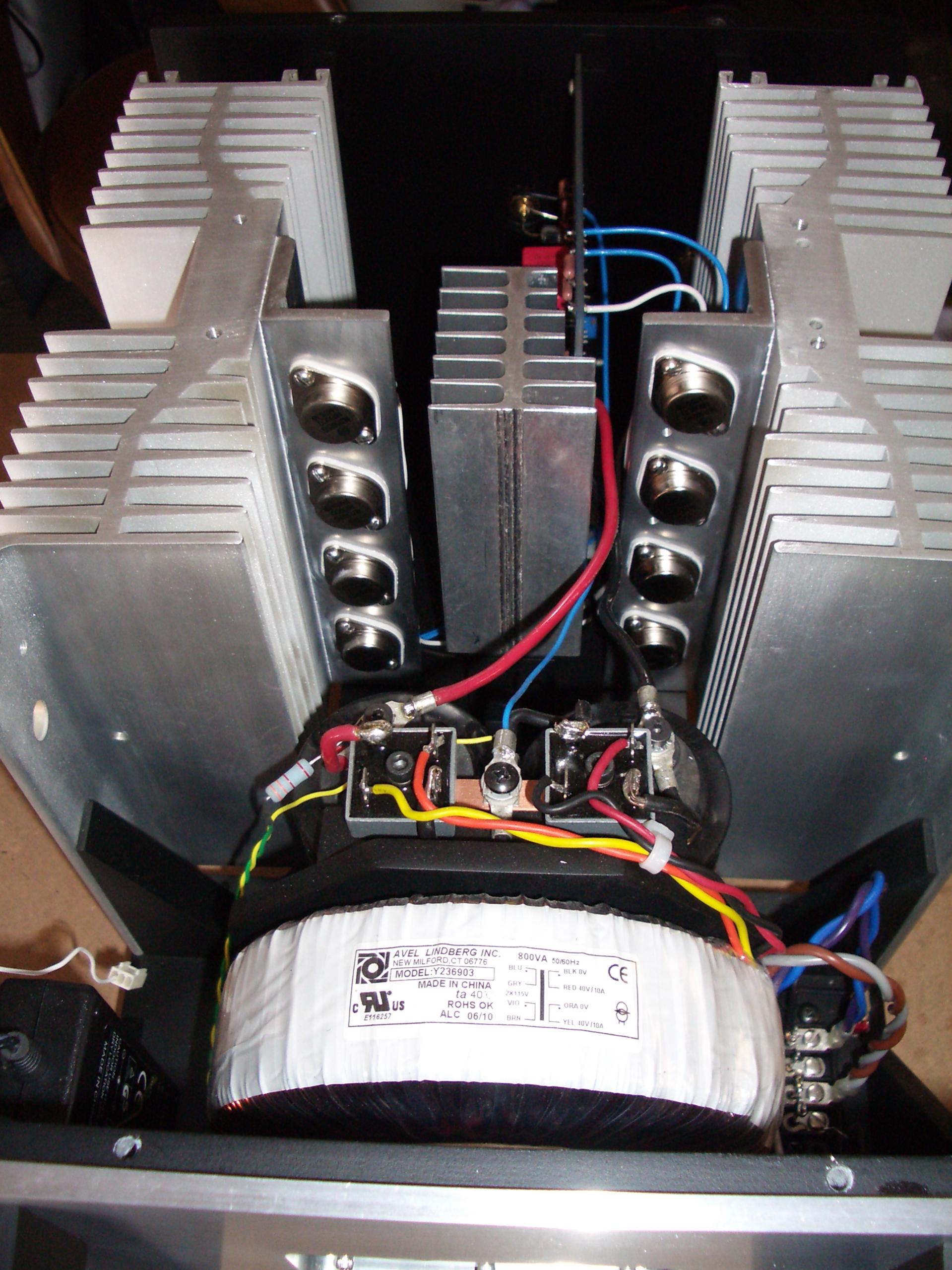

Maybe I was lucky, but with the help by other members on this thread, you know who you are, I have the best amp I have ever owned and when I added a tone control preamp, this amp took me back to the '60s when I listened and felt the robust bass shake the building. I have the KSA-100 with no heat problems. Yes I run 12V fans beneath heatsinks blowing the hot air up and out.
I built the very first KSA-100 Klone prototype way back when this thread started from quick turn boards made by advanced circuits. The first group buy boards were made in Canada because it was quite a bit cheaper at the time. The KSA-100 has always worked just fine, just as fine as the KSA-50 has. It generates a whole lot more heat than a ksa-50 and it has to utilize fans for cooling. Water cooling might be another option and I always wanted to try that. I am still amazed this thread is going and that many of these amplifiers have been built.
Here is the very first driver board that I built. I still have it and the prototype amp although it is in sections now in storage. Some day to be finished...

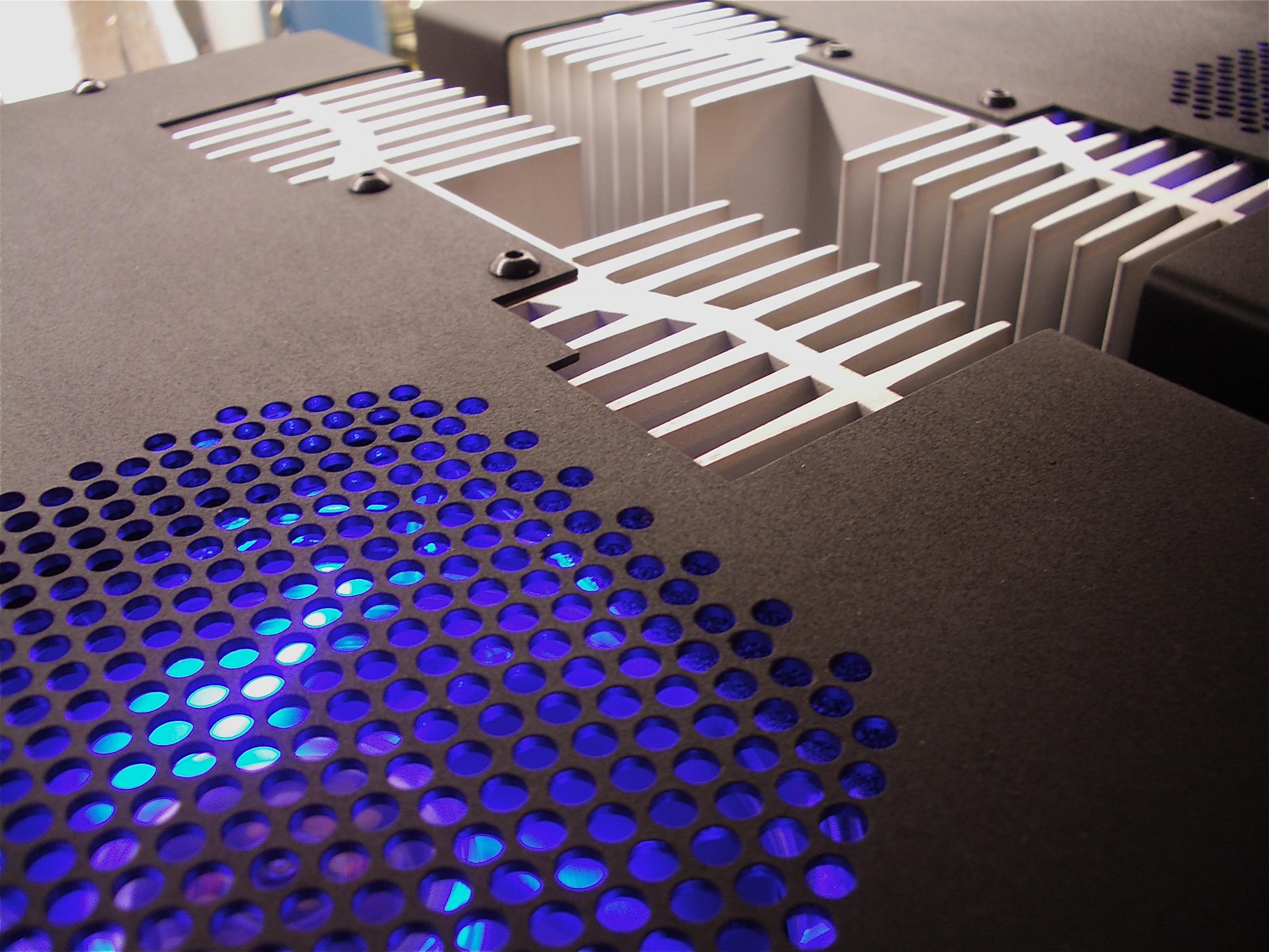

Nice to see that there are still Krells being made! Fantastic amp farl, really love your design! But beware, putting that Krell logo in front of your amp could be dangerous... it resulted into a lot of negative feedback back in the day when I did something similar ;-). Actually mine is in full working order too, lgreen. Still using the Jims Audio boards which, I believe, are most close to the original design. However, after several accusations and renaming the original threat by someone, I have stopped with posting updates. I have made quite some improvements, especially with more efficient use of the heatsinks. It now does not exceed 50 degrees C. Indeed it is one of the best amps around. I am still enjoying it, although not on a daily basis; it consumes A LOT of power haha.

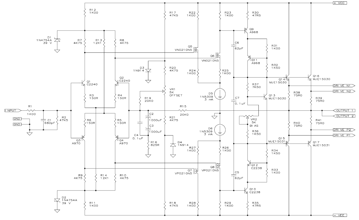

1N5309

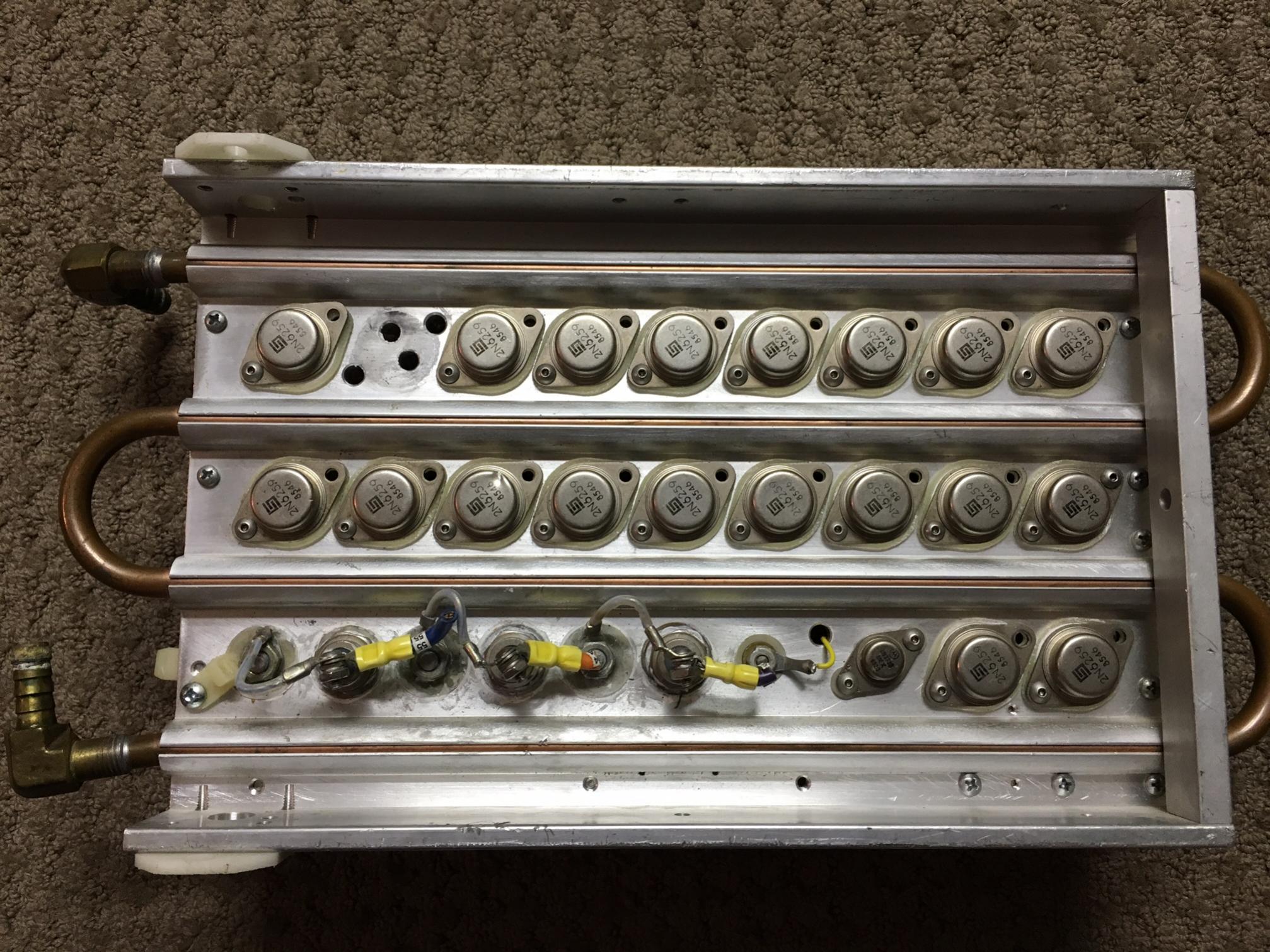

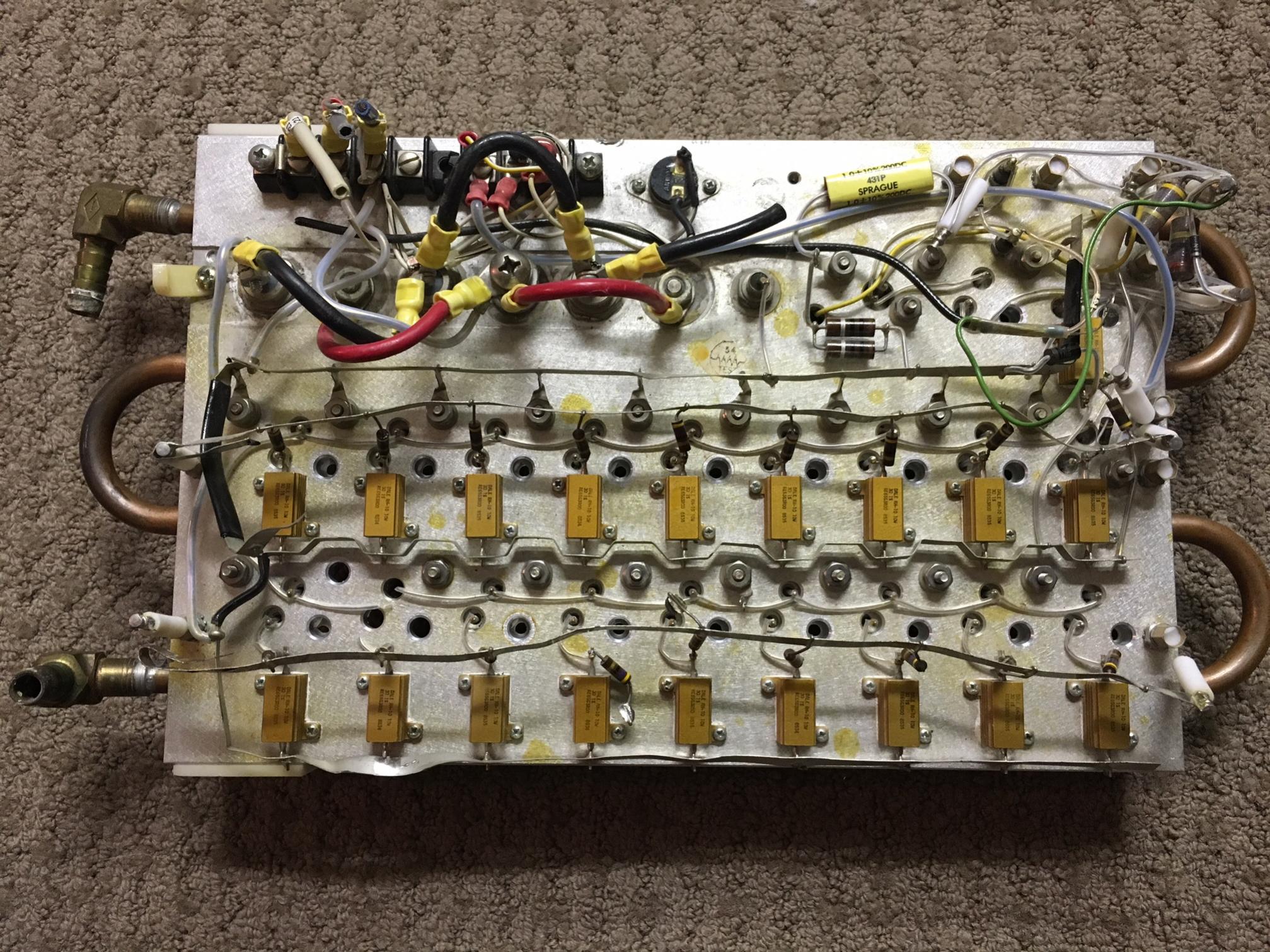

Having just finished a fan cooled KSA50, I'm looking to finish the KSA100MkII...water-cooled.
I just don't want to spend 15 each on these 1N5309 diodes, I think I found replacements. I've managed to get my hands on original 2SJ313/2SK2013, will either of these diodes play nicely with those mosfets? The original schematic is looking for 3mA in this part of the circuit, will slightly under/over cause any issues?
http://www.mouser.com/ProductDetail/Semitec/E-352/?qs=sGAEpiMZZMtQ8nqTKtFS/G7SPLwmKeGy7MokZFFD704=
http://www.mouser.com/ProductDetail/Semitec/E-272/?qs=sGAEpiMZZMtQ8nqTKtFS/G7SPLwmKeGyBuajhQL/tgA=
Welcome back. Please tell us your other improvements.
