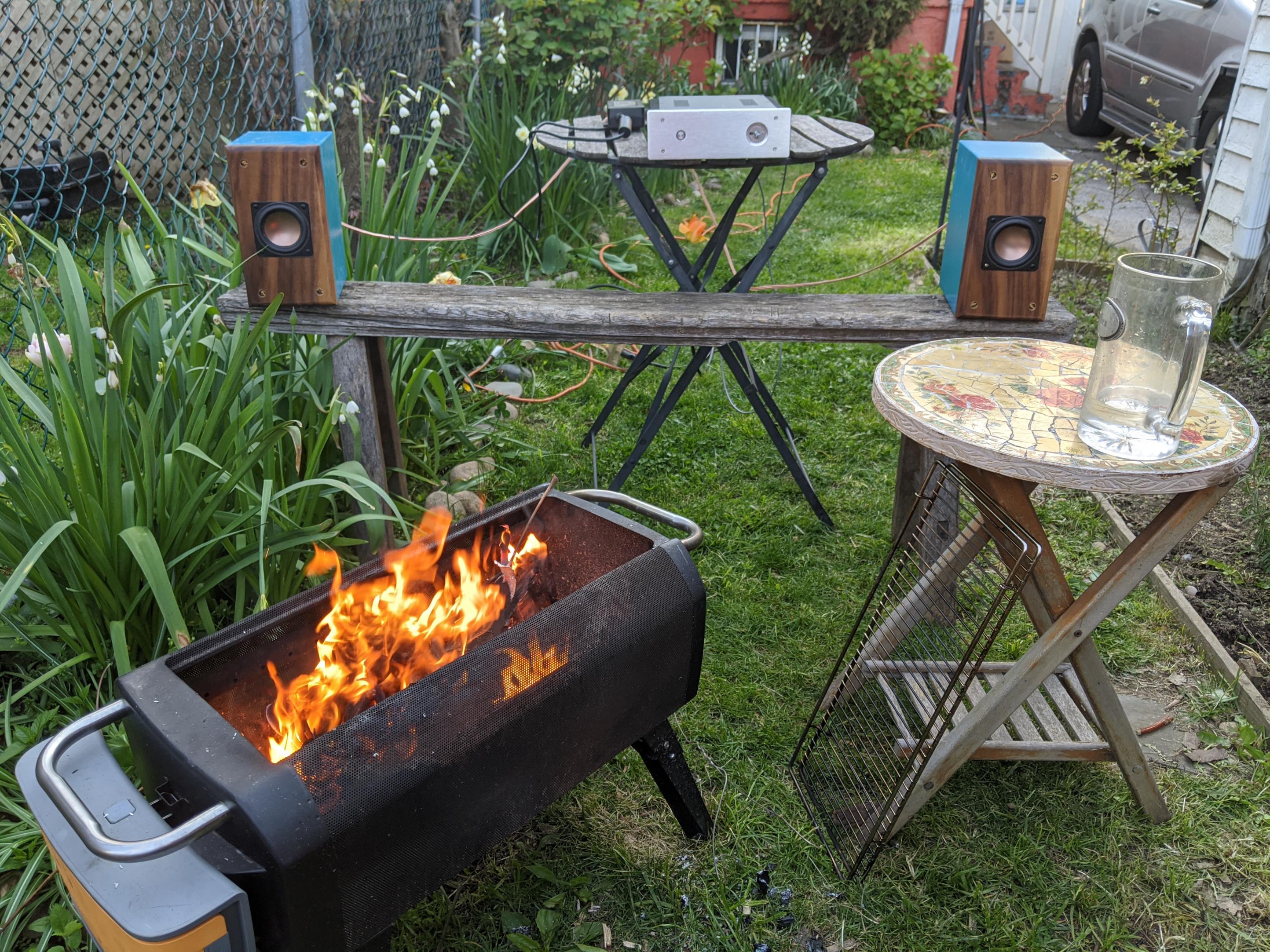

Spending some quality time isolating with my Korg B1/Amp Camp Amp combo and some small full range speakers. Thanks Mike!
