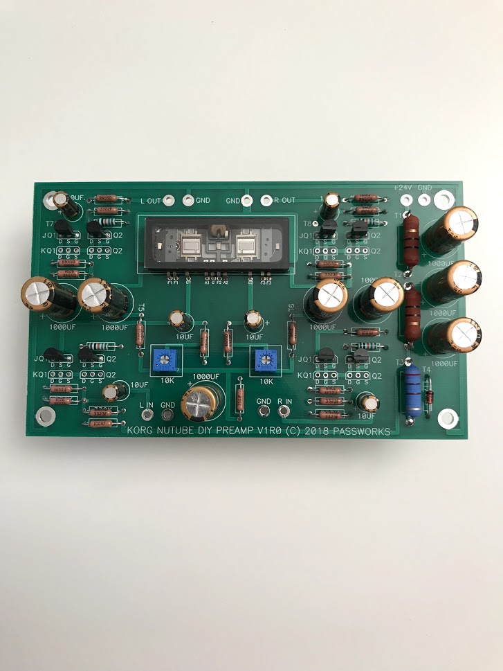

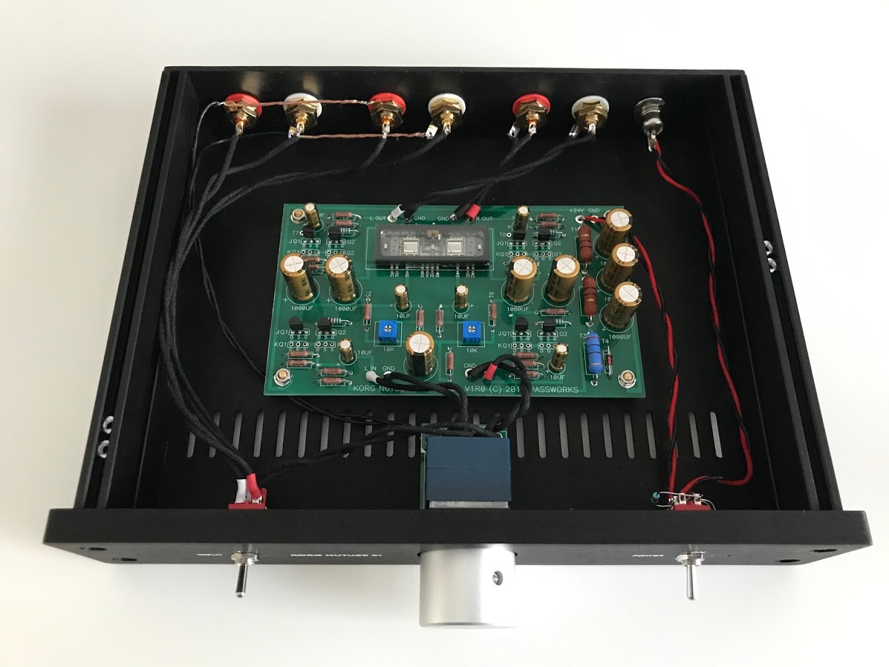

I actually built my B1 with Korg NuTube a few weeks ago and I brought it with me on a recent business trip to the San Francisco Bay Area and reunited with a few audio friends.
Building the Kit
I first populated the PCB as instructed by Nelson Pass. Since the bags of parts were not labeled, it took me a while to identify everything including measuring the nice Vishay-Dale RN55 resistors and the larger power supply filter resistors.
Next, I soldered the volume pot, the source input switch, power supply connector, power switch, LED, resistor and then RCA connectors. After that, I assembled the chassis and installed the RCA connectors. I soldered the signal input wiring and DC power wiring afterward. For my build, I used Duelund DCA20GA Cotton-insulated, Silver-plated Copper wire for the signal hook-ups, and Kimber Kable TCSS Teflon-insulated AWG 19 stranded Copper wire for the DC power connections.
Thanks to Jim for advising me to tie the respective Left and Right channel input grounds together before I wired up the connections.
I plugged in the power supply and went through the test measurements and adjusted the bias pots as instructed. I ended setting up the voltages at T7 and T8 at 10.0 VDC. Unfortunately, I do not have a distortion analyzer, but relied on what I liked best.
Everything worked like a charm. Jim's photos were very helpful in insuring that my soldered wire connections were correct.

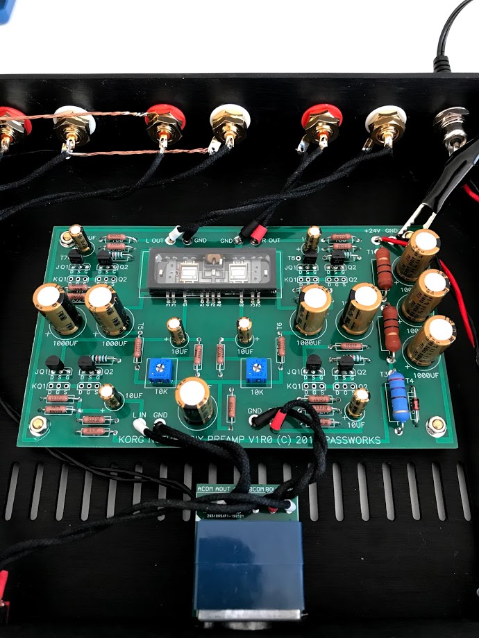

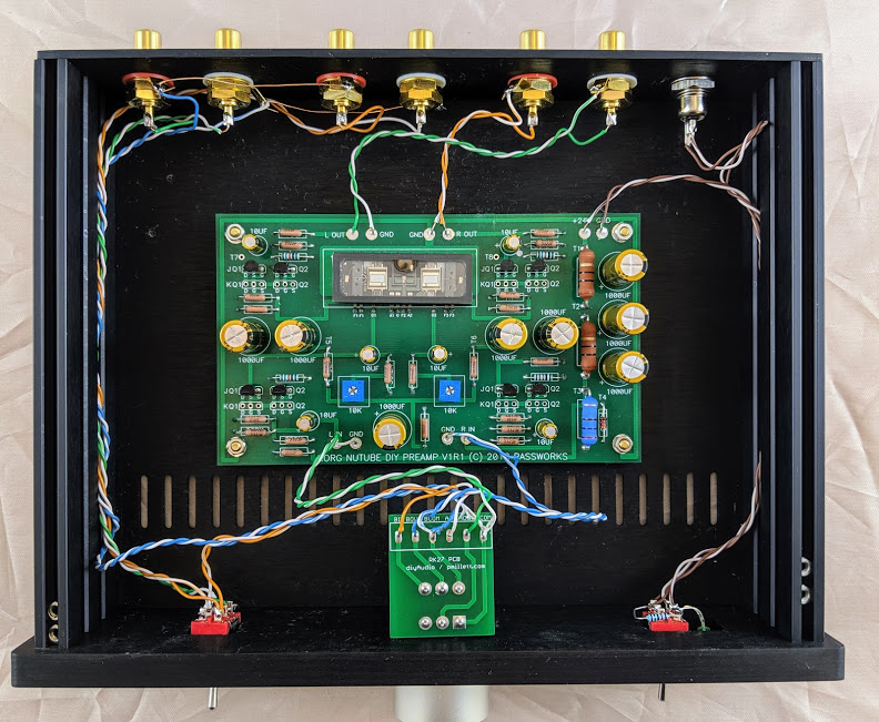

Hi everyone,
This is my first post here -- I feel that being a lucky possessor of one of the kits from the “pioneer” batch I owe some feedback to the community, although I don’t have that much to add -- my experience happened to be pretty smooth and consistent with what has already been mentioned, especially in the wonderful write-up by pfarrell.
TL/DR -- everything was straightforward and the amp works well. Long version, some pics and measurements below.
I’ve done a few builds before (ACA, Starving Student and a couple of other small projects), but that’s about all experience with audio electronics that I’ve ever had.
First of all, thanks a lot to Nelson, Jason, 6L6 and everyone else who made this kit possible -- building it and listening to the preamp coupled with ACA was nothing but a pure joy.

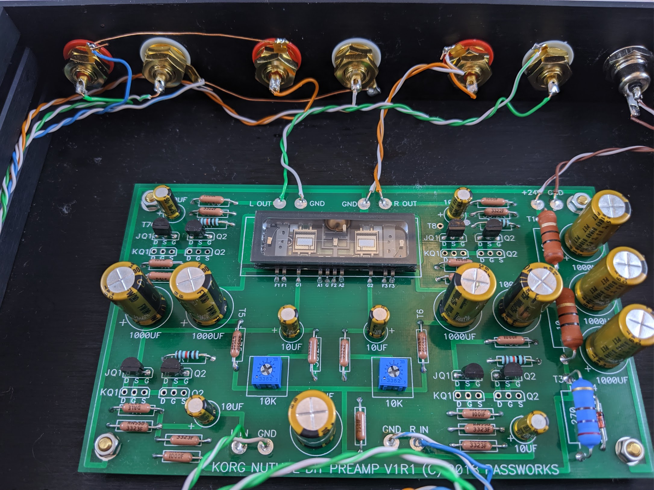

I’ve only read Nelson’s original article before proceeding to stuff and solder the PCB and that proved to be enough. I’ve also used the schematics printout that came with the kit to cross-check, and that brought a bit of surprise, as it is apparently “v0” of the circuit and shows the resistor values in the output voltage divider that are different from the ones on the silkscreen (and the actual parts in the kit). I’ve also had to search a bit for the zener diode (packaged separately) and was momentarily puzzled by the number of JFET footprints on the PCB being twice the number of JFETs, so I had to come back to the article and read about which ones to use.

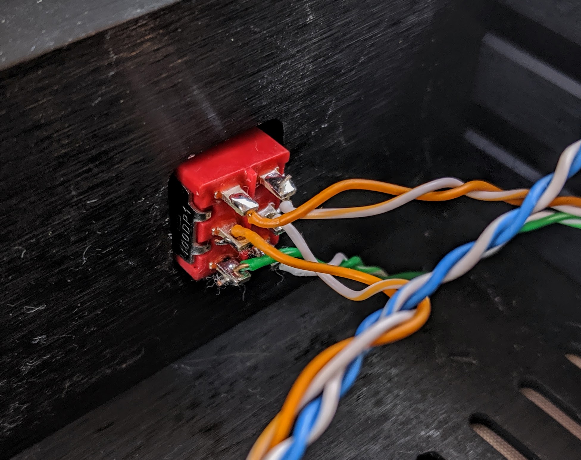

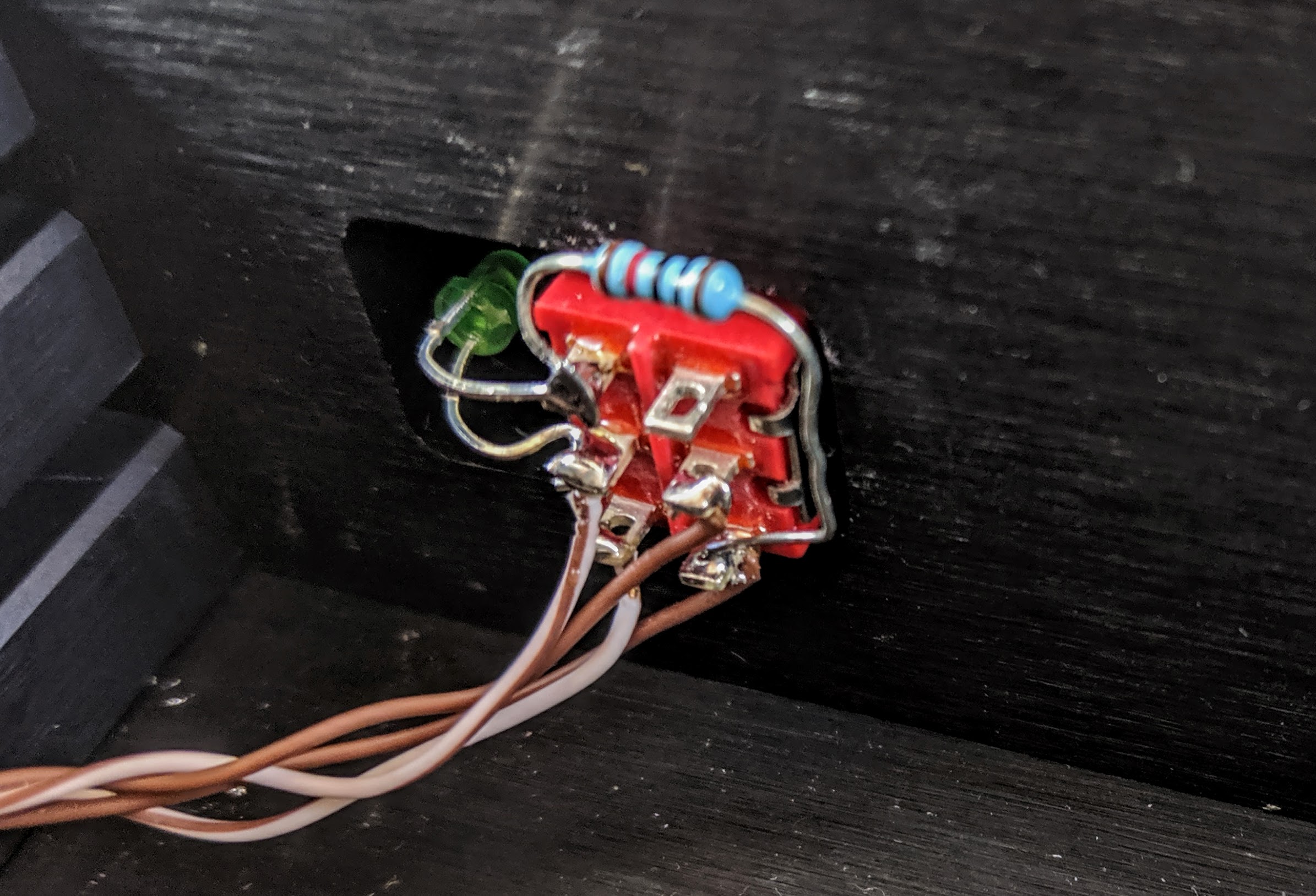

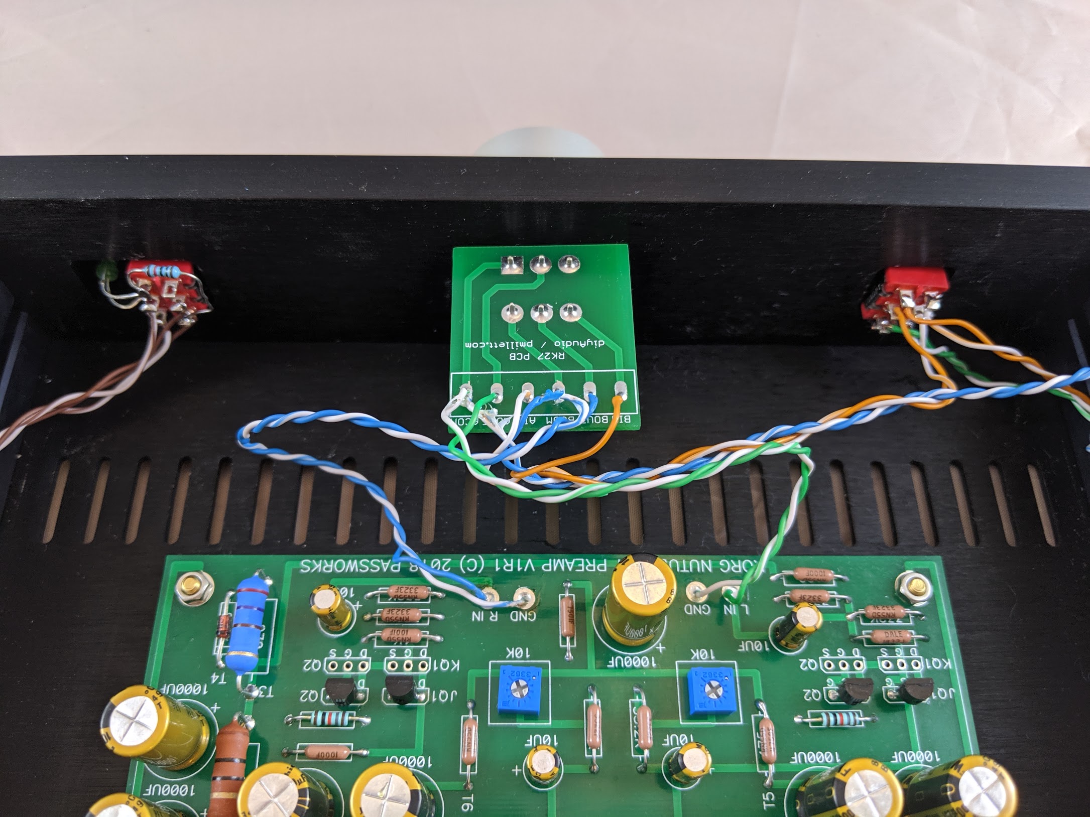

Building the chassis was also a no-brainer, but when it came to wiring, I felt like I needed some guidance -- there aren’t too many ways to wire the power or signal, but I wanted to make sure the ground topology is sensible, so I had to dig through the thread a bit before I found photos of the build by 6L6. Having an example of how to mount LED on the power switch was also very helpful!
Here are some notes on switches and wiring that basically describe what I’ve seen there -- for those who prefer written instructions:
  • Remember that these DPDT switches connect the middle pair of the contacts to the pair opposite to the position of the toggle (so if the toggle is “UP”, it’s the bottom pair of contacts will be connected).
  • You want the incoming pair of wires from the power socket to go to the bottom contacts of the switch; the below also presumes ‘+’ is wired to the (outer) side where LED is and ‘-’ is on the (inner) side closer to the volume control.
  • Bend the leads of the LED at right angle so that the distance from the lens of the LED to the bend matches the depth of the switch body. Observe the direction of the bend, the anode (longer lead) should be at the middle switch contact when mounted, and the cathode should be at the top (presuming the polarity mentioned above). Solder LED to approximately match the distance from switch to the LED hole, the cut the leads.
  • At the input terminals, connect the ground tips of ground rings of both LEFT posts using a stripped wire, then connect the tips of both ground rings of RIGHT posts. It helps if the tips of left posts are facing down while the right posts are facing up (or vice-versa).
  • Use one twisted pair to connect left and right of first channel to the bottom terminals of the switch, another one to connect the second channel to the top pair of the switch. Color coding is your friend, I keep all LEFT wires white.
  • Use third pair to route the ground directly to the COMMON pad of the volume pot’s breakout PCB, but do not solder yet, as you’ll want the ground from pot to the input on the PCB to be mounted there as well.
  • Route another pair from the middle terminals of the channel selector switch to the input pads of the volume pot PCB, and finally route two pairs from out and common to left and right on the amp PCB.
Here are some pics of my build, although they’re nowhere as neat as others.
IMG_20190926_205710.jpg IMG_20190926_205735.jpg IMG_20190926_205835_1.jpg IMG_20190926_205846.jpg IMG_20190926_205856.jpg

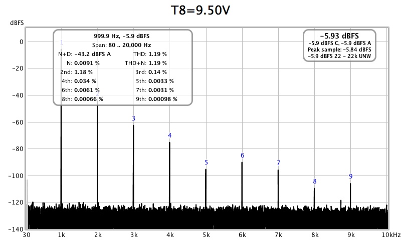

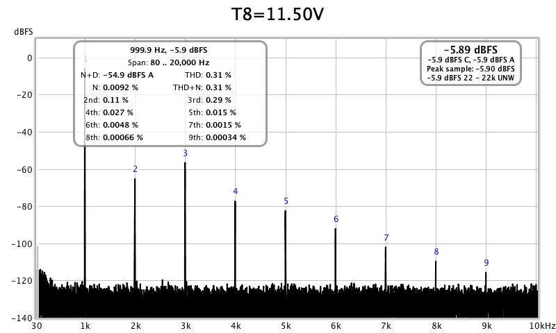

I’ve also done some distortion measurements while playing with the bias (after all, wasn’t that the entire point of the project?), using RAW + Focusrite Scarlett 2i2 + Pete Millet ATEST interface. Here are a couple of graphs and a summary for all the voltages that I tried, all for one channel (I found that there is around 0.2% discrepancy between THD values of two channels at one specific bias voltage when I tried measuring second channel). All measurements are done at 1V RMS output, 1KHz.
Code:
[FONT="Courier New"]
T8 Voltage   % 2nd   % 3rd  % THD
 9.50        1.18    0.14   1.19
10.00        0.92    0.08   0.93
10.50        0.72    0.10   0.73
11.00        0.40    0.19   0.44
11.50        0.11    0.29   0.31
12.00        0.68    0.28   0.74
12.50        1.20    0.18   1.21[/FONT]

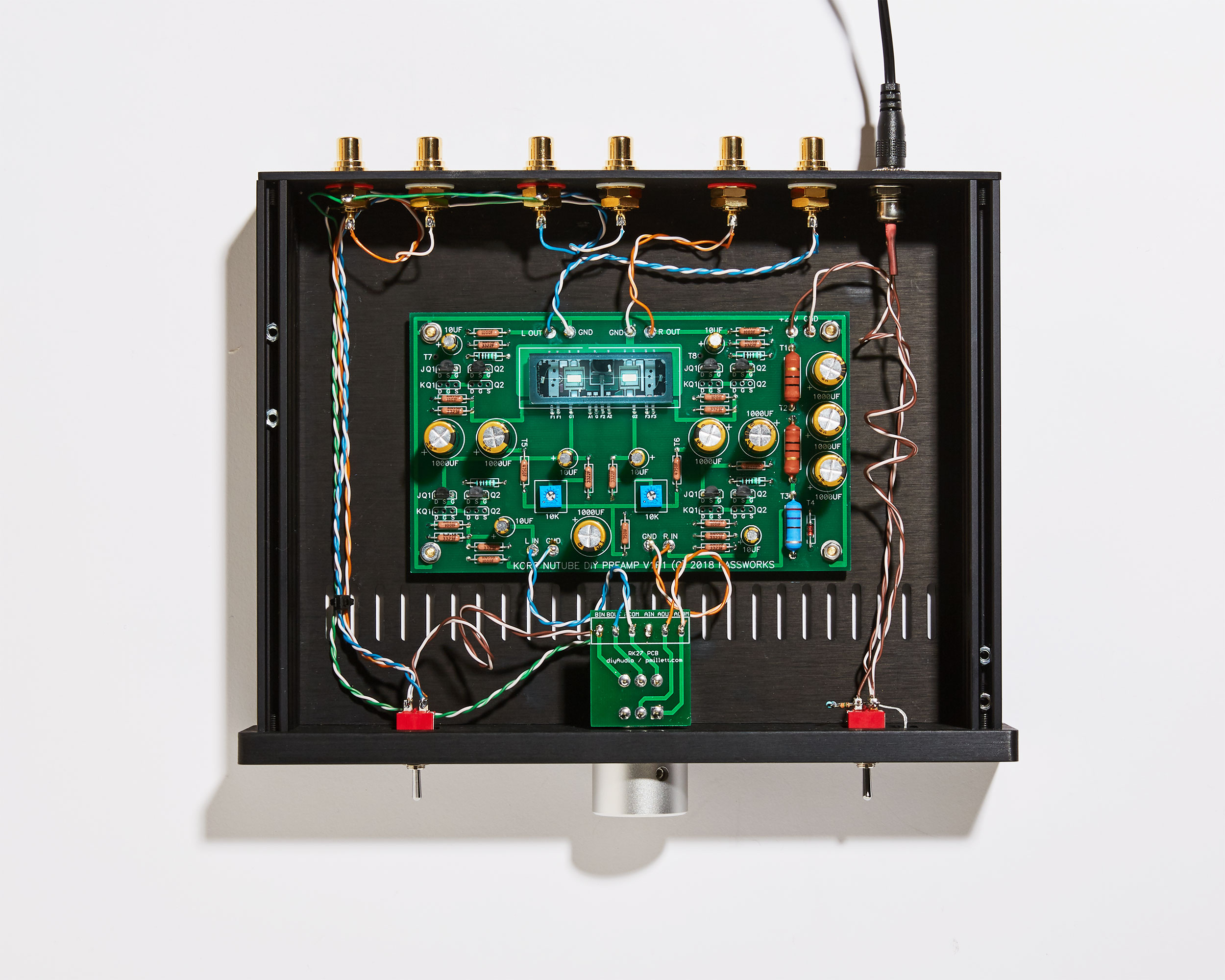

I noticed the pictures show a screw terminator block on the volume daughter board:
Daughter board
There isn't one in my kit, and the first few photos of all the parts don't show one, either.
I don't mind the point to point, but I spent a few minutes rummaging through my packaging to make sure it wasn't missing.
Using these images:
Photo 1Photo 2
I cannot tell if the middle or the bottom twisted pair goes to the power connector. My guess is middle? Or maybe it doesn't actually matter?
Using these images:
Photo 1Photo 2
Middle connectors go to the power. YES it matters! The center is the common, top and bottom leads are switched. Up on the switch connects the bottom, down on the switch connects the top. (I just learned all of this as well—Look up a wiring diagram of a DPDT switch, it will add clarity.) Way FUN!!

I suspect that 6L6 was presenting some options (don't think the kit includes the blocks—mine didn't...but maybe the "official" kits will?
That was the point of the photo - the blocks fit. Use them if you want.
So when the switch is on the OFF position, the top connectors will actually be powered? I don't think you want this, I'd rather make the bottom connectors go to the socket power and the middle pair go the board, so that in the off position the top pair is actually off.
