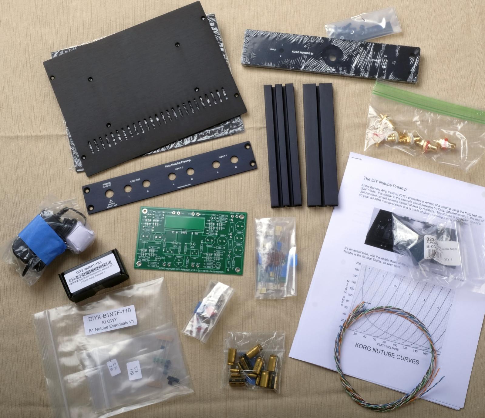

This is the chassis we have used for the Korg B1 project 🙂
Galaxy GX247 230 x 170 x 40 mm 10mm BLACK front panel

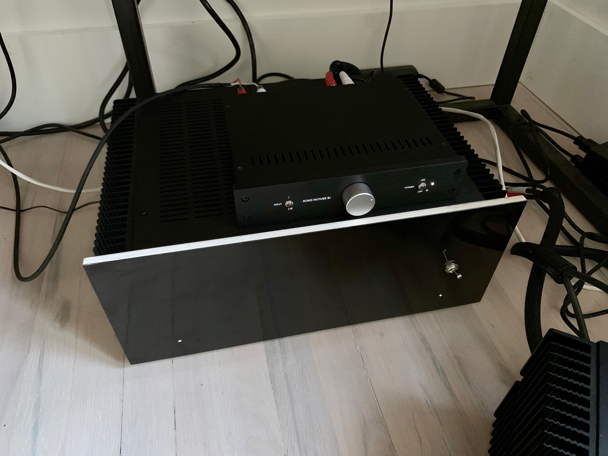

Only source was non-DAC'd (well, internal Mac stuff) iTunes. Smallish room, 88db speakers.
Was really fascinating. It REALLY depended on what I was playing. Overall I preferred the F5 with BK1. Depending on what I was listening too I couldn't tell if I was hearing microphony or bad recording or both—as soon as I'd felt that I'd figured it out—I'd switch musical genres and things would sound 100% epic—classical, Jazz, vocals, rock. "Quality" really seemed to depend on recordings or type of music and live vs studio (it all sounded great, I'm trying to be picky). I suspect that once I plug this into my main setup with sensitive speakers in a much bigger room I'd better be prepared to sit down for awhile. It's a whole new world. I too found that inverting the speaker signals made a massive difference with B1K in the chain. I's say the dual ACAs are totally amazing for what they are—but they are not nearly as nuanced as the F5 and seemed range bound. BK1 is adding something to both of them however. And it's good for me. I do want to try/build a preamp that's not described as having "color"... so I can understand that. I am getting a slightly bigger volume range out of 2x ACAs + B1K than F5 + B1K, or put it this way, if I don't touch the volume on the B1K and switch between the 2x ACA and F5 the F5 is quieter... Just something I observed that surprised whatever it is I thought I knew.

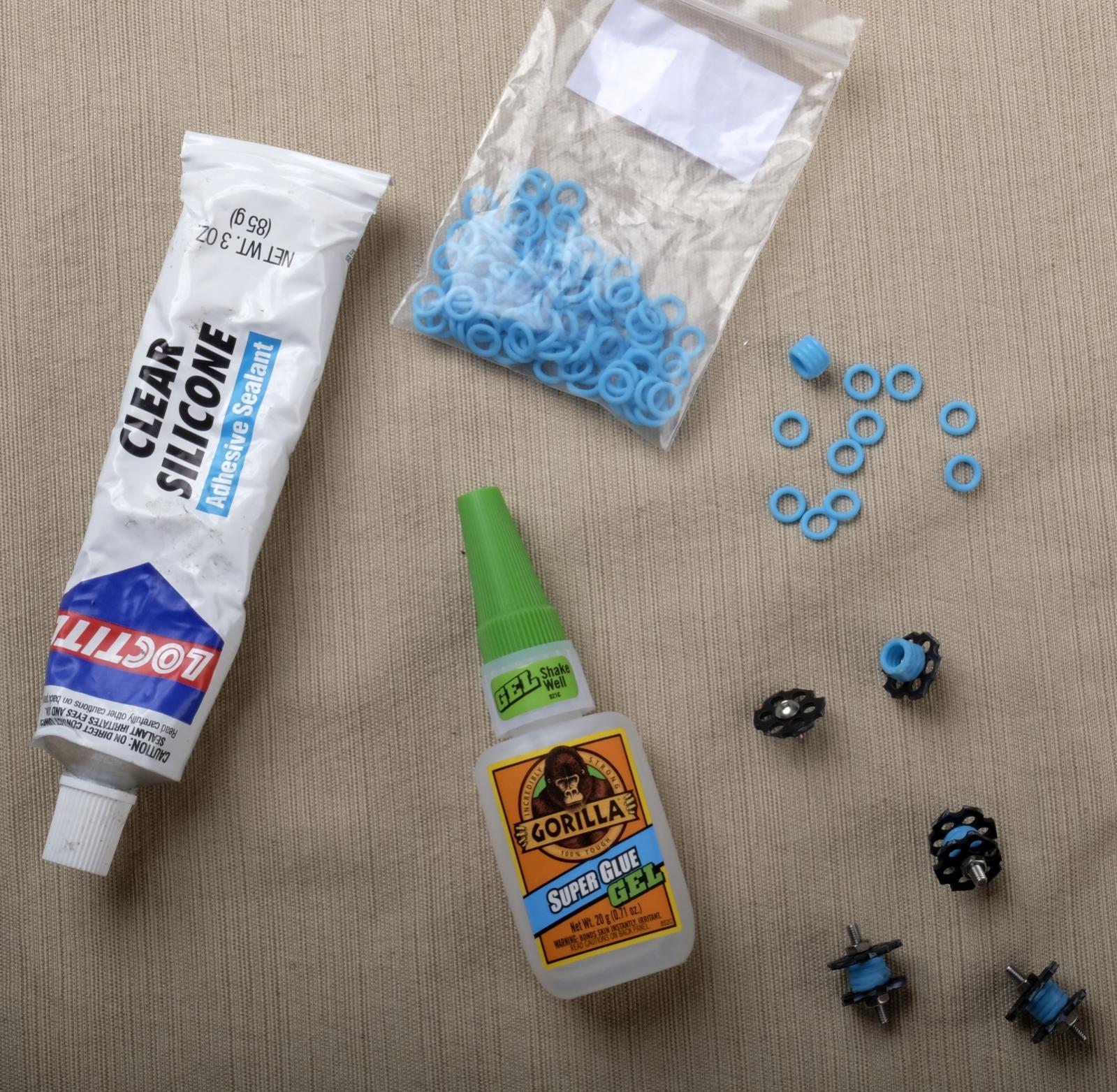

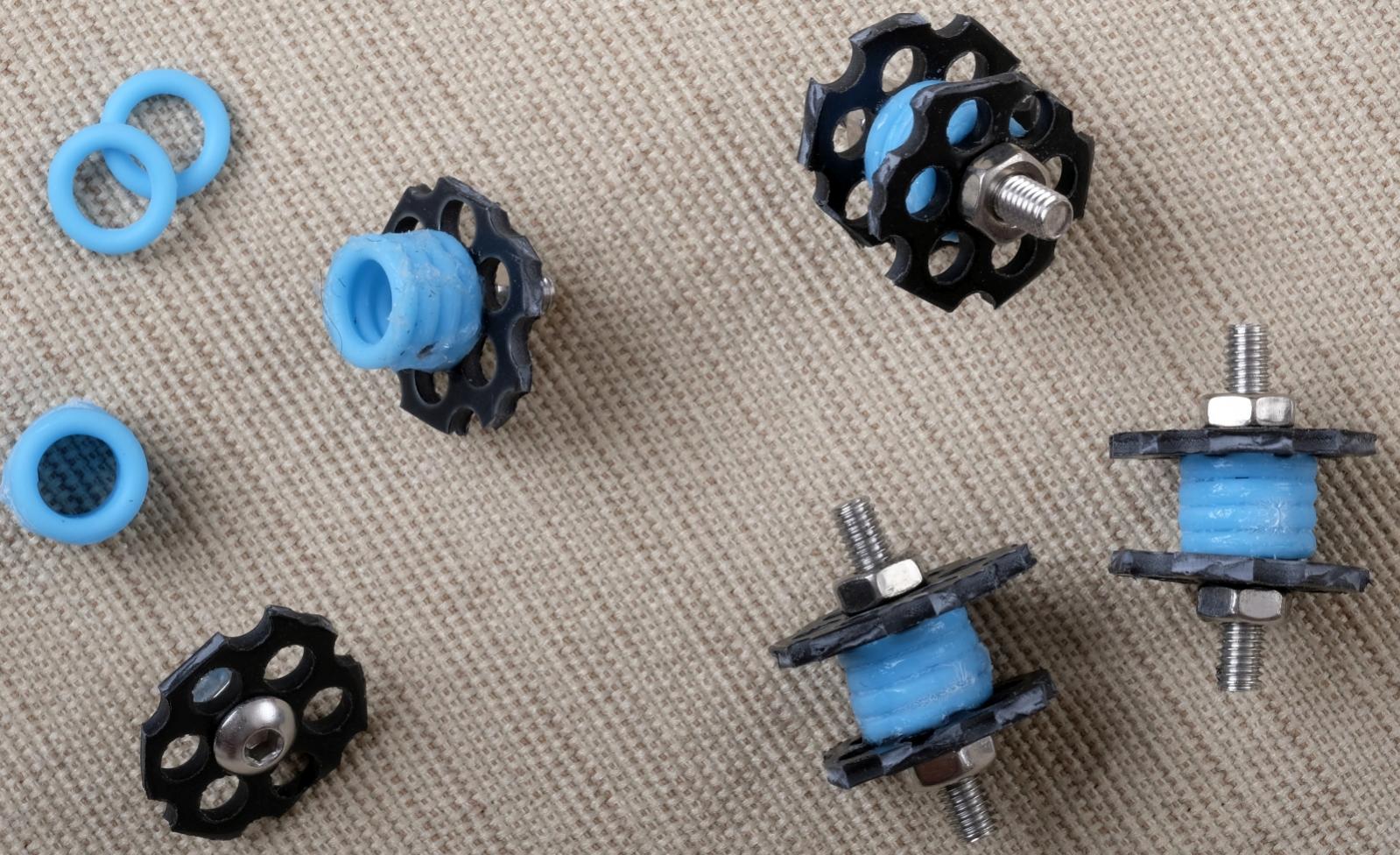

Rather than buy a commercial isolator, with the spirit of DIY here is my take on some homemade isolators. Please note the attempt at Pass blue. These are silicon dampers used in keyboards. A few cents apiece. The grids they are mounted on is some plastic screen I had on hand. Some 3mm screws and a stack of four dampers with the circuit board in place along with the tallest component will fit. Hopefully this will help some on vibrations. The two adhesives I found that would work with the dampers I bought are shown in one of the photos.
More to follow.
