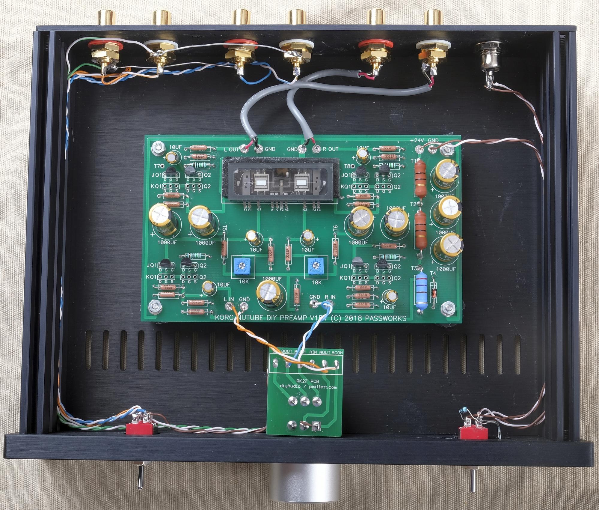

Well all's well now. I have a Hakko powered solder sucker. Removed all active components and then resoldered them.
Two possibilities, most likely my soldering skills, another could be one or more holes didn't plate through to the other side.
I know someone mentioned the fact the solder pads are very small, perhaps a bit larger in the final store boards.

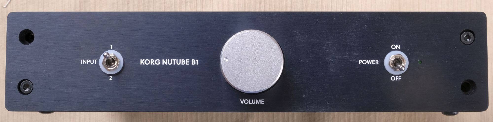

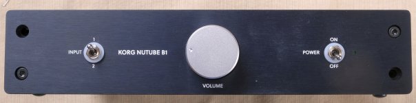

This is just me, the knob is large enough to obscure the word "volume", depending on the surface the B1K is sitting. Suggest have the "volume" printed above the knob.
I added flat nylon washers under the switch nuts to protect the front plate when tightening them, as I am sometimes clumsy. Could be a nice addition for the kits.

I like the idea of the nylon washers. If I can find them in black I'll absolutely consider it.
Being that it's the only knob and a preamp, I bet everybody will already know it's the volume knob. :yes: The label in general is superfluous.

I agree with the "Volume" printed above the knob. Great call.

Some suggestions on wire length will be helpful to the novice.
My kit didn't come with the screw terminals shown on the volume control board, but I think I have some of them around somewhere and they seem like a good idea so I'm going to go look.
I'm sure I'll have more remarks/issues. (I'm intimidated by the led power indicator positioning, but will probably tackle it soon.)

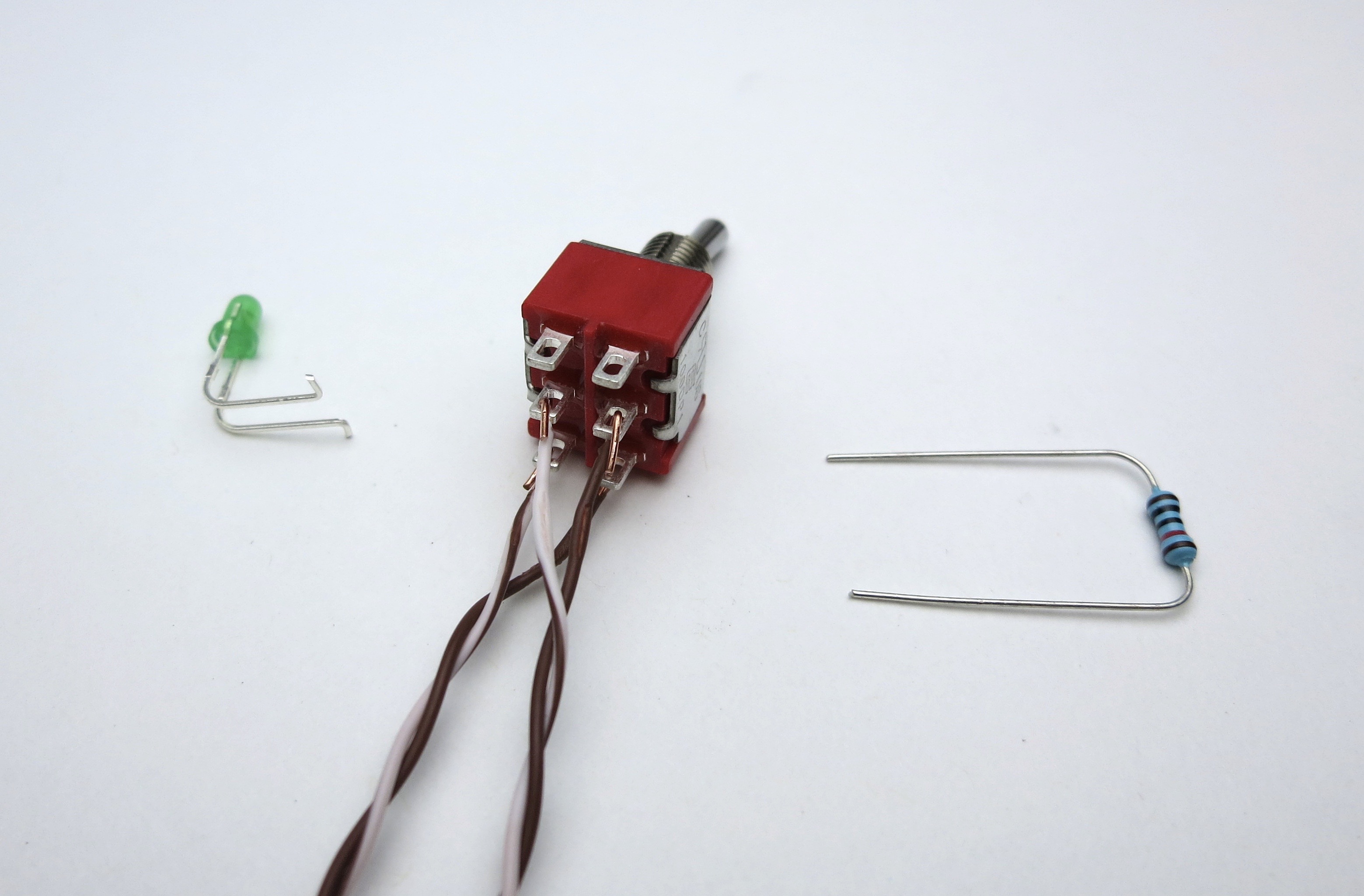

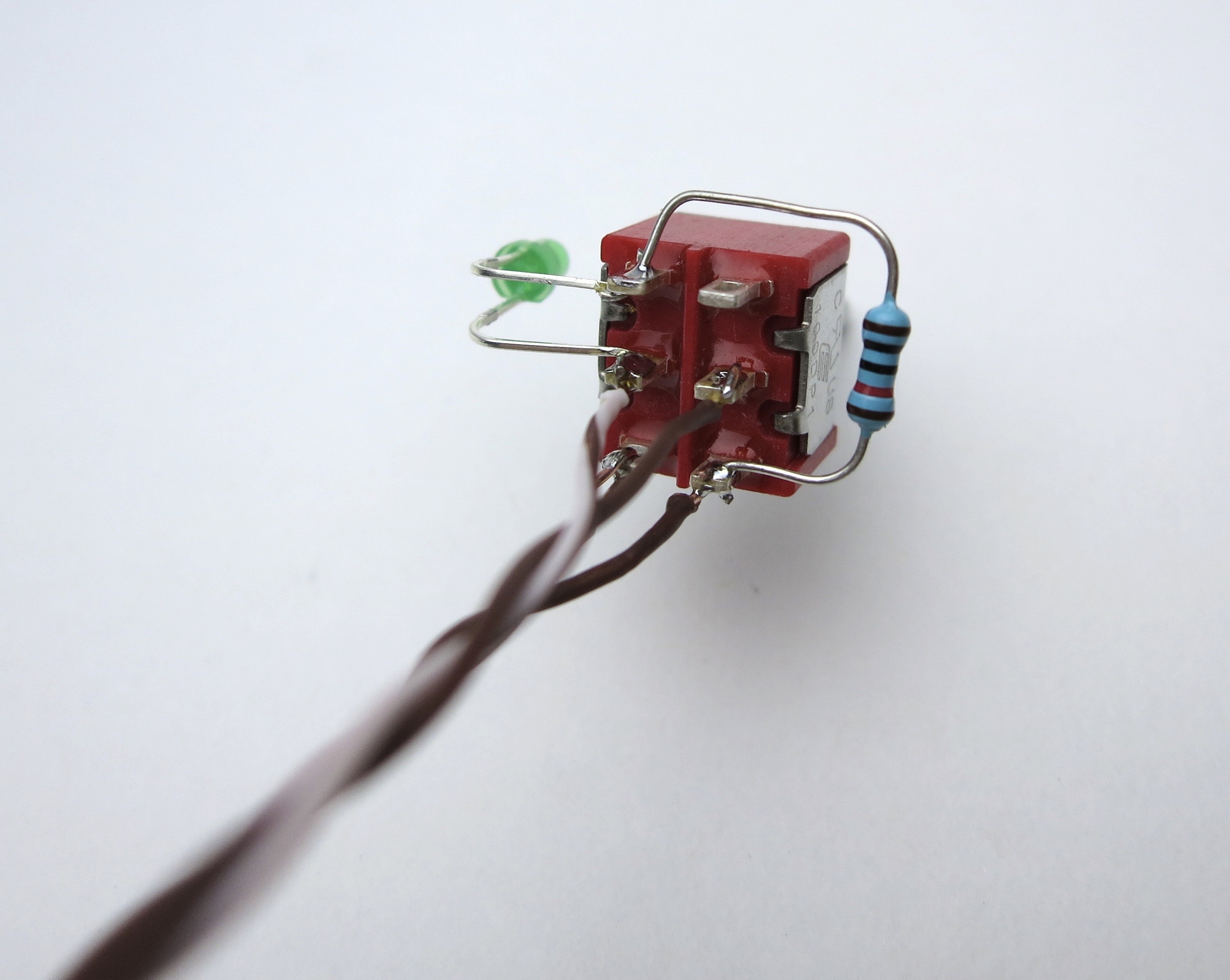

I know I'm an amateur, but isn't there a more precise way to mount the power led? There must be some kind of grommet or holder it could go in. I'm just working on guesswork about where to make the bends and cuts. (And I'm hoping I guessed right about the polarity from the hints in the photo gallery).
Oh well, here goes!
The kit didn't include screw terminals, that was simply showing you could add them. LED is easy solder it as shown, you can simply bend the leads to point it at the hole in the case.
This I agree with, someone pointed out how small the holes and unless you are inline you really don't see the glow from the LED. This person enlarged the hole to 3mm I believe.
I think enlarging that hole for the production run would be nice.
Thanks for the encouragement. I think it went okay, but it will be helpful for the instructions to give some measurement guidance about where to bend and cut the led, and to make clear which side the longer lead goes to.
I found my screw terminals, and even learned that the two-terminal ones can be slid together to make a 6-pack! I like this because I may change to different pot/attenuator in the future.
I've got the board stuffed, so I'm moving along!
Long lead on top (anode), diode flat (cathode) on the bottom. See photos. (they are large, click into the expand icon in the photo for high resolution.)

My biggest hiccup was related to the screw terminals I added to the Alps board. I saw them in 6L6’s photo guide, but I didn’t look carefully and notice which side of the board to put them on! So after I got it all done and working, and got the test voltages dialed in, I had to desolder the board and do it again. It reminds me of my usual experience with assembly of IKEA furniture - I always have to partially disassemble it and do it again! I guess I pay better attention to worded instructions than pictorial ones.
This is my first Pass/DIYAudio kit, so I might not be getting the intended level of expertise right, but as I noted above, a novice would benefit from explicit recommendations about wire lengths, order of washers and nuts on the hardware, as well as some of the tips about stuffing the board from NP’s guide. ( It might be too elementary, but I seem to recall old Dynaco or Heathkit kits specifically indicated the length of wires and even how long the stripped part should be.)

Given up on the Khozomo board and wired it all up to just one of the four inputs I planned until a elma rotary switch turns up.
Only problems I had with the kit itself are of a newbie nature with the numbers printed on the resistors not matching those on the board. ie 1001 not 100K 3323 not 33.2k that sort thing needs some explanation in the documentation when it goes out. Measuring them using my multimeter didn't shed much light on some of the values - too small for some meters?
I soldered the Korg to solid core cable suspending it on springs if you like but it's still pretty microphonic like that. I did it because I wanted to see it glowing that's at least part of the appeal of valves I'll work on that.
