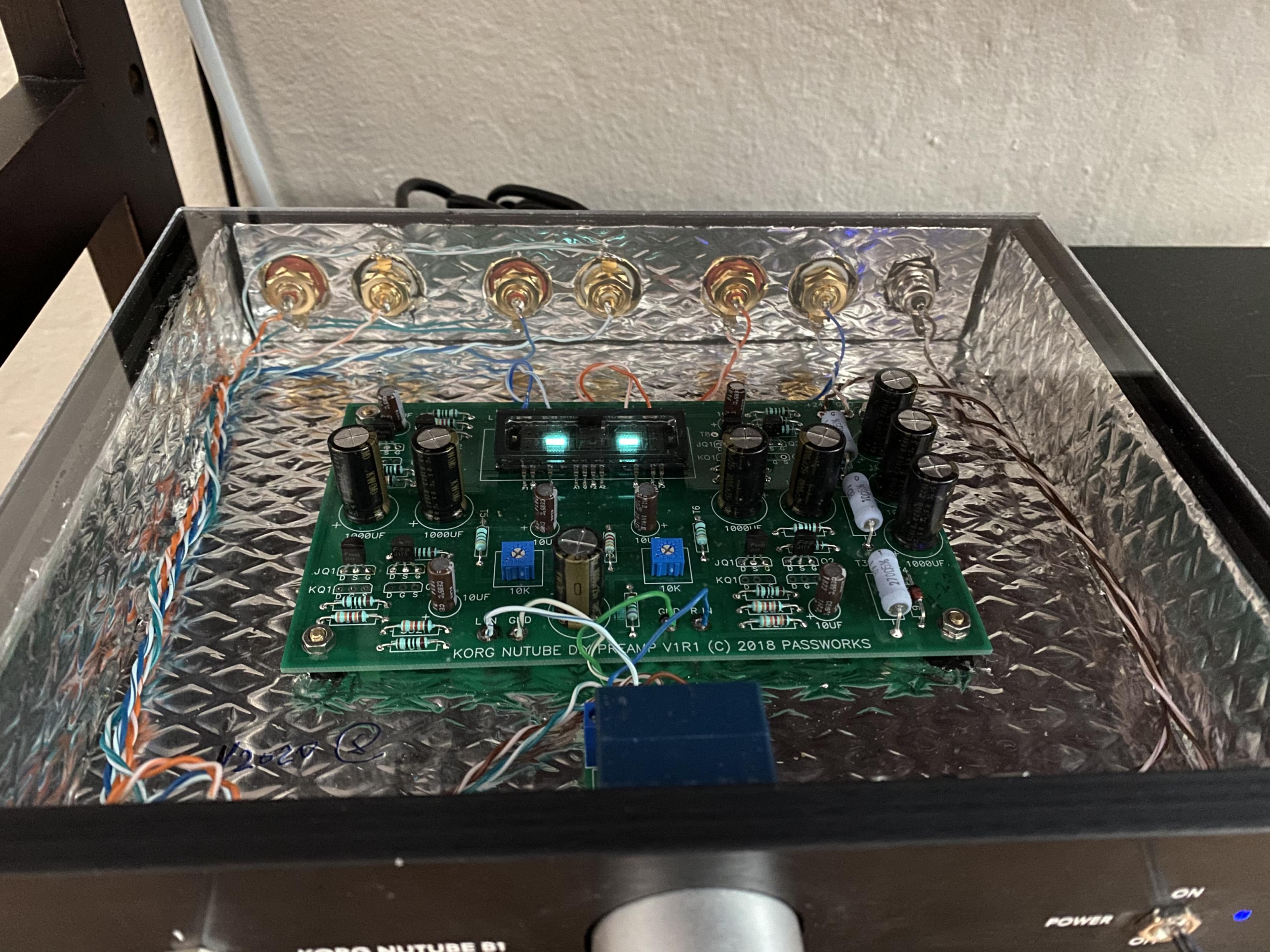

To deal with the microphonic ringing here is my final solution - I tried many others with little to no affect. I lined the chassis box with Noico 80 mil Butyl Automotive Sound Deadening mat from Amazon, closing the top and bottom vents, and 1" Platinum Silicone Hemisphere Isolation Feet. That fixed the ringing and made the box solid with no microphonics. I wanted to see the tube so I sourced a piece of 1/8" acrylic plastic and replaced the top of the box. It's more dense than the original metal piece. No ringing.
I've build two boards and sourced the parts from DigiKey. They both sound fantastic and both have very different microphonic characteristics.
I enjoy the clean, clear sound of the this preamp over many high priced preamps.

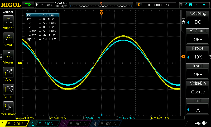

I had problem with left channel going out. It worked fine for a while but then started having issues so I reflowed the left side of the board and everything started working fine again. As I was probing around looking for things before and after, I realized channel matching is pretty far off. Any suggestions on how I might improve this? See attached picture. Note that YES, I did try swapping scope probes between channels as well as test signal source but the results indicate the left channel (blue trace) is lower in output then right (yellow trace). Also confirmed this with Fluke 87V. Also note that DC offset is very very close to zero and matches almost perfect between channels. The voltage difference between L and R output increases as a function of input voltage.
Any ideas on where to start looking?
