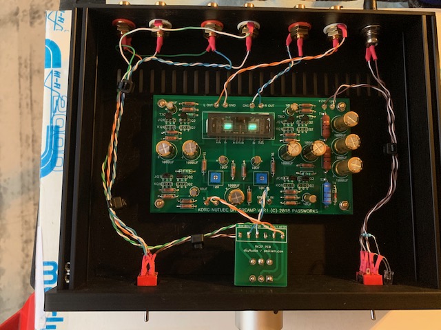

I've finished my build, sort of. A few more notes:
1) the voltages for my build are, T1-T8, respectively: 24.43, 23.64, 22.85, 9.36, 0.67, 0.67, 14.46, 13.62. These last two were set to 9.5 as per NP's notes/build instructions.
2) it can be seen in the attached photo that the tube lights up nicely, but not the power LED. I must have wired that incorrectly. I also changed it from green to blue! I rechecked the wiring but I don't seen anything wrong. I guess I'll need to pull it apart. Suggestions?
3) After checking the voltages I checked the operation and, whoa!!!, is that NuTube microphonic!!! When testers wrote that they could clap their hands across the room and hear it out of their speakers I thought "not possible." Running my MacBook into a Dragonfly and then into the BK1 and then into ACA1.7 monos (I thought this would be a good combination since the builds are of comparable difficulty) and then into Zu dirty weekend mk 2 (97db, 12 ohm) I can hear the high-pitch ringing of the NuTube !LOUD! and clear. I have mounted the NuTube with the supplied adhesive pads and the pre is sitting on the supplied feet without any modifications.
4) I have some Vibrapod feet in a box I will try. After that I'm not sure. The ringing is WAY TOO MUCH 😡 at this point to actually use the preamp - turning up the volume is all but impossible - so I'll need to come up with something.

Try replacing the top and bottom of the box with something less inclined to ring. Big lump of MDF (very sound deadening) or Acrylic. The vent holes in the case aren't required it's not going to get hot and the front back and sides should conduct any heat to the outside.
What about dynomat or the like to help deaden the chassis?

I had a severe microphonics problem on my unit. I could clap my hands 7-8 foot away from the unit and hear the NuTube ring. I tried mounting the unit on large but cheap rubber feet. I also tried closing the vents in the top and bottom panels with multiple layers of thick duct tape with little improvement..
The cure I found is to buy a quantity of Sorbothane 1/8" inner diameter, 1/2" outer diameter thick washers from Amazon. The brand name is Isolate It! and they are sold in packs of 12 units. I bought two packs and mounted them on 1 inch #6 nylon screws and hardware. I put a washer between the screw and the bottom plate of the chassis, stacked four more washers on top, set the PC board down on top of the stacks, put another washer on top of the PC board and then screwed the nylon nut down loosely on top. This eliminated any airborne excitation of the NuTube that I can hear. It only rings now when I work the selector switch.
One problem is that the PC Board makes its chassis ground connection through the metal standoffs used it the kit. I kept one standoff in place to hold a ground lug to which I soldered a ground wire up to the PC board ground. I stacked two sorbothane washers on top of the standoff, but I don't think they contact the board. It sits quite well on the three nylon screws.
I am really enjoying the sound of my NuTube B1 now.
