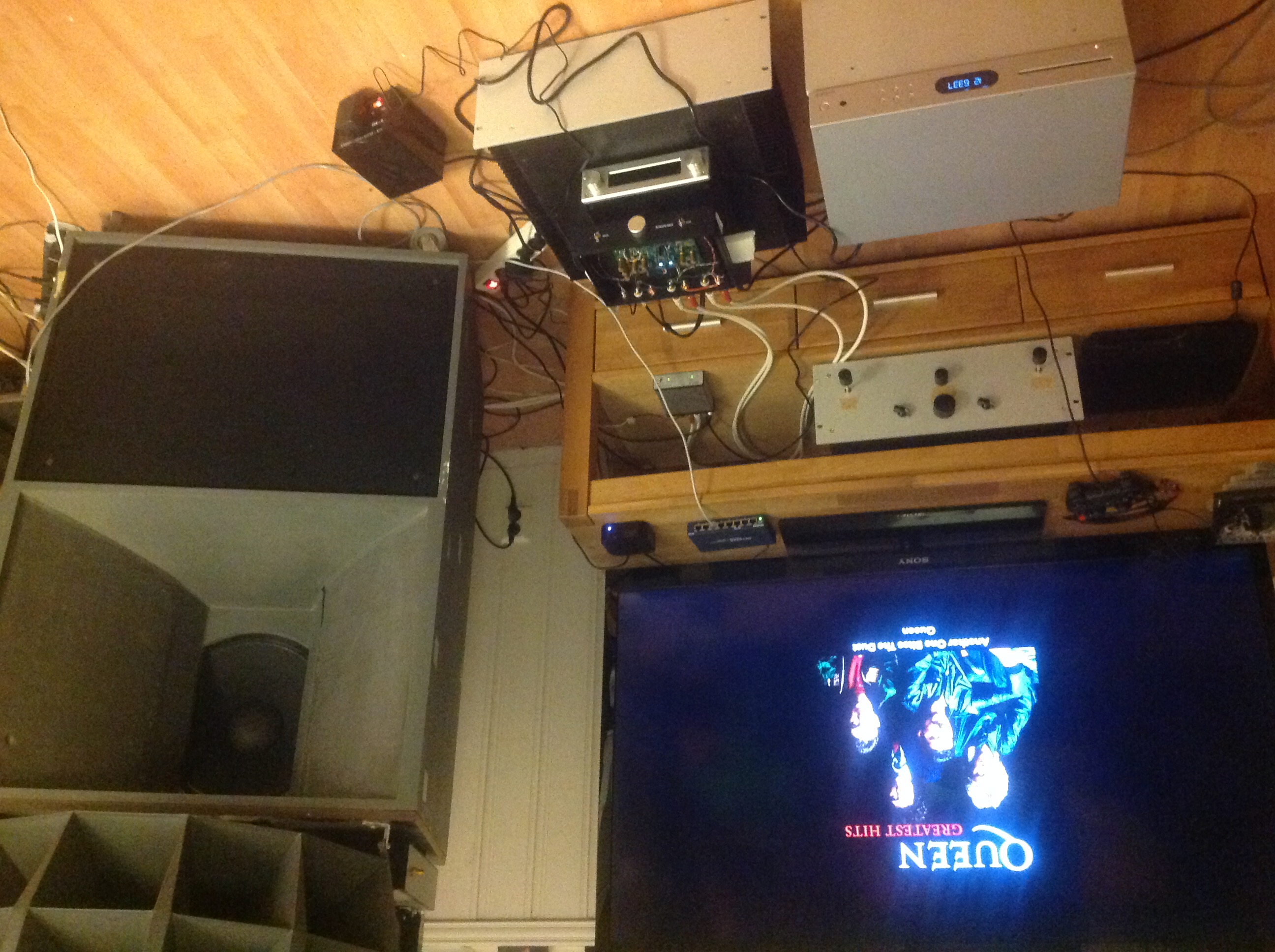

Alone at last. Nice melancoly with Nico on the Altecs, B1 Korg in progress. Life is good 🙂

Didnt bother to wait for an answer, followed instruction and finished the kit. Playing fine now on my M2 and Altecs. 🙂
One thing it is gatherin some static electricity and gives a small jolt when I touch the volume. Do I need to ground the case somehow?

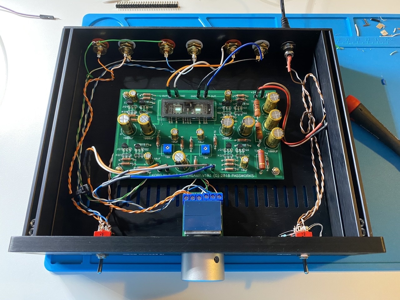

Received and built one of the first from batch 2 today. Overall, the build was pretty quick and simple. I suppose I should have taken the time to heat shrink my wire runs.
Here are a few minor things I ran into:
1. As can be seen in the attached picture, I didn't realize that the outline for the Nutube doesn't line up with the Nutube itself and stuck the foam in the wrong place as it seemed more logical to put the foam on the board and wiggle the Nutube into place.
2. I was a little confused for a minute about the way the power switch and LED were wired; it works as described although not sure why it was done this way...
3. I can't get the chassis itself to lay completely flat with all sides screwed in. I tried screwing in the front first, back first and bottom first to no avail... When screwed down, front left (or back right) has a little lift to it.
So I fired it up, calibrated test points to 9.75V each and it worked first time. With top off or on, it's microphinic when adjusting volume or tapping chassis. I did use the suggested iFlight standoffs and foam under the Nutube but still have issues. I will try using dynamat over vents.
Additionally, when touching the chassis, I pick up AM 1240. I live in Denver where it's pretty dry and also notice pops when touching the volume nob.
So now that we have all that out of the way, how does it sound? Fantastic is my take. I sold my reference LX521's a few months ago and am currently building a new reference. The bookshelf speakers I'm using in the interim have never sounded so good. Specifically, there is just a realness to the music. Imaging seems improved with just a better feel of space. I'm running ADI-2 pro DAC from RME with ATI amplifiers and bookshelf speakers of my own design.
I think this kit is well worth the asking price. I'll work on solving the microphone issues and see if I can add a remote for volume control. I sure hope that it integrates well with the Aleph J I'm finishing up this week.
Overall, it's a solid $300 spent + maybe 4 hours of work.
Enjoy!

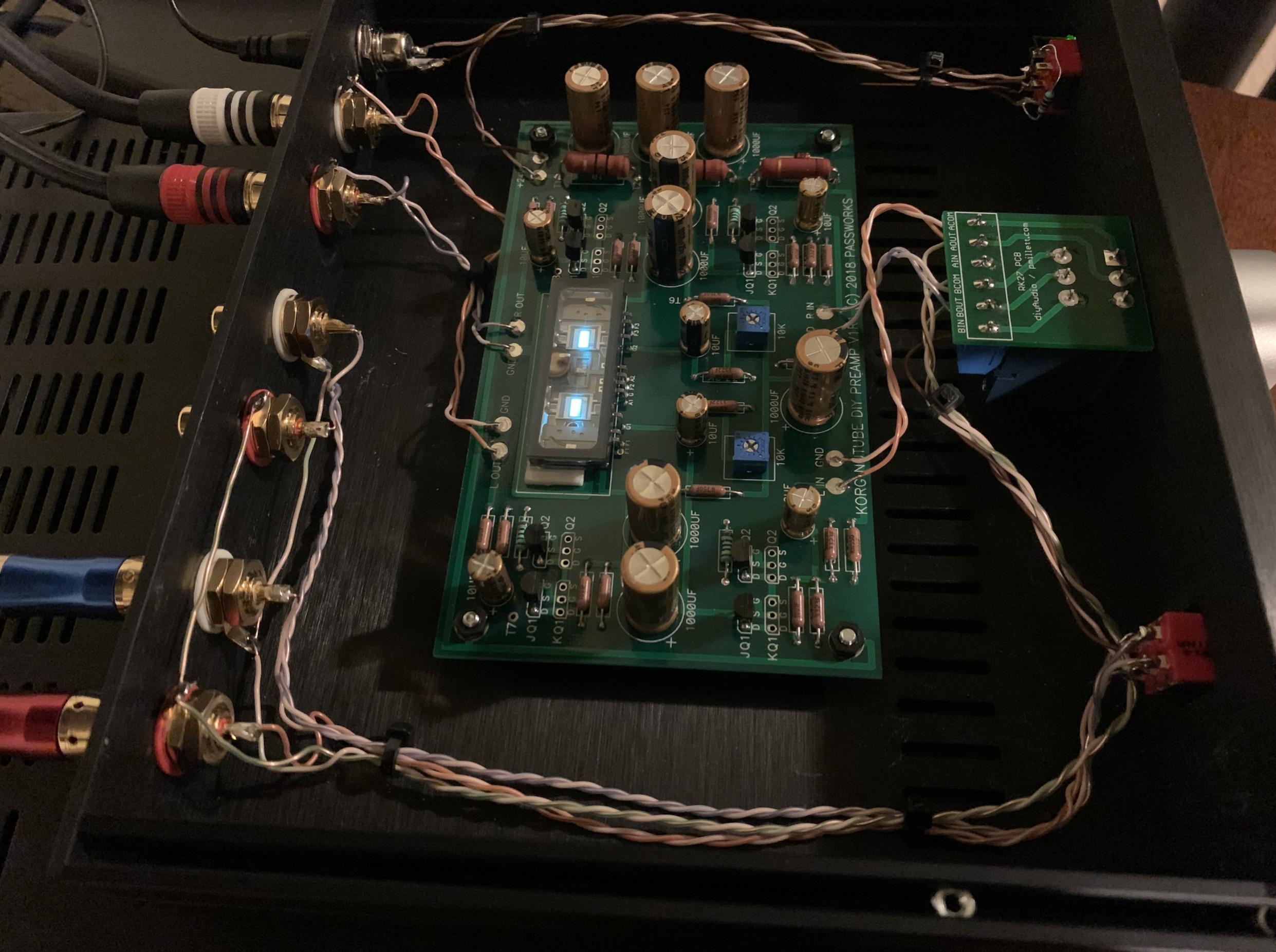

Another complaint : the wiring of the LED of the ON / OFF switch is not easy and the hole provided for the LED is too small, so the LED is almost invisible when turned on, it's a shame, so I replaced the original LED by a blue LED with a serial resistance of 2.2 kOhms and I inserted it in the hole provided for this purpose after having bored to 3mm. The connection of the LED is now with a plug-in connector. This is the only modification made to 6L6's work with the use of flexible wires and a larger gauge for 24 Volt wiring.
Otherwise, I must say that I am extremely satisfied with the result and especially the excellence of the sound ! (And I have absolutely no microphonic effect, but I do not listen to music at a high level ...)
Thank you once again to Mr. Nelson Pass for making public this achievement and 6L6 among others for his valuable advice throughout the many pages devoted to the realization of this project !

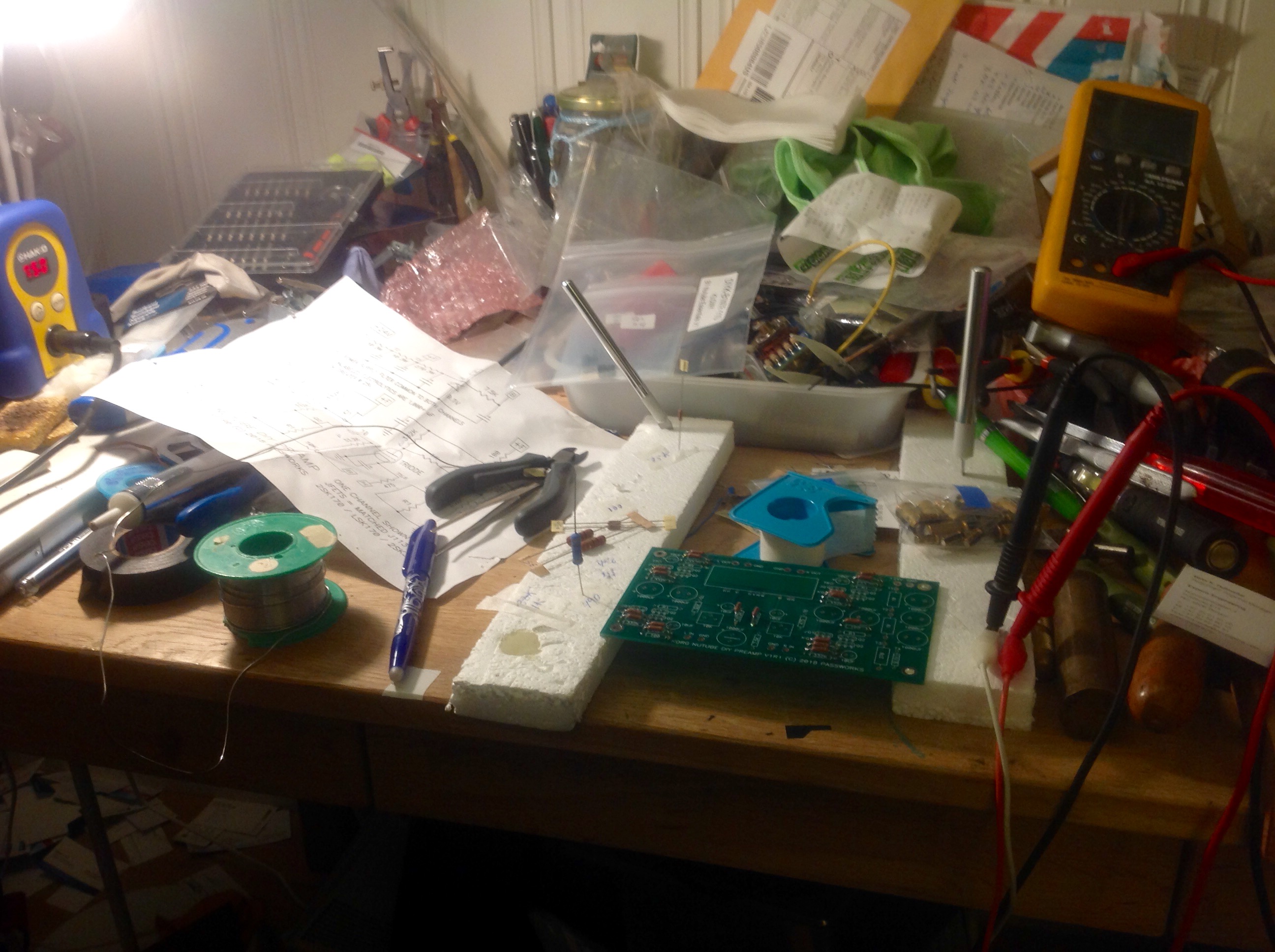

Here are some pictures of the different stages of construction and the final result.
The opening of the package:
The completion kit bag :
Use of an antistatic wrist strap :
It must be connected to the earth, of course !
The printed circuit board is finished !
Mechanical assembly :
The Korg Nutube double triode :
Mounting of power resistors with little steatite posts :
Final wiring :
Wiring modified ON / OFF switch and LED :
In good company !
It's all for today !

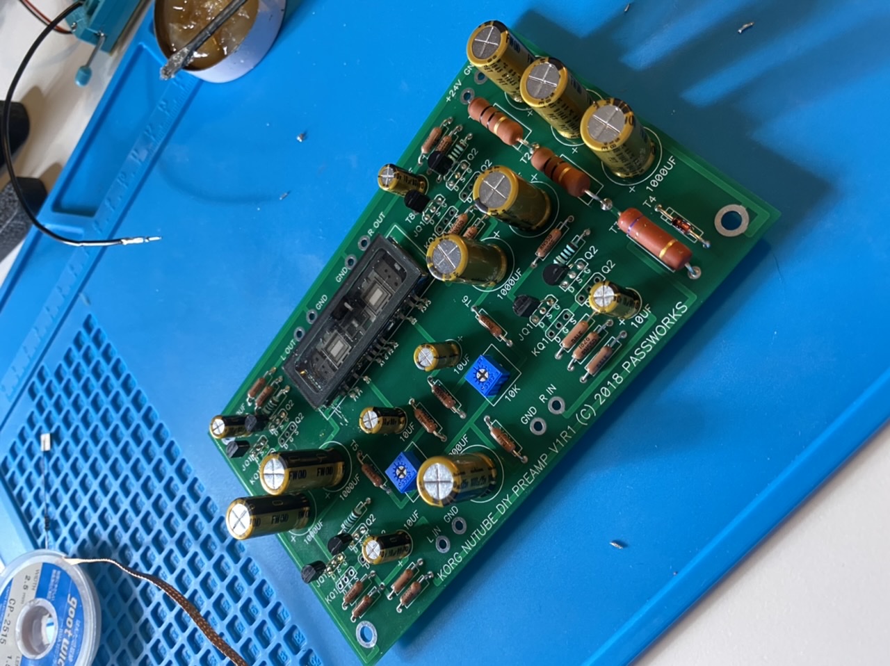

Built my Pioneer kit in roughly 5 hours, two sittings. I haven’t built a kit since the early 90s - so call me “rusty.” Been burning in for the last 24hrs, about to go do a first listen.
Notes and observations:
1. It took me a second - and to reread Papa Pass’ PDF - before I understood what was going on with JFET positions for stuffing.
2. My parts tester kept indicating different JFET pinouts than what was marked on the board... eventually decided to ¯\_(ツ)_/¯ and install as marked.
3. I didn’t see the build photos until after I’d already stuffed/soldered the board up, and was already on my way to wiring in a less-advantageous manner than what 6L6 proposed. Probably ate a half hour of my 5hr build time to undo and redo.
4. Probably took another 20-30 mins to rig up pin header test points, power supply and input/output connections. More for my own sanity than anything else.
5. The LED is...not my favorite part of this. Will def. be making a change here.
Will probably convert this to a remote control volume/power setup but am eager to do first listens today.
