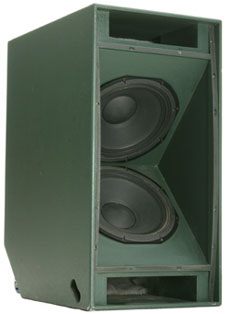

yes u are right you can see in the specs..but why people esp. in our prov.(Iloilo & Capiz) using this MR1800?..coz im planning to puchase a power amp & i want to hear/know which is better..like for example for a 1850 sub loaded with T&T 18 AKDSW or JH 186...which speaker is better for this sub? i have already 4 1850 loaded with crown 1860..low throws at a distance but i want to change the driver..
any suggestion guys which speaker is best for this sub (1850)..

I got this from speaker plans.com..they use V18 1000 for the 1850 cabs...& if I'm not mistaken the lokal version or clone of this V18 1000 is the Neusch PD1850 12k each in Raon manila,, http://forum.speakerplans.com/1850-horn-loaded-with-v18-1000_topic11681_page1.html

hello sir amants..if that case P.AUDIO SD18L is around 16k (1000-1600watts) is better than pd1850 i think..and also capable for 1850 sub..but they're expensive, as they told before..we are in the province and we considered the ROI (return of investment)..so kahit papano mareremedyuhan din..maybe i will go for JH186 or T&T AK18 DSW what do you think sir amants?!
anybody guys experienced this T&T AK18 DSW? around 5k and is very cheap for 1000w speaker???..while JH186 1000w-8,900k

of course Paudio SD18el is powerful than neusch PD 1850.,,pd1850 is only 600watts rms while the sd18el is 1000wtts rms..the sd18el is 16k but the less price is arround 14,400 as my friend told me because he order the sd18el at music box in pampangga,,& sd18el is very powerfull,the best & the beast ika nga, & I'm planing to have this "beast" someday,& if u have an extra budget for me I'll go for jh186 than the T&T..jh 186 last update price ko sa raon last 2 months is 7,900/pc.discounted na ,jh 186 is 5.5" voice coil while the T&T is 4"voice coil..& maybe dj-jojo can tell you if what is the performance of jh186 because he use the jh186 for his WSX sub....,,,for my subzero I use the neusch pd1850 not the pd1850x & not the pd1850B just the pd1850 lang 12k un..while the B & X is arround 8.5k to 10k & i din't understand very well if what is the deferent between the X & B & the pd1850 only...have a nice day

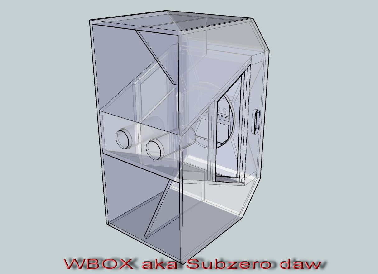

@malufhet2000
see attachment for your requested info on WBOX...its not a subzero...Subzero is a company that makes Car audio boxes...Products
have fun
jojo

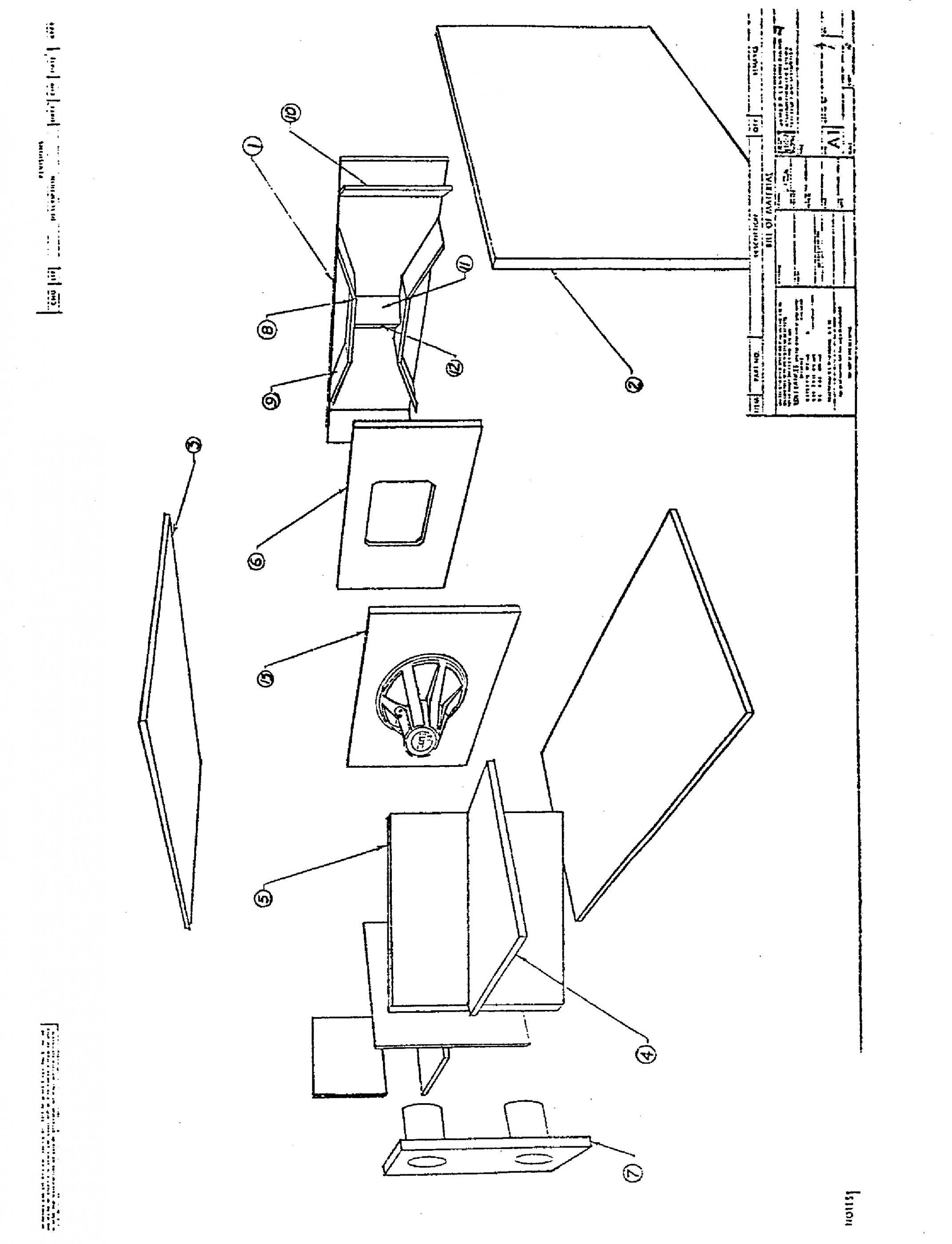

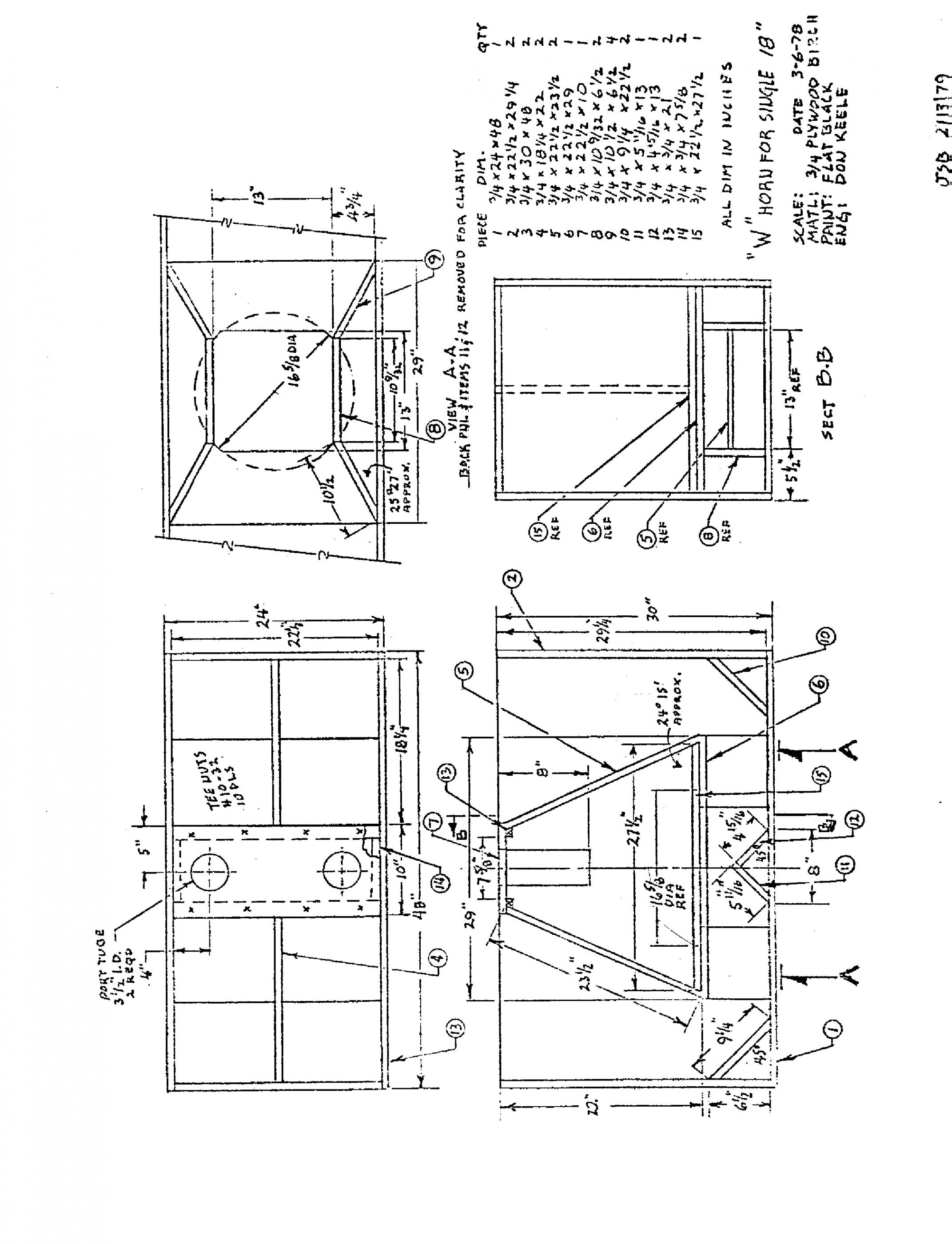

@leinad61
i use to have those plan a very long time ago, its a hard copy (in drawing papers) i must have lost it already...if ever i find it i will scan it for you and share it.
in the mean time here is same version...hope this help
have a nice day
jojo
have a nice day
jojo
