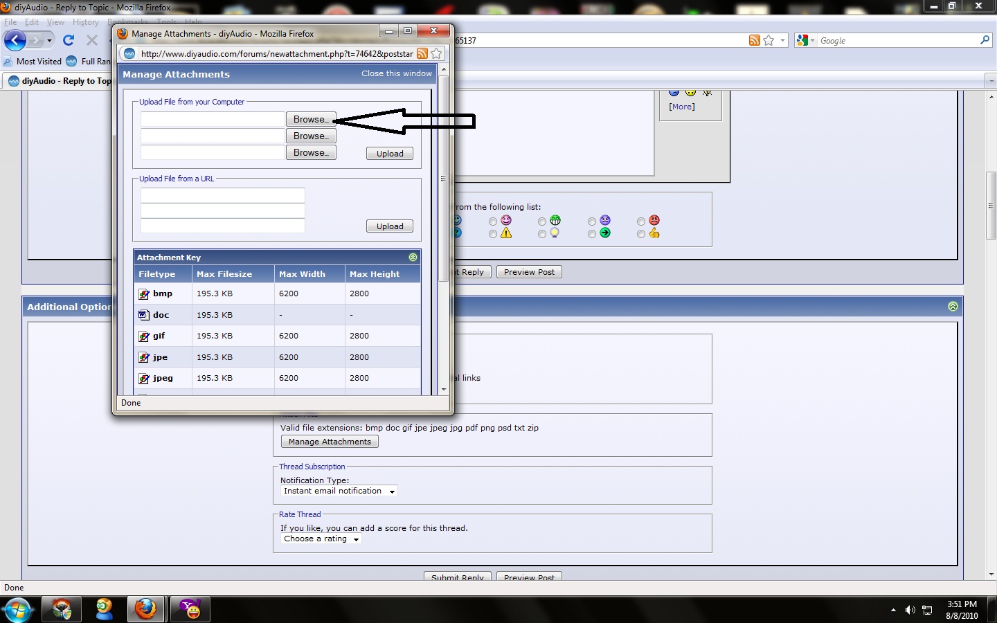

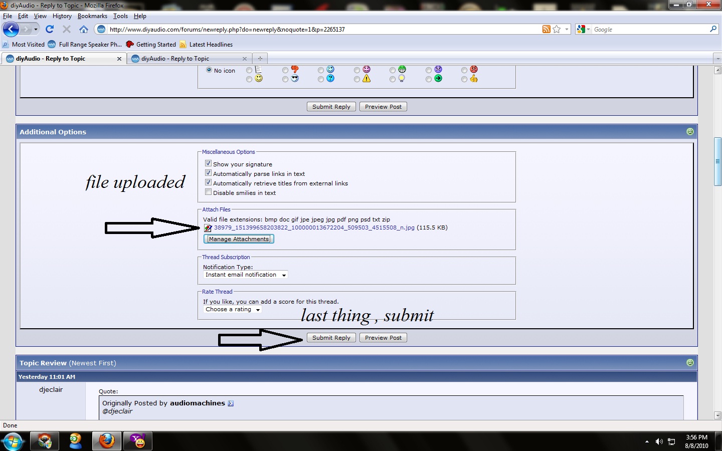

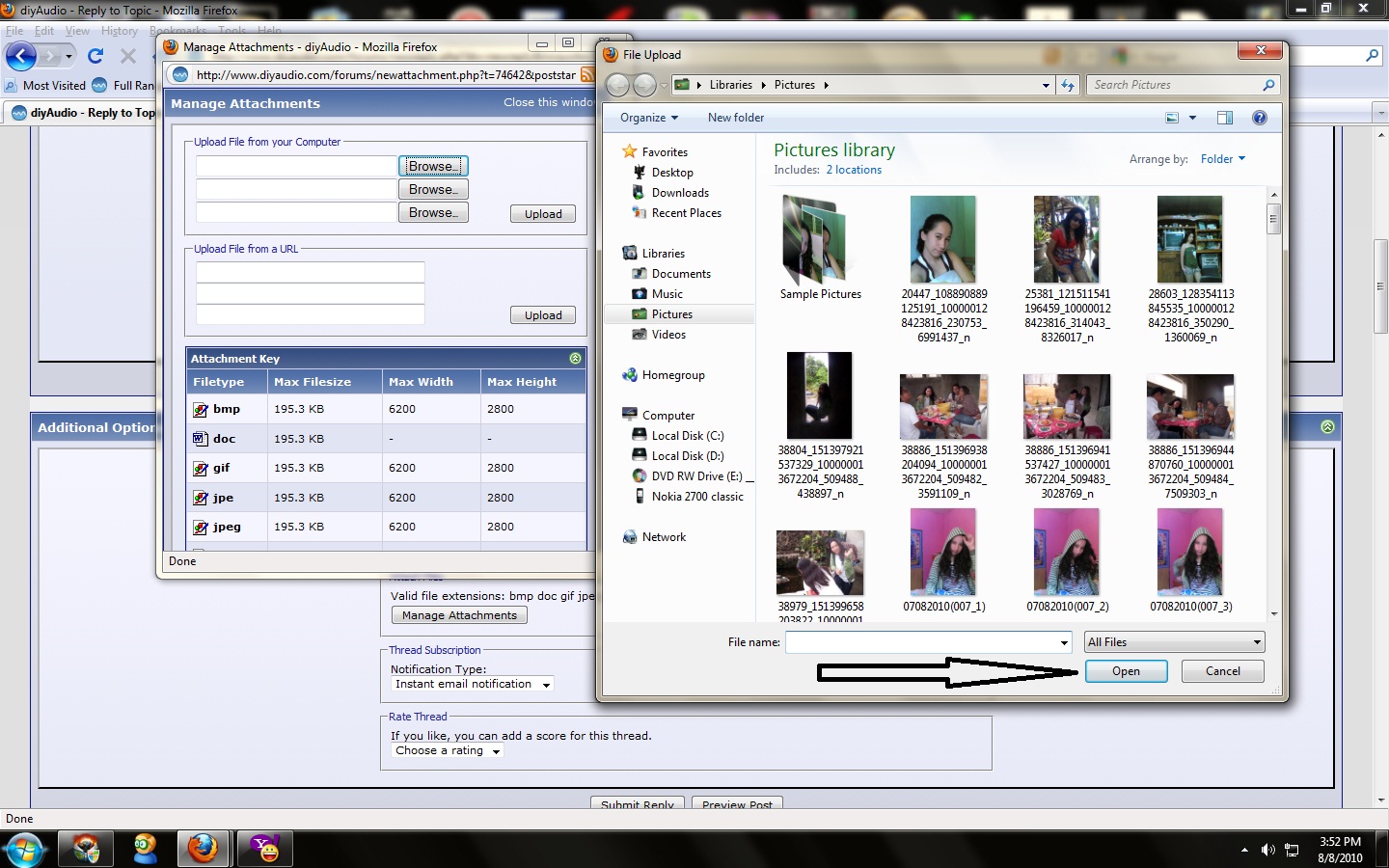

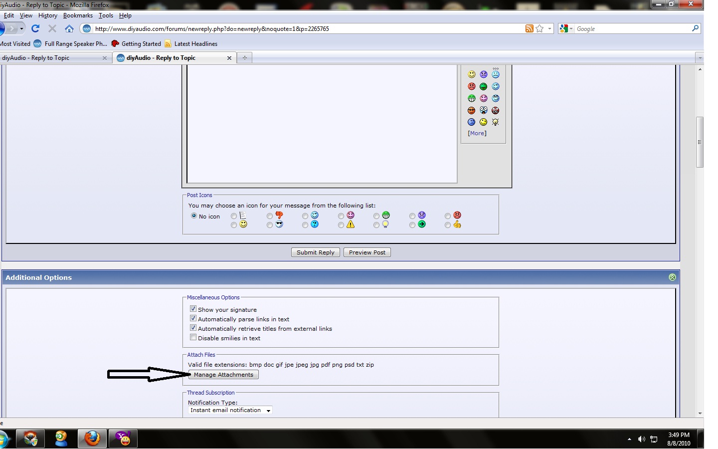

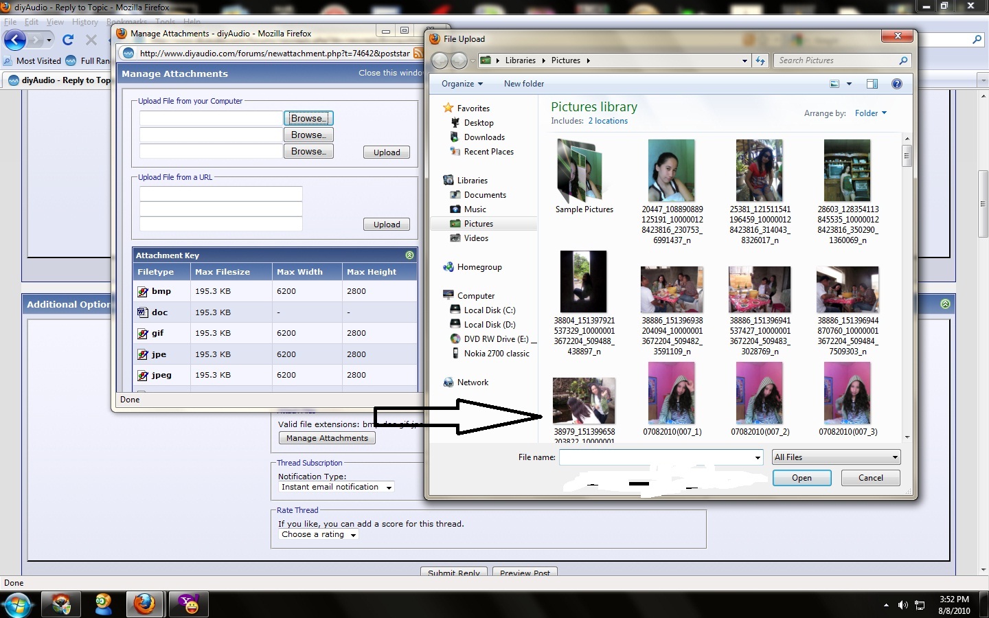

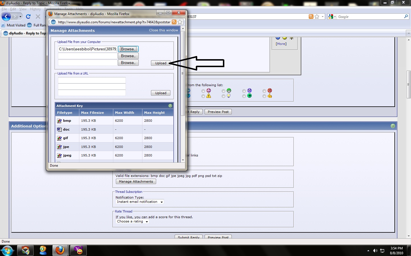

Sir AudioMachine
This is another prooblem, i don't know how to post picture here 🙂
first reply,Sir AudioMachine
then follow steps...
this might help...
regards,
ees
first reply,
this might help...
regards,
ees
Thank you very much sir eesbiboi, it helps a lot, appreciate it 🙂
