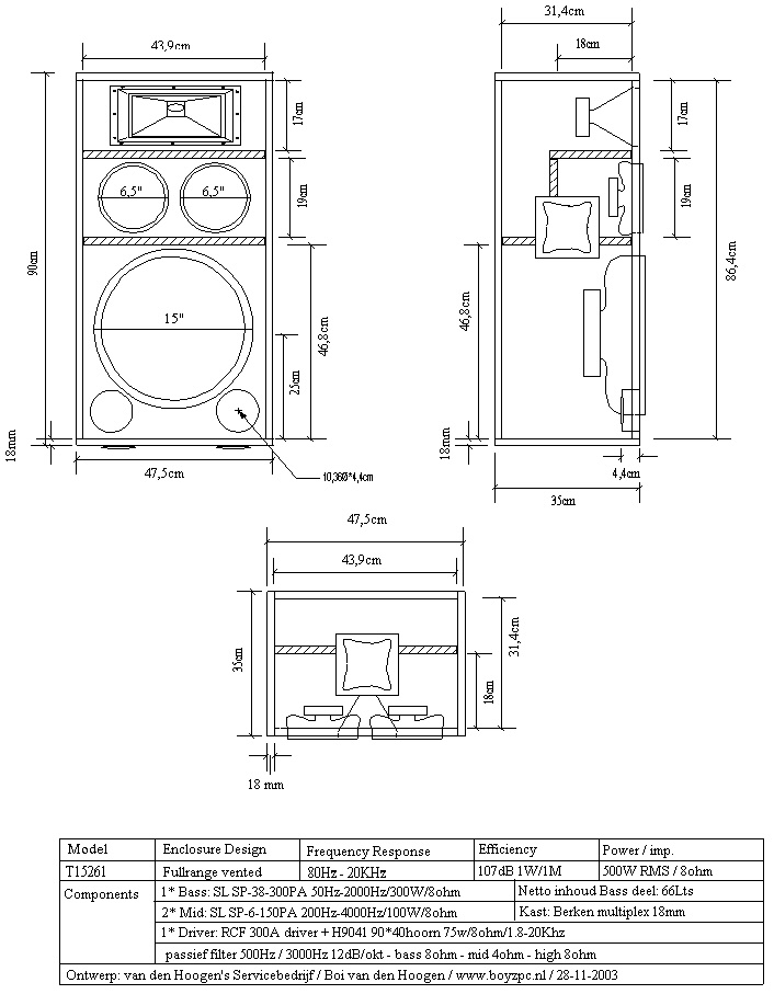

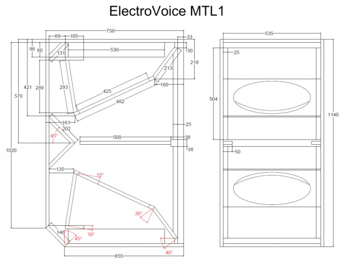

for the 15mid its very important that you get a good 6.5" and design a good passive network and if you can modify the 6.5" panel placement so that it will be mechanically time-aligned to other drivers...this will minimize comb-filter.
just remember that if you use other drivers...response will not be same as the required drivers...but, you can eq a little (be aware of the phase shifting during eq) to get your own desired response.
have fun
jojo
