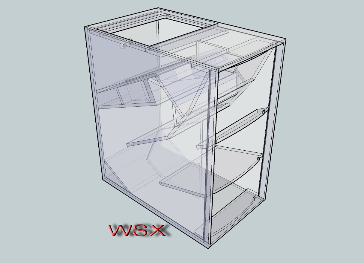

jojo,

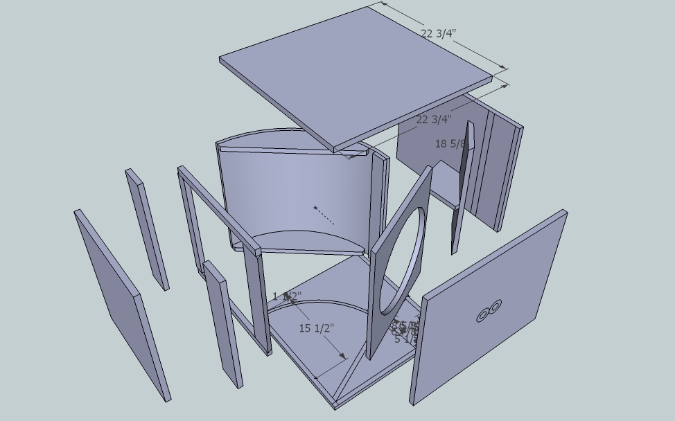

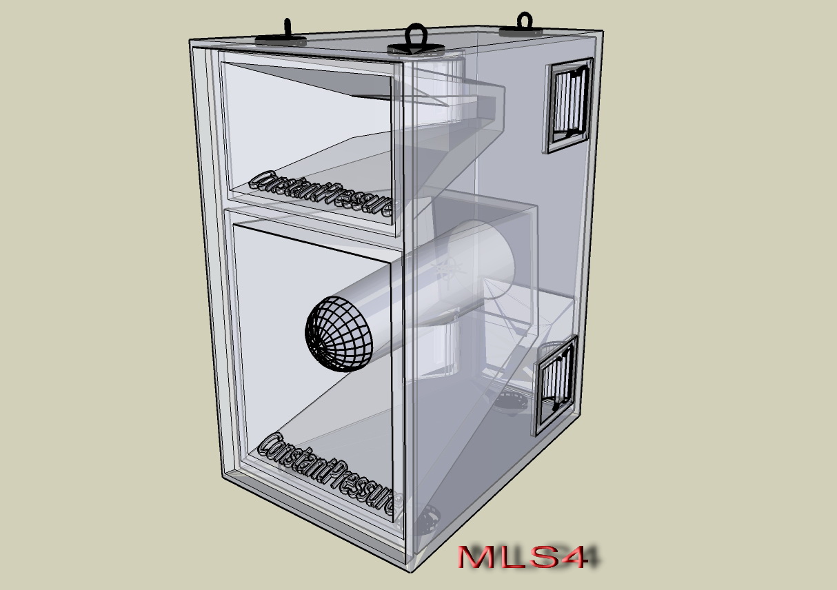

thanks sir do you have a complite drawing of the box, what are the possible driver that i can used. is there any teak on freq of the wsx box? what about this hd box i just additional it to my set-up?

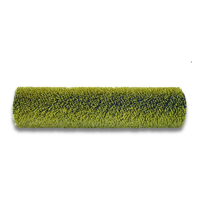

how to texture paint your speakerbox diy way...since acrytech products Speaker Cabinet Coating for superior performance Speaker Cabinet Texture Coating in gloss or satin are not locally available...here's a simple way on how to mix your own textured paint.
this are water base paint...Do Not Mix with H20 (water)
versatex high profile 7517...then mix with acrycolor black pwtac-1117 with 1:1 ratio...then mix a acrycolor thalo-blue .25% ratio...stir very very well.
to apply use a nylon texture roller brush...clean your brushes with water.
to finish apply boysen 700 clear gloss emulsion.
i hope this can be applicable to others...

i already have a kick bin using wsx i need upper base have punch on chest. my wsx is working well for lower freq. not on upper base.
how many wsx sub are you using? I've had heard the wsx sub 6 per side on live band and its very strong punch. try to higher crossover point

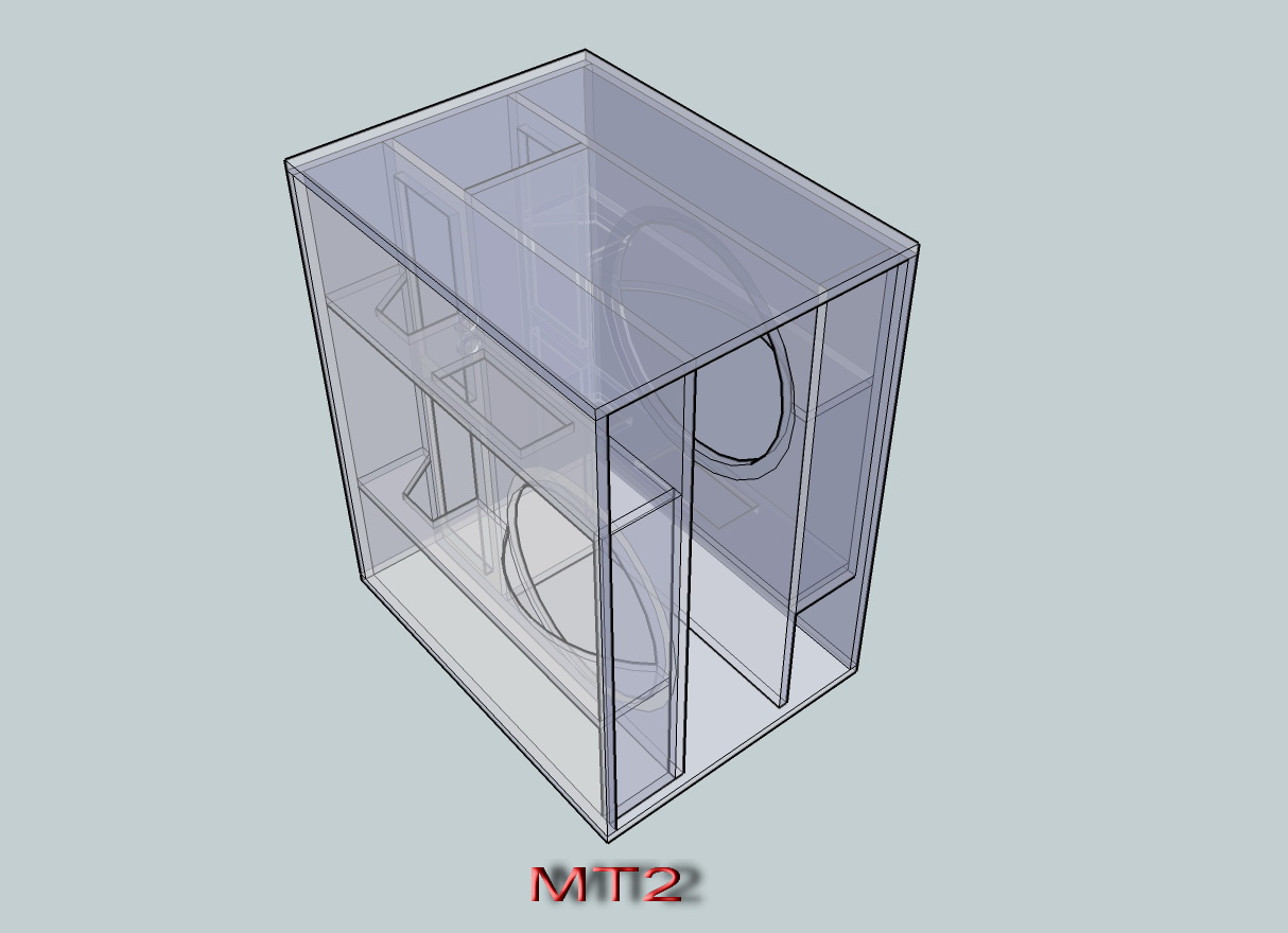

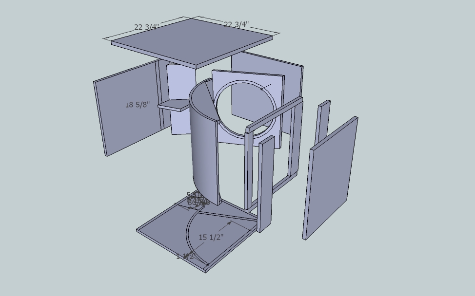

mt2 vs wsx

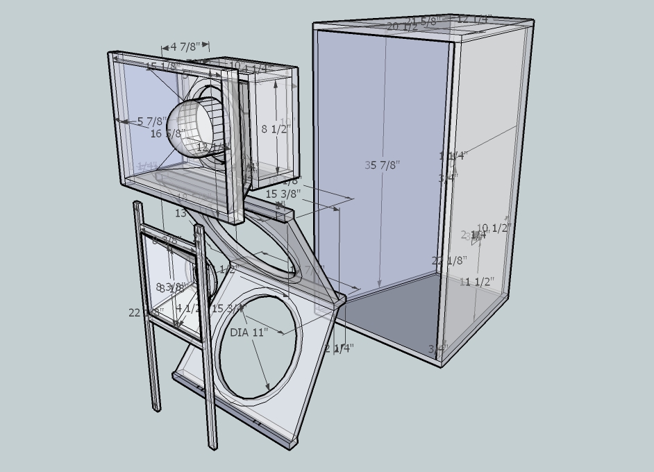

HI all,
I am newbie here I just wanna ask which is better to use in subwoofer mt2 or wsx, If I used 1850 speaker driver will work in mt2 box? and anybody used the mt2 box? I`ve seen this set-up in manila med. concert bass, is good But I dont know which driver they used.
regards,
smblite
HI all,
regards,
smblite

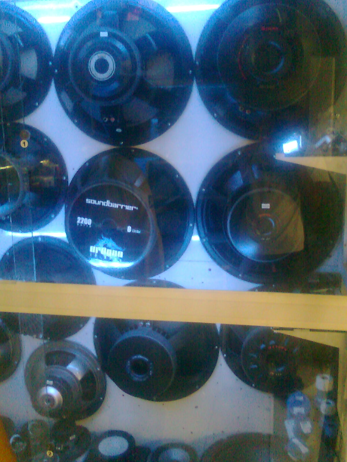

hi guys...
pardon to interrupt...
i'm just wondering...
i saw this speaker in an electronic store just yesterday when i was buying components for my diy amp...
i was really shocked with that guy hanging with those other guys...t'was like" hey... i never saw something like this before"...

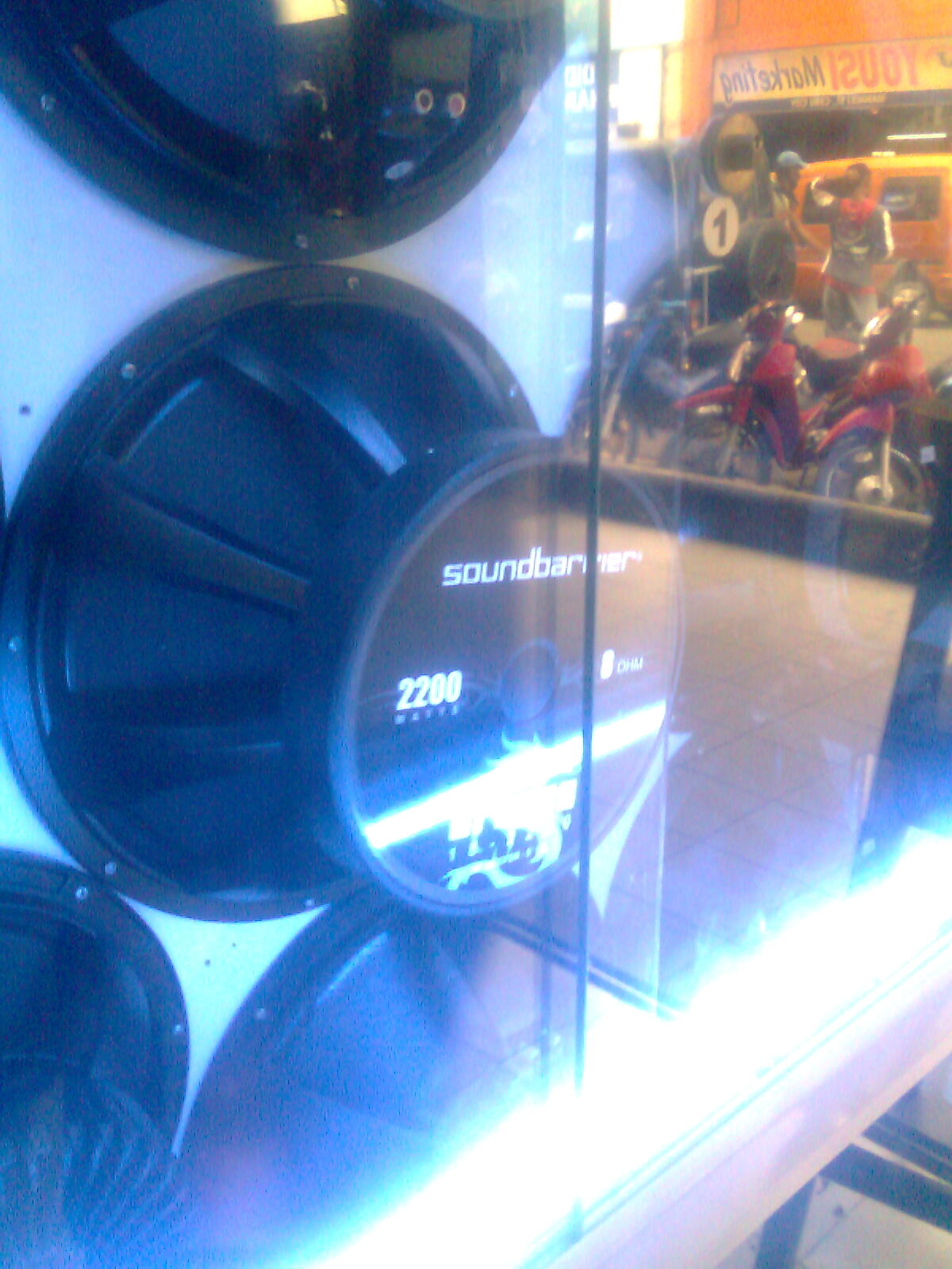

it was a SOUND BARRIER 18" speaker which is 2200w @ 8ohms...with a magnet diameter of about 12"...gosh!!! i didnt get to see its voice coil diameter...
do we have something to diy just to turn this guy ON???...
tnx...

@esobe
wich store incebu you find this speaker?
i found them at AC?DC electronics located at manalili cebu...
i sound barrier is a bit pricy...
15" 1200w @ 8ohms cost much...i guess t'was 8500 pesos...
18" 2200w @ 8 ohms would be much expensive...😱😱😱😱😱😱😱
HI all,
regards,
smblite[/QUO
Folded horn design is far more better than those manifold technologies if you are doing outdoor sound, if you want to build the wsx you have to build at least minimum of four per side mirror setup to achieve coupling effect becoz it was design to stack into array. Crown 1850 don't have t/s parameter I don't know f 1850 works well in wsx. A speaker with low qts and fs, hi BL and high xmax work well in horn design. Original wsx was fiitted with RCF driver but builders from UK are fitting void18-1000 speaker and they says it plays louder than the original wsx from martin.
arnold manuel; Folded horn design is far more better than those manifold technologies if you are doing outdoor sound said:Hi Arnold,
Yes I`m planning to build sound system and looking for compactness subwoofer and I`ve seen this MTL2 posted by jojo and I`m thinking that this MTL2 is suitable in PA touring, But like said I dont knw what driver to use and also measurment of this box.
Maybe I try first the wsx subwoofer becoz I`ve noticed that this subwoofer will work in 1850 driver which is available in our local store, and like you said 4pairs wsx per side is enough for starting.
Best regards,
smblite

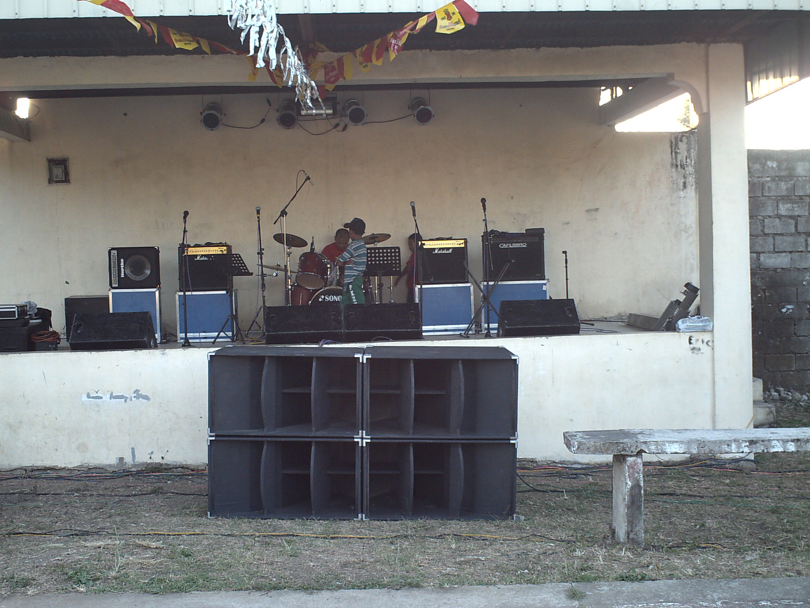

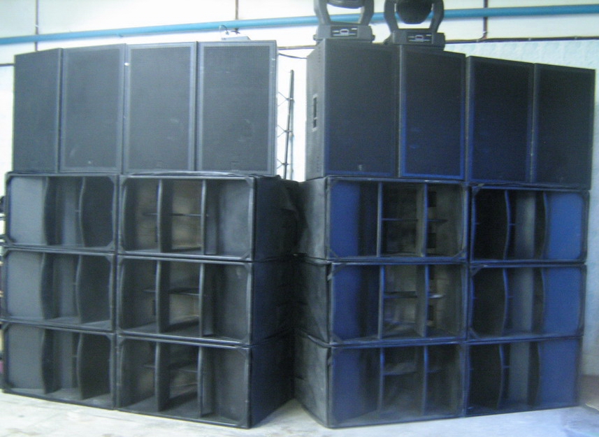

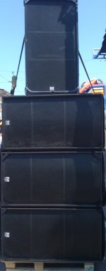

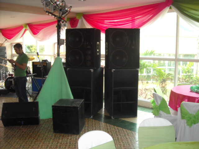

samples of wsx stacking configuration...
have a nice day
jojo
have a nice day
jojo
sir jojo,
what a very nice set-up. what kind of speaker box u used on mid high sir. on the top of wsxspeaker

Nice set up sir Jojo, I really excited having a sound system like that set up.
smblite
