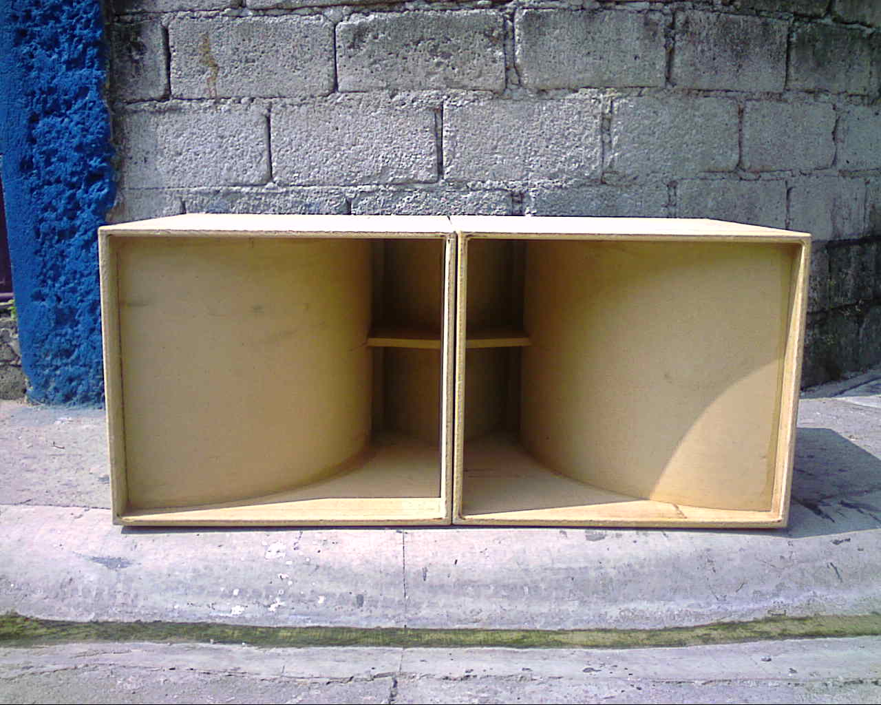

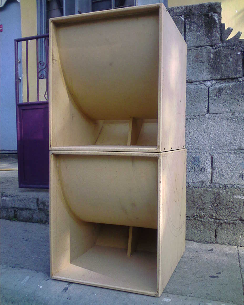

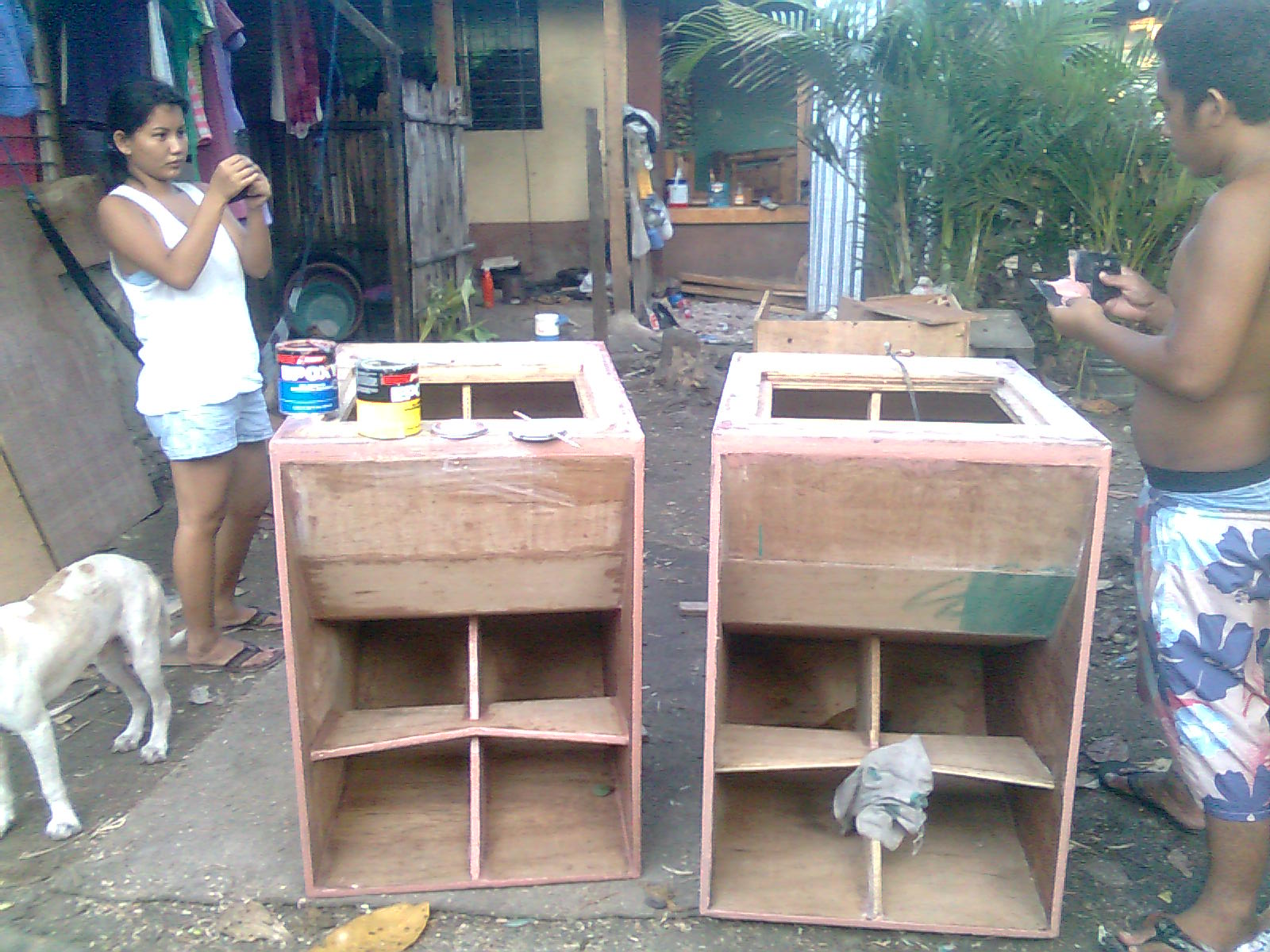

my bro ang i built 4 cerwin vega L36je box...would it be nice to load it with crown jh181 (jackhammer)?...
how would it sound like???...
anyone tried this set up???

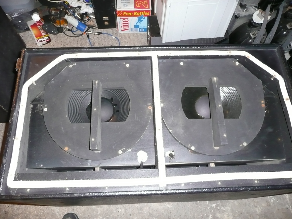

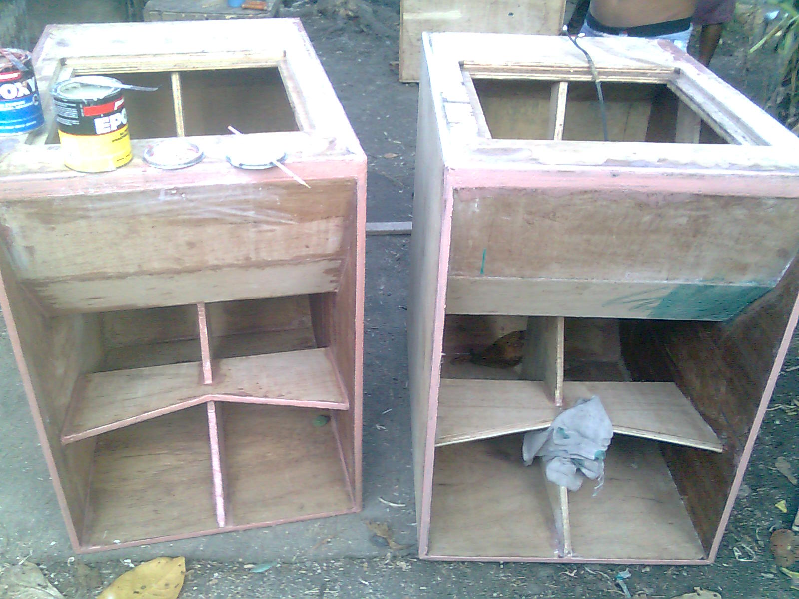

@eesbiboi
very good job...now the only concern is the cover...it must be really firm and secured from flexing otherwise problem may occur...but all is looking good...kudos bro.
try to mod the cover something like this sample from nexo dual 18.

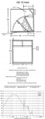

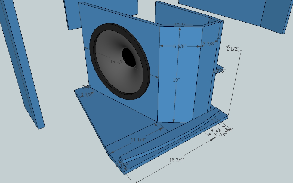

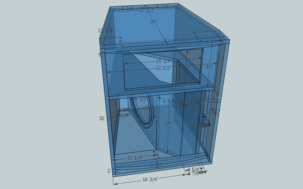

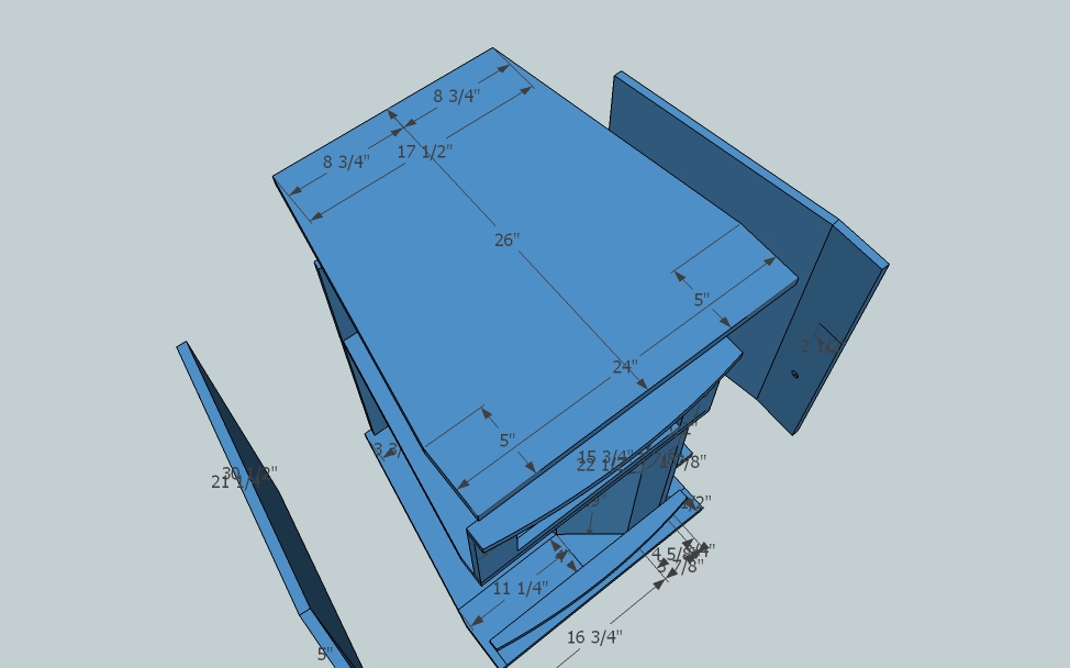

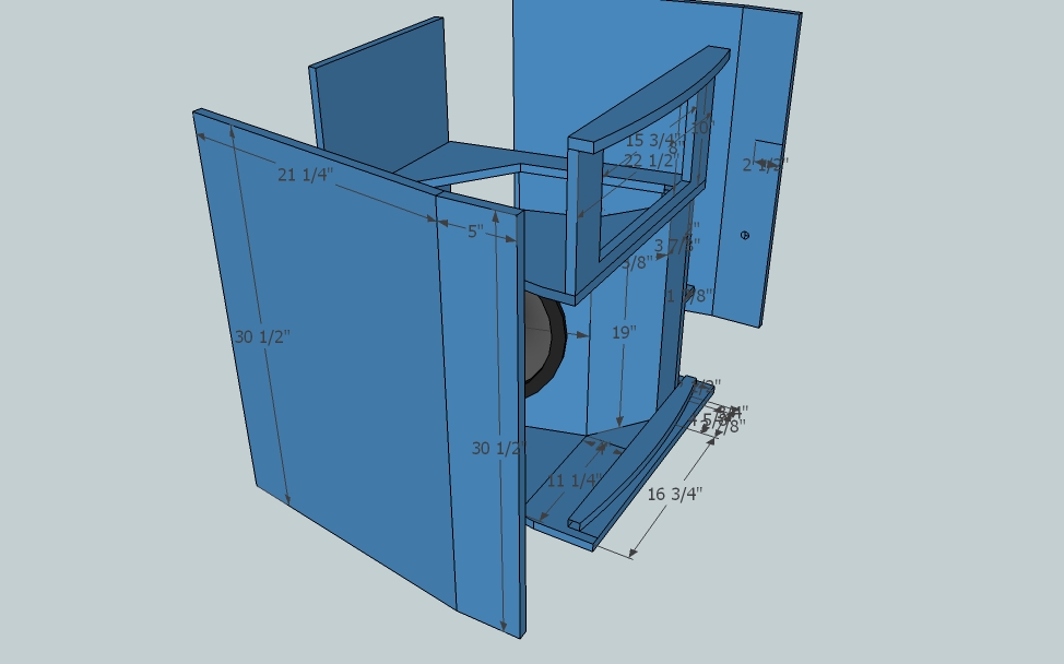

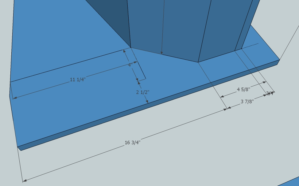

i only have this format...or else CAD format.
is this format ok?
have a nice day

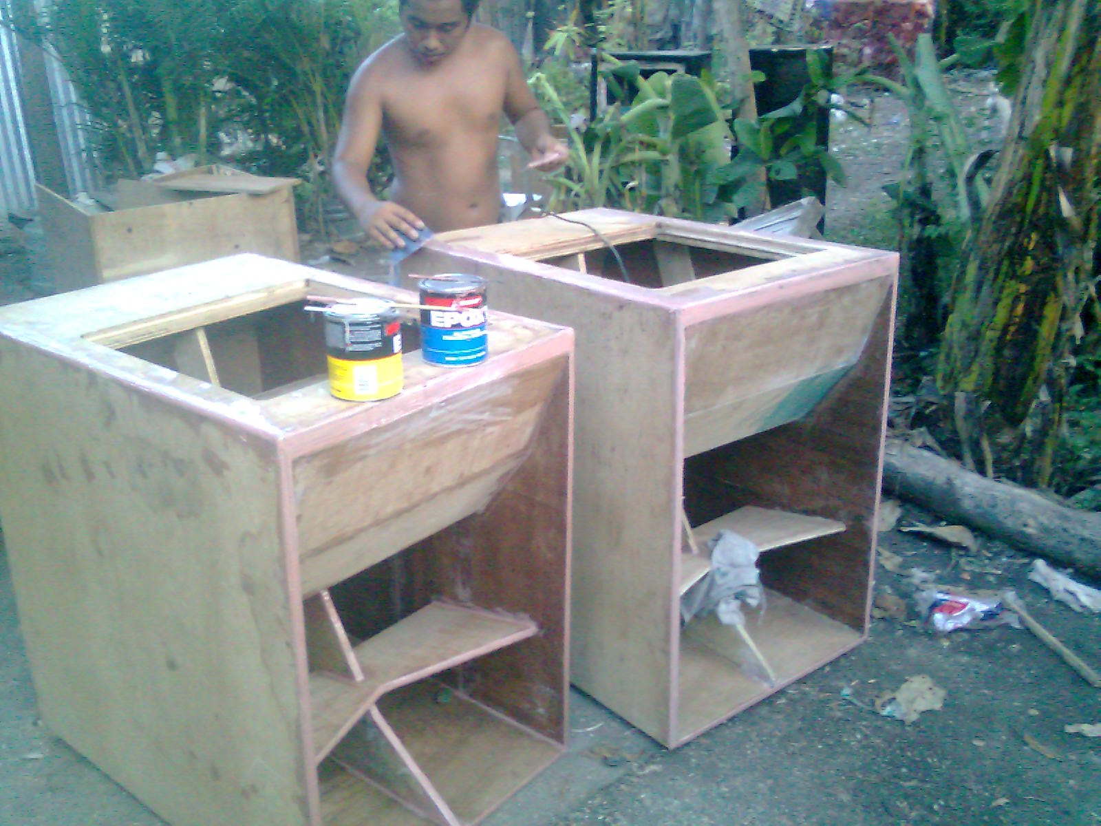

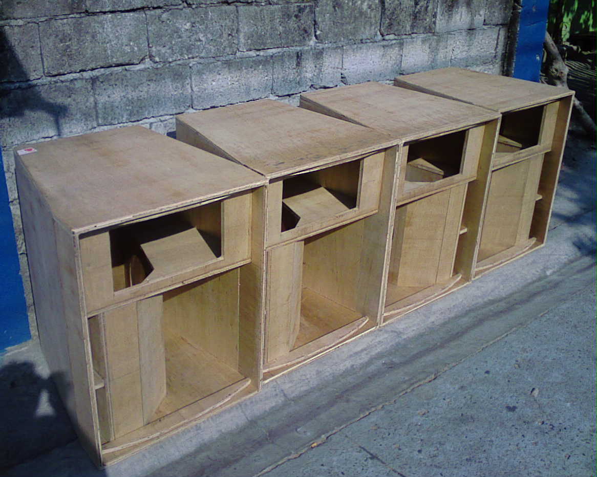

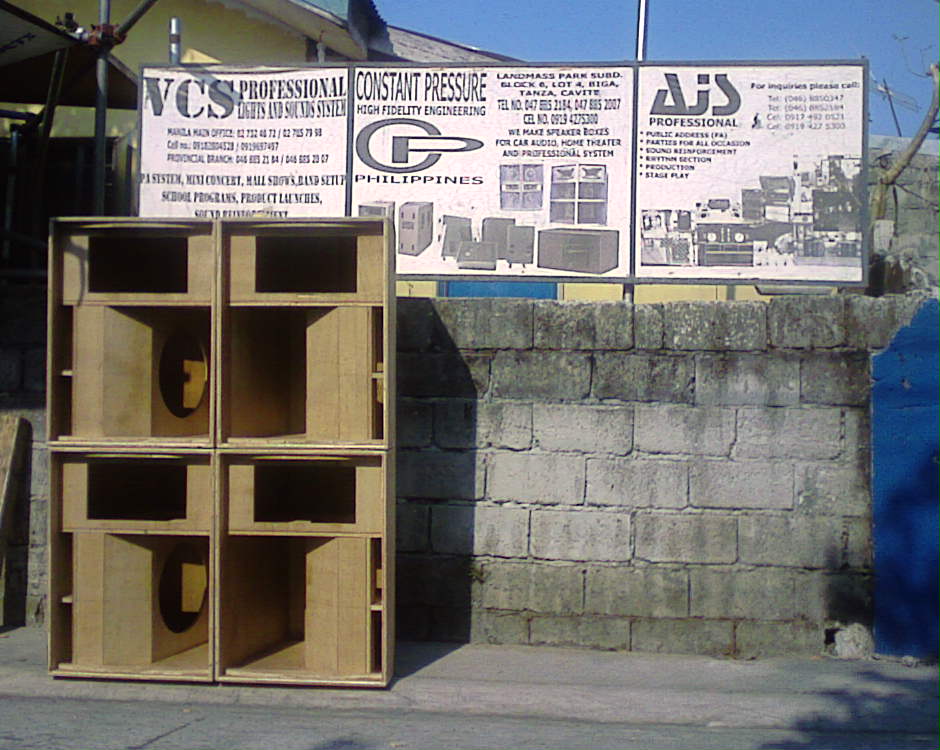

thank you so much sir for the reply
i have 4 wsxbox loaded with crown pro 1815 the design was copy from your post.
for the mid- high i used full ranged yamaha cv15 4box
i used digital crosover altodrive 3.4 , dbx sub harmonic some eq from phonics and mackie live sound mixer.
the subs are good it can be hear at far even 50m the roof rattles, but i cant feel the base at 6m on my chest.
im newbee on sound system but i love it.
pls do help,
rod
