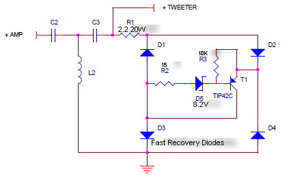

anybody please share a two way passive cross over,i'm planning to build a two way mid top using 15'' crown and 100w for the hi's.maybe in trapezoid box

give more data...like drivers cut-off freq?...impedance?...
what is the Hi driver exit?...2"...1.5"...1"
what is the Hi driver horns cut-off freq.?...
what is the box configuration...bass reflex direct radiating or horn loaded with or w/out phase plug?
do you need some kind of a Hi driver protection?

the box is close to speakerplans x15
it is only crown 1530(15'')
for hi's 1'' exit
bass reflex only
as of now i only use hi pass filter
my problem is when i use big amps i can't get clear audio
my purpose is to use it for small gigs like small party
any generic passive much appreciated

this is the best i can come up with the only available data i can get...sorry i can only have wild guest for the Hi driver part.
hi driver protection coming up...next post...sorry

Hi driver protection...make sure to properly heatsink TIP42.
For the fast-recovery diode a rated 3amps should do the job.

by the way the hi's are 200w from crown

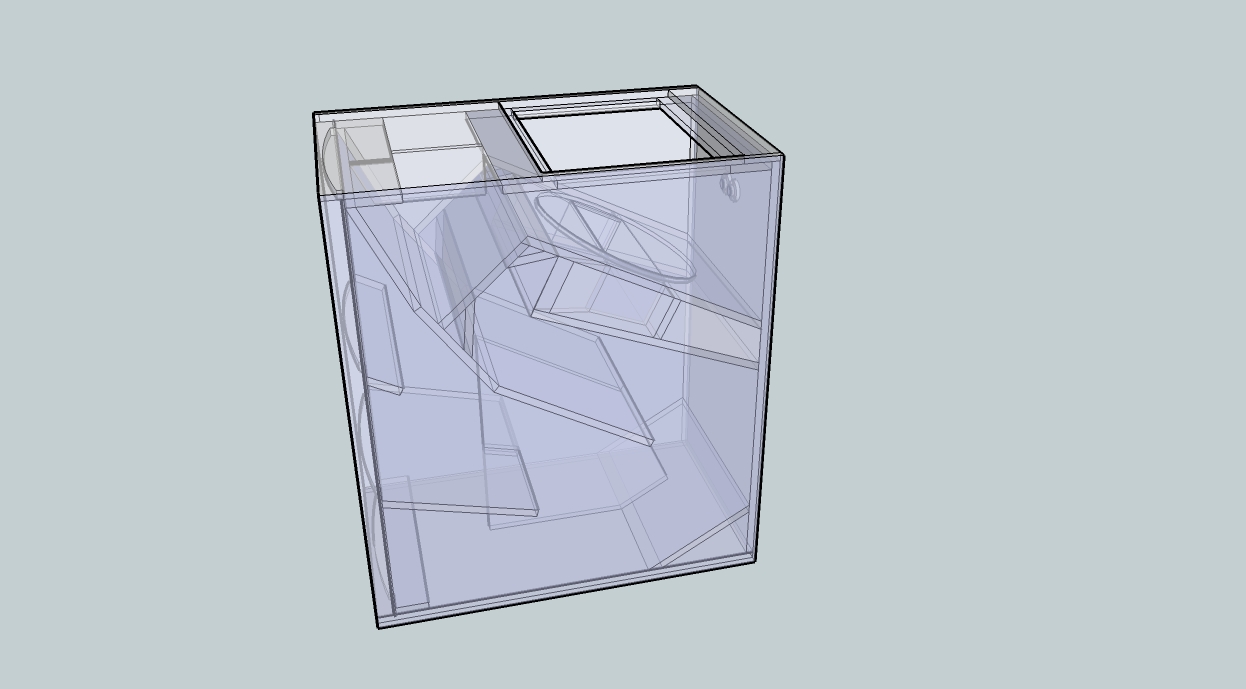

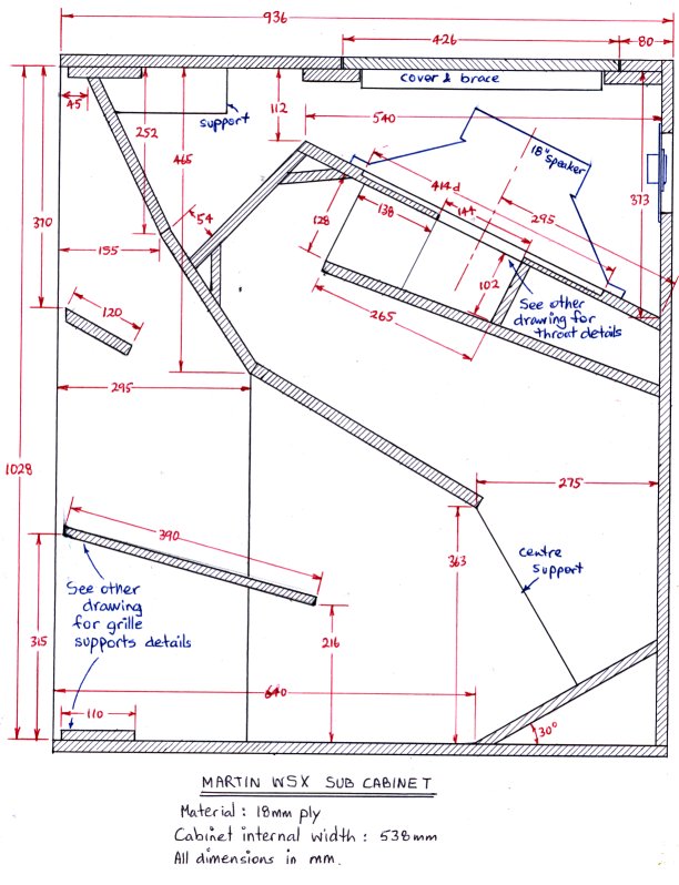

need help about sub bass
I want help in AG sub bass design with dual 18 inch speaker,
I see the design but i didn't understand the internally dimensions of the sub bass design.
Anyone plz help me about that.
I need it for experiment.

@gribox...
WSX plan...here you go...
Thank you very much sir jojo!! mabuhay po kau..im now excited to hear this monster!!!!

greetings can you please tell values of c1 c2 and l1 inductor for hf protect
circuit can it be adjusted for 100 watt p audio compression driver or any other
protect circuit

c1,c2 and l1 is just a representative of a HF passive circuit, so these values will depend on your cut-off frequency of the driver units horn.
this is just to show where to place or insert the Hi-protection or limiter of the driver.
