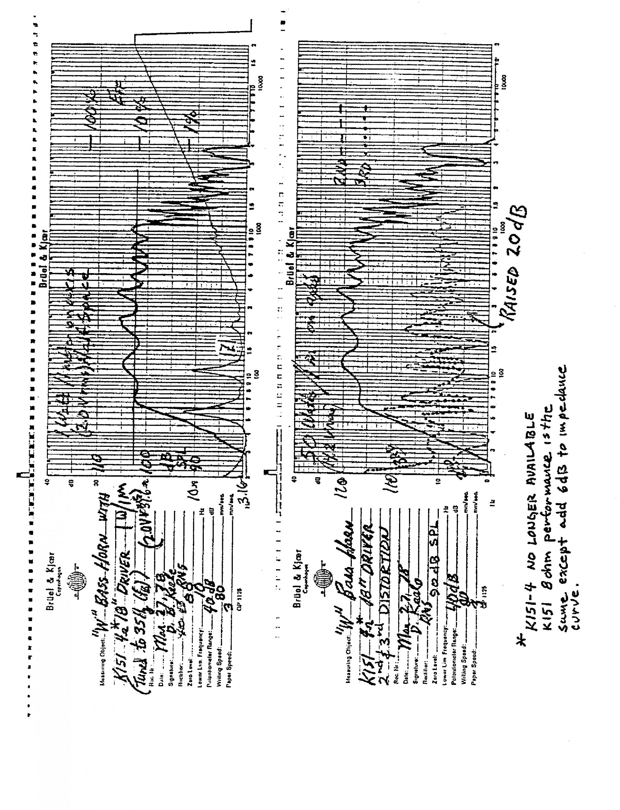

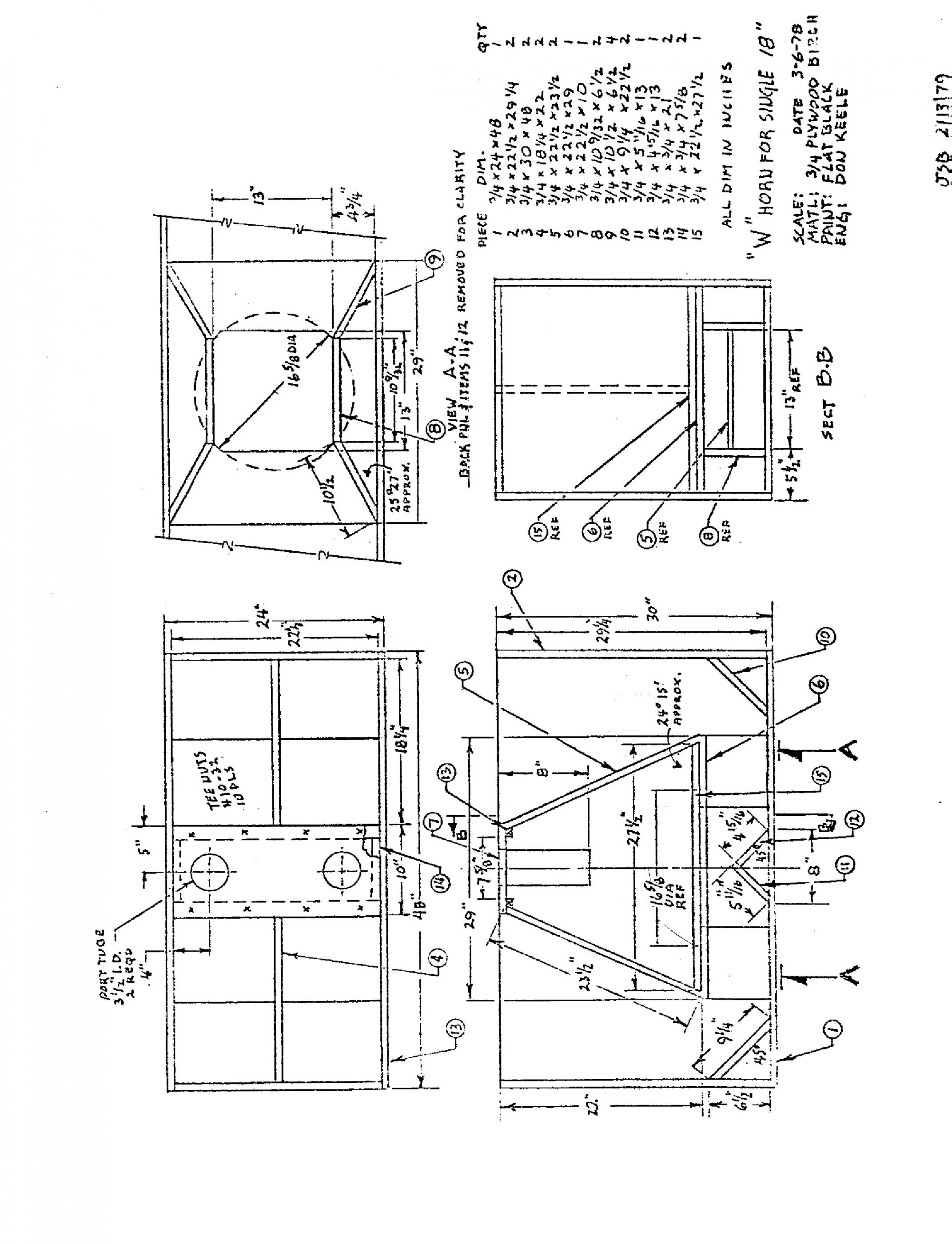

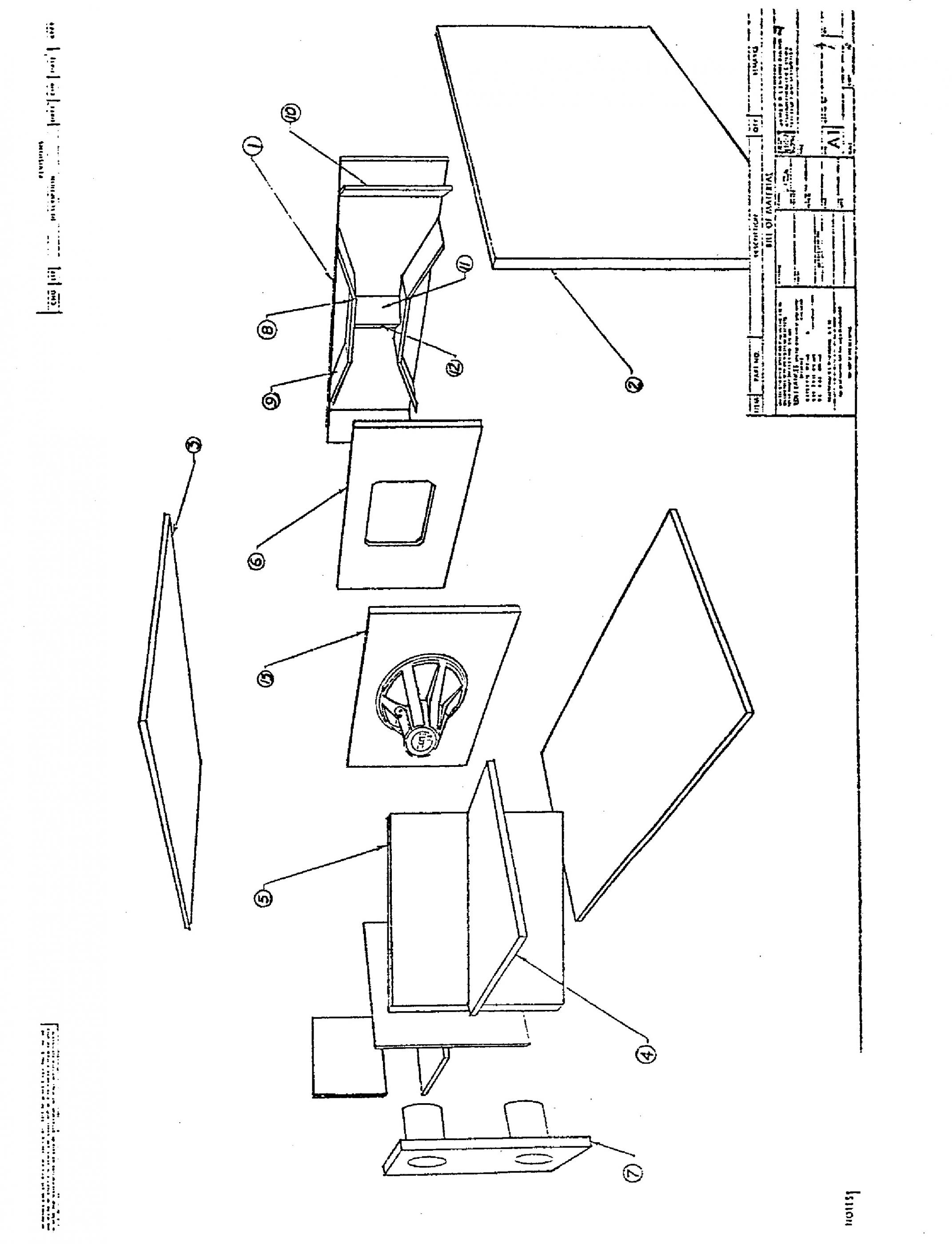

Keele April 25, 1977
K151 or 2240H "W” Horn
In answer to long-standing requests from dealers and end users, JBL is pleased to make available this plan for user construction of a "W"-format folded horn designed specifically for the JBL K151 18-inch loudspeaker.
The K151 "W"-box provides a 4dB sensitivity increase above 40Hz and a usable response from 32Hz to 400Hz. The horn mouth size of this enclosure is 1/8 of the size required for a full 40Hz horn. Hence, stacking 8 JBL “W”-boxes in a 4 x 2 configuration will provide true horn loading down to 40Hz.
These low frequency systems can be used as woofers in discotheques, bass guitar or organ pedal systems, or, when stacked in multiples, as the low end section of a three or four-way rock reinforcement system.
Because of the inherent midrange coloration of any "W”-horn design, the recommended crossover frequency is 300Hz or lower.
Construction Notes
These plans are designed for 3/4" high density fir plywood. All joints must be glued and secured with 1-1/4" #8 wood screws spaced every 5 inches. Although omitted from the plans for clarity, all butt joints require I" x I" glue blocks running the length of each joint in order to maintain structural rigidity. If the enclosure will be used in portable or road service, heavier bracing may be required.
All interior surfaces of the chamber in which the K151 is mounted (except for the baffle panel) should be lined with I" fiberglass. This may be attached to the walls with staples or glue.
Piece 7 is a removable panel which allows access to the chamber for mounting the K151. The shortest dimension of the opening covered by piece 7 must be no less than 7-5/8" so that the loudspeaker will fit into the chamber. Piece 7 should be secured to pieces 13 and 14 with at least 10 #10-32 screws and T-nuts. Foam tape or caulking installed around the perimeter of the access opening will maintain the required air seal.
The K151 is secured to piece 15 by eight screws and T-nuts. The T-nuts should be installed in piece 15 before it is assembled to piece 6. The K151 bolt hole circle is 17-3/8” and the T-nut should be installed at 45 º increments.
No provision for connecting the loudspeaker to an amplifier is shown. The builder should select the connection method most suitable for his system.

"W” Horn for K151 18" Driver.
A medium-throw "W” folded horn with vented-box rear air chamber for use with our K151 18” driver providing uniform response from 55 Hz to 400 Hz when used singly in half-space environment. Its folded configuration allows a full 4 ft. long 40 Hz flair-rate exponential horn to be packaged in a relatively compact enclosure. A 5 cu. ft. 35 Hz tuned vented-box rear air chamber provides useable response and full 150 watt power handling capacity down to 32 Hz. The horn is designed to be used in multiples (2 to 8 units) to provide flat response to below 40 Hz in environments where reflective surfaces are not available. A single unit can generate some 15 to 20 acoustic watts at full power input in the 60 to 400 Hz range with less than 3% harmonic distortion.
SPECIFICATIONS:
For single unit in Half-Space (single reflective surface).
Frequency Response:*
Axial SPL: 60 Hz to 1 K Hz 3dB
Power: 55 Hz to 400 Hz 3dB
*Both on axis and total acoustic power frequency responses are given for the system. The axial response gives the output under free-field or outdoor conditions (or the direct-field in a reverberant space) while the power response indicates what one should expect if the system is used in a reverberant indoor or enclosed space.
Sound Pressure Level:
(re 20 uPa, nominal impedance assumed)
at 1 m (3.3 ft), 1 watt input:
103 dB (Ave. 80 to 400 Hz)
at 1 m, full power (150 watts) input:
124 dB (Ave. 80 to 400 Hz)
Efficiency:
15% (Ave. 80 to 400 Hz)
Maximum Input Power:
(Nominal impedance assumed)
Continuous (narrow band or sinewave): 150 watts (above 32 Hz)
50 watts (below 32 Hz)
Instantaneous Peak:
1500 watts *
*Peaks 10 dB above stated continuous maximum power inputs are permissible as long as the true RMS power averaged over any one second interval remains within continuous limits.

PARTS LIST K 151 "W" BOX
ITEM DESCRIPTION DIM. (INCHES) QUANITY
1 Back 3/4 x 24 x 48 1
2 End 3/4 x 22 1/2 x 29 1/4 2
3 Side 3/4 x 30 x 48 2
4 Brace 1 3/4. x 18 1/4 x 22 2
5 Chamber Side 3/4 x 22 1/2 x 23 1/2 2
6 Baffle 1 3/4 x 22 1/2 x 29 1
7 Port Plate 3/4 x 22 1/2 x 10 1
8 Horn Plate 1 3/4 x 10 9/32 x 6 1/2 2
9 Horn Plate 2 3/4 x 10 1/2 x 6 1/2 4
10 Horn Plate 3 3/4 x 9 1/4 x 22 1/2 2
11 Horn Plate 4 3/4 x 5 11/16 x 13 1
12 Horn Plate 5 3/4 x 4 15/16 x 13 1
13 Brace 2 3/4 x 3/4 x 21 2
14 Brace 3 3/4 x 3/4 x 7 5/8 2
15 Baffle 2 3/4 x 22 1/2 x 27 1/2 1

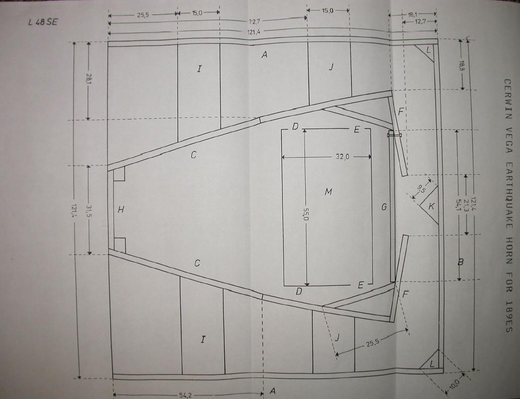

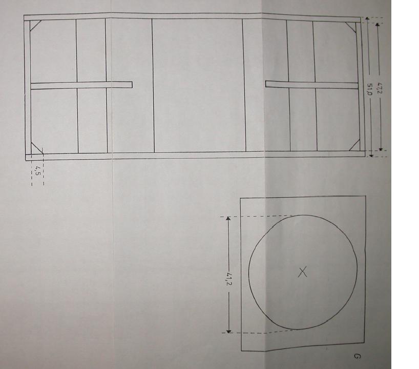

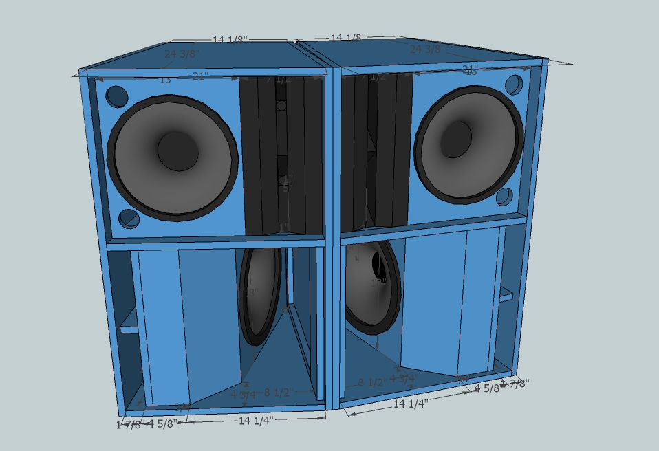

Good day to all,
Can any one send me a plan for the following BINS,
L36
w-bin(sub-zero)
sub scoop
Here's my email (urbanista2007@yahoo.com)
May i ask is TnT 18's speaker are suitable for these bins.
thanks in advance,
for L36 plan - please check this link http://forum.speakerplans.com/cerwin-vega-l36-pe_topic2217_page1.html
and, as they say it, "Google is our friend", please use google, image, enter keywords.
regards

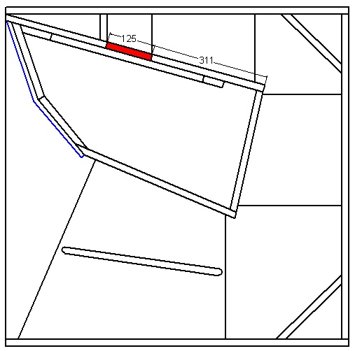

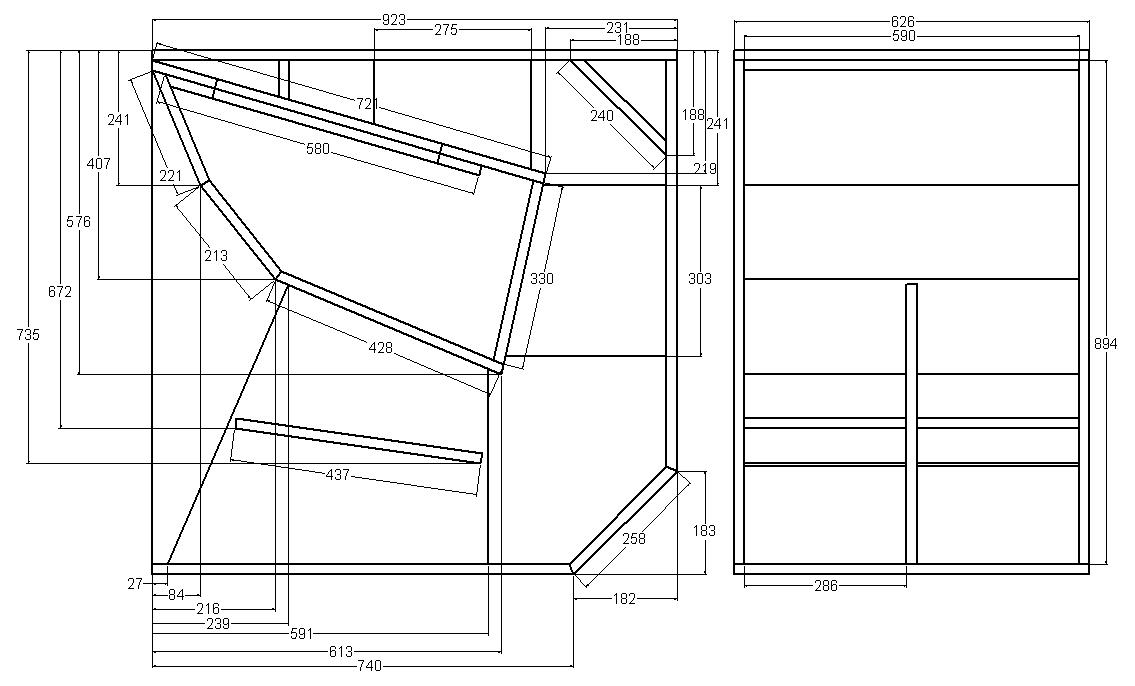

This the new version of XXX36XX...
take note that the original CV has an aluminum panel for cooling system.
Just another C-horn...DIY friendly easy to build.
For aluminum cover use a 1/4" gauge and ribbed with a 3/4" x 2" hardwood to support it from flexing.(we experience this when we built 4 for my clients install)
have a nice day
jojo
have a nice day
jojo
have a nice day

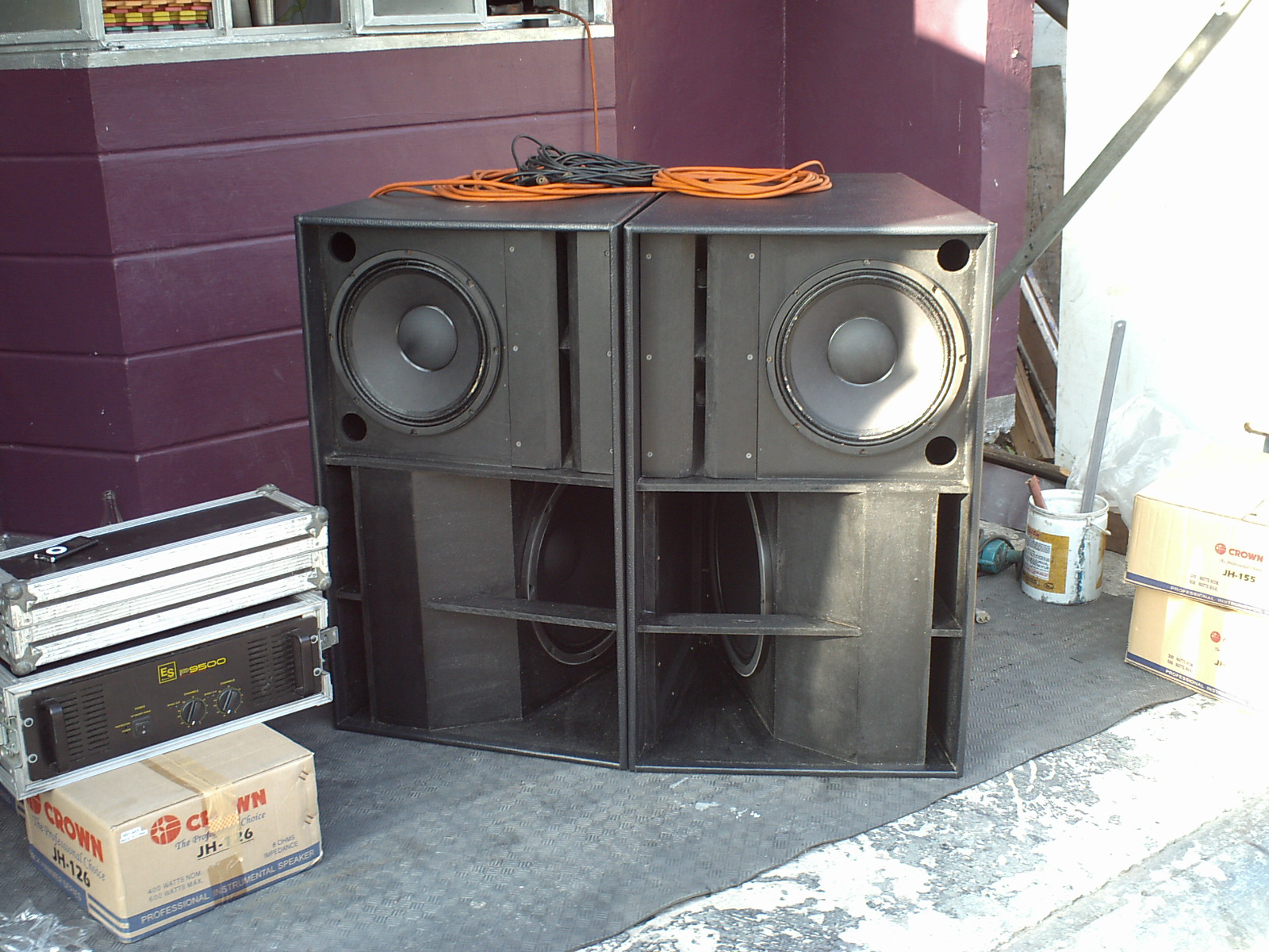

yup this looks the real thing. . . post #935
cheers!
http://www.diyaudio.com/forums/74642-konzert-amp-speakers-website-94.html#post2137261
courtesy of my friend. . .
