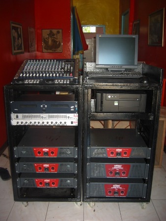

regarding my china made Crell Alpha 2000, well i could say that its fairly tough,
I run the amp with a two ohms load,
turn up the gain with no clipping,
the temperature was fairly hot but it didn't fail or fire-up, only my speakers were toasted. Voice coil were totally burnt.

I Have magus PO-800 power amplifier rated at 500watts @8ohms, 1000watts @4ohms. it used with the same power output C2500 and A1943. POwer supply rail used 100-0-100 +/- vdc . toroid transformer output 35-0-35, 35-0-35, 17-0-17. the orginal is KINMA PO-9330. i run it 2ohms load for mid range. for long run.

ok i will take some pictures on the internal of the amps. I have here but only the front view. post them later.
jayrjoe said:i've read the markings of the boards
in the PCB board for capacitors....
MA 10 or 1000 Watts 8 ohms = 100V, 10,000mf X 8
MA 14 0r 1300 Watts 8 ohms = 100V, 10, 000 mf X 12
same with the board were power transistors is soldered, maybe they are using the same PCB board for their high power one.
the voltage on the MAIN PCB per channel
HV = (+132volts 0 -132volts)
LV = ( +66volts 0 -66 volts
