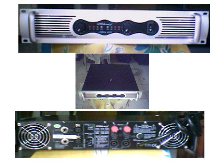

here's the pic of the amp mate.

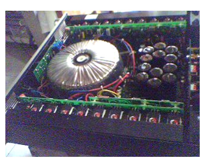

the toroidal transformer is quite big and the amp is quite heavy for its size, i will open later the amp to measure again other voltages.

Ok, I think I see what they are doing, silly me.
Your filter capacitors are rated at only 63 volts. What they are doing is using the center tap of each 43-0-43 volt winding to ensure that a stable "Center" voltage exists for the filter capacitors. Your filter capacitors are then in "Series" across the full 126 volt potential, running smack right at their voltage limit. Dangerous and bad for long life...
So that "120,000uF" of filtering is a 'spechmanship' joke. The total filtering is only 60,000uF effectively, 30,000uF per rail.

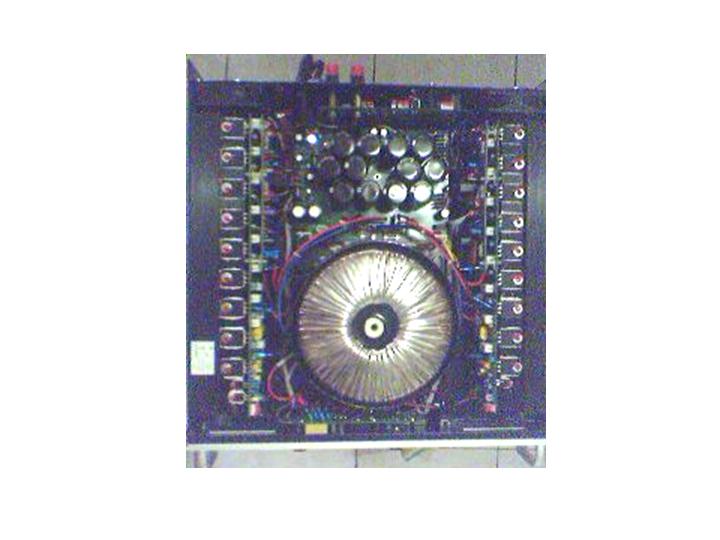

@the 1st secondary supply 43 - 0 - 43 volts(13A) = going to the capacitors...
then from the output connector of caps going to the main amp board +-126 volts ( left channel)
@the 2nd secondary supply 43 - 0- 43 volts(13A) = going also to the capacitors...
also from the output connector of caps going to the main amp board +- 126 volts (right chanel)

Seems it may be using a swinging power supply configuration to drive the speaker. The approach has various incarnations, including the one used by QSC...
Suggest 'leave it be' and don't demand too much power from it. As rlg suggested, maybe you can up the cooling fan a bit to get more air flow instead...
