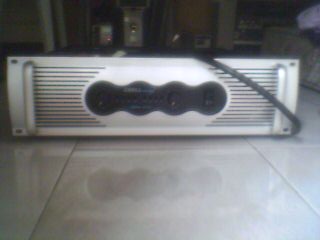

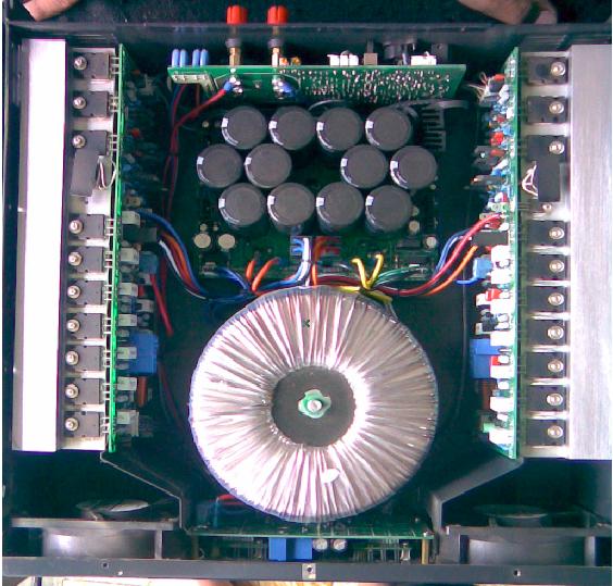

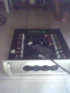

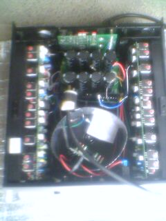

I opened my Crell alpha 2000 amp for general cleaning.
i have found out that it has exactly the same specs in terms of power rating compared to the SVENTA MA10 as posted in thier website, not sure though if they really have same circuits. or maybe they have, they only change the casing.

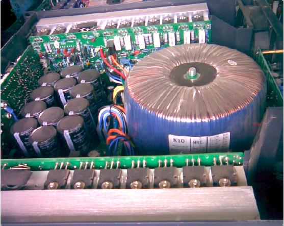

Comparing my K10 amp to my Crell alpha 2000, the K10 has a bigger toroidal compared to Crell. they almost have the same rating with my K10, (1000 watts 8 ohms per channel.) while the Crell is 1080 watts, 8 ohms)
i wonder why the Crell has a smaller transformer considering they almost have same rating with K10. from the manual the Crell alpha 2000 is a Class H topology not sure if this is really class H. any thoughts mate?

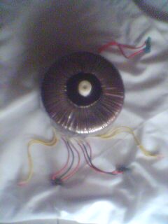

there is a sticker attached in the torroidal transformer of CRELL. these are the voltages.
@left channel
+ 51V 0 -51 V (14 A)
24 volts AC
@right channel
+ 51V 0 -51V (14 A)
24 volts AC
@left channel
24 volts AC
@right channel
+ 51V 0 -51V (14 A)
24 volts AC

CRELL ALPHA 2000

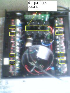

it has a total of 8 capacitors rated at 100Volts/ 10,000 uf. then
a total of 20 power transistors in each channel (10 pcs 2SC5200 and 10 pcs 2SC1943.) so a total of 40 power transistors on both channels.
i have noticed that in each channel it has a total of 8 vacant slots for power transistors, while a total 0f 4 vacant slots for capacitors.maybe for high power like the SVENTA MA14.

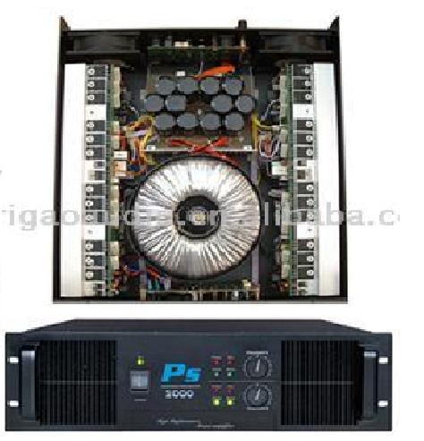

the ratings
1080W at 8 ohms
1500W at 4 ohms
2900 W at 8 ohms bridge
4350 W at 4 ohms bridge
this has the same rating from this amplifier (SVENTA MA10) distributed by KOLIN also.

I'm afraid they don't have any product support mate, your pretty much on your own. A hint if it is of a class H or G design, the collector (the center leg of 2SC5200 and 2SA194) of the output tranies would have different voltages (i.e. this bank of output transistor has a rail of 70V while the other bank has 140V and the emitter of the tranies that has the higher voltage is connected to the collector of the tranies that has the lower voltage).

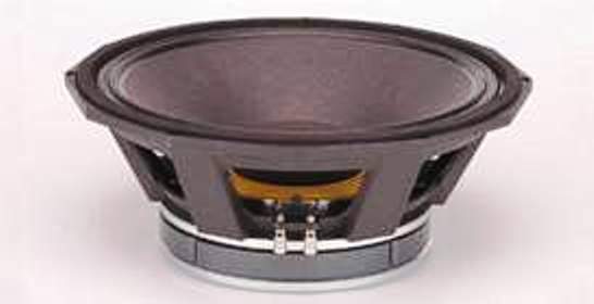

also the T&T drivers has a BL of 29 which pretty high, good for medium to long throw horn subs. T&T has almost the same BL with the speaker below.
the 18 inch PD 1850 (precision devices speaker) is very expensive, 2 years back, I ask one dealer there in manila, it costs 40 thousand pesos per one speaker i forgot the name of the dealer. I was shock with the price, anyway its made in england and believe to be one of the strongest and the finest speaker in the world. i dont know for now if they are still the best.

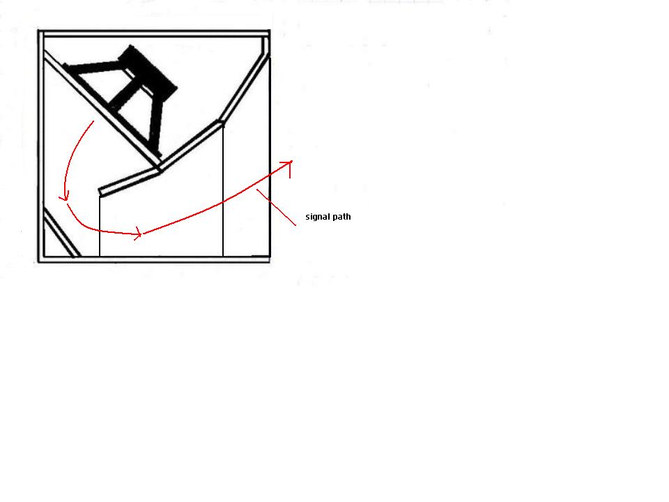

its is actually half of the USB mate, but put some angles on it and increase the volume of the sealed chamber a little. if using the original plan of USB, the T&T wud sound very hard and very tight bass. where did u buy your soundstandard CA20 mate? at forerunner? maybe by 3rd week of december i will be thre in manila to buy new pro amp. I miss the crowd there, before when I was assigned in makati, i used to window shop in RAON. they have a lot of amplifiers there before, uso pa noun ang sakura karaoke amplifiers and also konzert karaoke. maybe they have a lot of pro amps there now. it was in 2001 to 2002 that i was thre.
