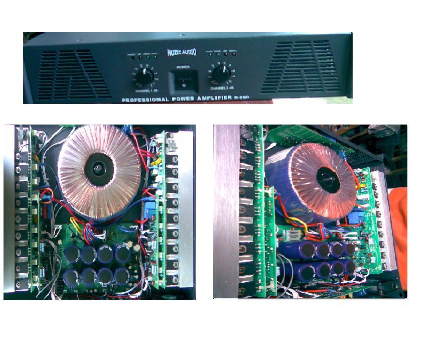

hi. my amp. trip. when run in 2ohms unclip. i can music audio m650. same circuit with konzert k6. but in the manual can run in 2ohms? and overheat. even fan at hi speed mode...
please don't believe those manuals, and i certainly would not push these amp on a 2 ohm load especially on a live sound situation, conservatism is the key to a trouble free operation, whenever i purchase a china amp i will open the lid, disassemble the output module, check the heat sink for flatness, polish it to a mirror like finish,
the holes of the mounting screws of the output transistor were check for burrs, then replace all the mica insulator with a thinner one ( they are to thick for me) then put thermal compound lavishly on every output tranies then mount & tighten everything to spec ( the output tranies) and whenever possible i would move the thermal switch to the far end of the heat sink (not near the fan) these amp got only a dc detect, VI limiter and a thermal switch for protection, unlike hi end professional amplifiers they got elaborate protection ckt base on the SOA of the output tranies. (odep, output averaging, igm, powerlock, ddt etc.) and sometimes they fail also to protect the amp

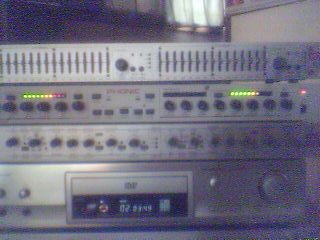

hi audiomachine, how you doin? still in audio biz? I badly need your expertise , hope u could spare me those.... I mean i have a problem with my phonic PCL 3200. I have noticed that the output signal is not balance.( comparing left & right) The left channel is much louder compare to the right channel, basing on the blinking of the led indicator. the gain of the right and left is set to zero as well as the attack, the release etc are the same settings.
Is there any way for me to make it balance? I opened it already, i have noticed that it has a total of 4 on board trimmers.( three legs) I have no idea on the adjustments of each trimmers, maybe i could adjust some of those to make the output balance.

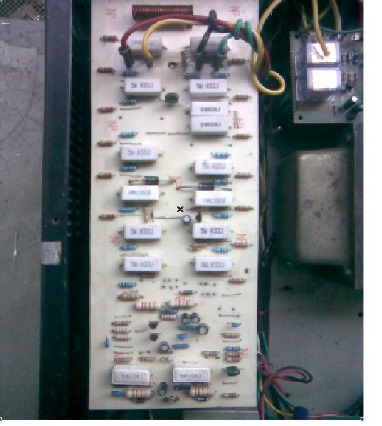

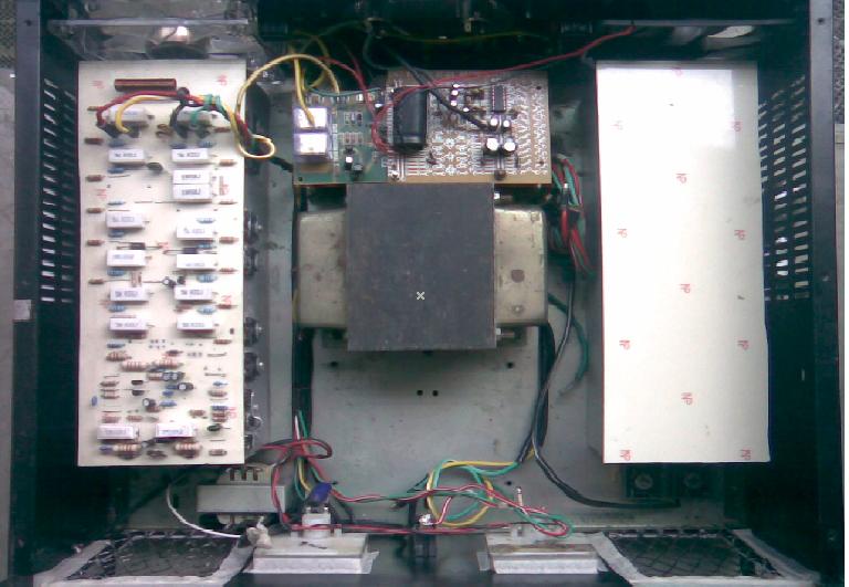

hi mate, im sorry i have no schematics of my amp, i am just curious if i could add transistors and capacitors, maybe some experts here could share some of thier knowledge. I noticed that there are some vacant slots for the tranies and capacitors. I visited the kolin website, the specs of my CRELL ALPHA 2000 is exactly the same with SVENTA MA10. maybe the vacant slots is for the high power which is SVENTA MA14.
I really want to upgrade the amp to high power without buying new One.
did you have the stereo link engage? try feeding the comp with a mono signal (with a y-cord) and set "ALL" the controls of both channels in identical position and observe the level meter (the meter can be switch to measure rms or peak reading, it can be also assigned to monitor the input or output) please don't touch the trimmers yet.

ive tried it before mate, when I switch ON the the strereo link the output is balance. let say left channel blinking at + 2db and right channel also at +2db.
Now I rechecked the settings of threshold, gain, peak / rms of the left and right channel, they are exacly identical, run both channels but still the same. Looking on the output dispaly led, let say left channel blinking at +3db already but right channel is only at 0 db, based on that, the left channel is +3db louder than right channel.
what i did to make it balance, I increase the output gain of the right channel but seems its not the normal way.
check also the sensitivity switch at the back if they are in the same position, if you want to adjust the trimmer please mark the position with a marker pen so that you can go back at the original setting. mine has all the trimmer set at their mid point (mark 503 = 50K) SVR2, SVR1 left ch, SVR4,SV3 right ch, the trimmers are for matching the gain of the op amp. hope this helps
yes i set the sensitivity at the back at +4 db.
do they have they same value mate? from SVR1 to SVR4 ?
Ive noticed also that they are all set to its midpoint. can u please take the readings of SVR1 to SVR4, so that i could compare here.

here are my measurements using a fluke dvm:
(from left leg to the wiper contact of the trimpot, with the front panel of the compressor facing you)
SVR2-10Kohms
SVR1-15K
SVR4-10K
SVR3-16K
Voltage measured from left leg to the wiper contact of all trimmer 15V disregarding the polarity
hello audiomachine,
it was found out that the trimpot settings of the right channel was set incorrectly based on the readings that u've sent to me. left channel value readings oK. ive tried it a while ago and YES the output is now balance on both channels. Now i change my mind, i'll keep it instead of selling it.
