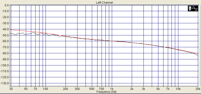

The one I have shown on the picture (post 68 page 3) has no input cap and a naked Dynavector DV6/10x silver step up inside. No problems. For MM I don't know, it never played with one. It never played with SS amps either.
I have investigated deeper what goes on with the RIAA curve and input cap for this cascode phono. My new card has also a high Z input that I measured for 1.18 MegOhm. So the loading does not affect the non buffered Bench. I think that Sheldon uses a buffer stage?
The answer for why I kept on tweaking its Riaa emerged. Whatever we do, its gain drops below 100hZ gradually. Either MM or with MC step up, the loss is about 6dB @ 50Hz. With input cap and one Meg grid to ground as per original, it only gains 1.5dB VS 47-68k Rload - grid to ground and no cap. Off course the cap there impairs the resolution and still nowhere rectifies the situation. The posted picture shows it versus red ref Riaa with 8n2 C1/C9. The absolutely right HF is with 6n8, but it deviates in upper mid. Alas, without proper bass level, it sounds and measures tipped up with any cartridge. By drooping the highs, enough subjective balance is restored from 8n2 to 11n4 range DEPENDING on the speaker - room interface.
