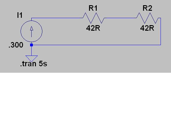

So what I suggested was to configure each 12AY7 for 6.3V and make a 317 300mA CCS to feed them in series. Then make a 365mA 317 CCS to feed the two ECC88 in series.
12AY7 300mA @ 6.3V both sections. Common heater.
ECC88 365mA @ 6.3V both sections. Common heater.

As you can see on the above simulations, when nominal current runs through the 6.3V configured heaters, each one develops 6.3V across. One sits on top of another 6.3V. So the upper point measures 12.6V respective to ground. It floats. If you run 600mA, they will go 12.6V each, will burn bright and die soon.

No, I assume a 12V secondary, rectified and filtered with a large electrolytic. There can't exist 6.3V or 12.6V CCS. There is a 300mA and a 365mA CCS, powered by that supply. If you run through a parallel 12AY7 heater 300mA by force, it will develop 6.3V when it heats up well. If you string beneath it another one, still the same current passes to ground and it develops 6.3V across too. Now if you measure from top valve's heater to ground, it will be 12.6V total.

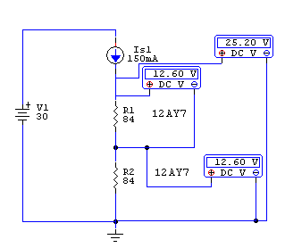

As you can see in my examples higher on this page, you must specify the current at 0.3A and then feed one valve up on another in series. At their top they gonna reach 12.6V to ground, but 6.3V across each one. So if you feed the LM317V with 16Vin or 20Vin the margin down to 12.6V is more than adequate for it to work. Better with 18-20Vin. The 317 will heat for (Vin-Vout)*I. 1W for 16Vin, 2.22W for 20Vin. Better sink it anyway, so no worries. If this thing is puzzling, just use a couple of LM317s for 6.3V per channel, configured for voltage regulation as common. Make your phono, solve some more pressing issues maybe, and later you can experiment with Isource heaters, so you can appreciate it subjectively or not when you will be familiar enough IMHO.

I think Kofi's got it here...
So, one current source for the two 12AY7 heaters in series and another for the two 6DJ8s / 6N23P heaters in series. I'd need separate current sources as the current draw from the 12AY7 and the 6N23P would be a bit different.
I can change the current supply by altering the resistor in the current regulator, but 12.6V will develop across each filament per Ohms Law with only say a .3A current draw due to the series chaining of the two tubes' heaters (see attached-- the 42R resistor represent the tube filaments in series).
I guess I'd have to be mindful that I'd need to change the current source if I change tube types (i.e., ECC88s for 6N23Ps) as I believe there are some current differences between the so-called "equivalent" tubes.
Is this right?

I am afraid that you must configure each 12AY7 tube's heaters in parallel and tie each tube to another in series, because you will have headroom for only 12.6V total. With 0.3A that is. 6DJ8 will not allow any manipulation any way, pin 9 is screen.
Well, I could cut the current in half (.150A) and use the 12.6V here, right? I think that's what you meant, but I'm just checking.
