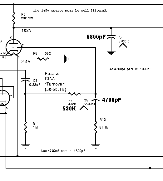

Not bad. Better make that 6500pF in to an 6800pF. In case the 5700pF original turns out giving too much HF as in my case.

Vlagua: Nice circuit.
Kofi: Today I had done a long tuning session on the Bench, measuring and listening against my other DIY and a very high dollar commercial phono. In case you will find the sound with original values questionable, keep in mind the values attached.

I'll order the original caps / RIAA resistor and the values you recommended as well. I can do a quick swap during listening tests to see which works better.
