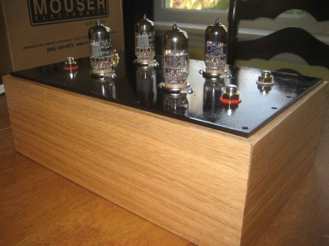

Honestly, it ain't that nice. It's pretty utilitarian, in fact. Red oak and aluminum spray painted with black appliance epoxy paint, which hides all mistakes. Tung oil on the wood.

Simple does not mean it ain't nice. Me I like it. Still 8n2 I use for that c1/c9 Riaa capacitor btw.
Good to note. I have a cavalcade of different caps so I can mix and match.

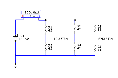

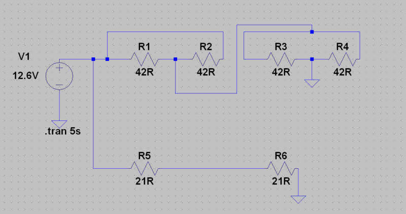

OK-- so I have been reviewing the filament wiring issue and since Jack wound me a transformer with only 1A of current availability I think I have to go with the series / parallel configuration to reduce the overall current draw on the transformer.
With the attached configuration, I believe the total current draw for the filament windings will be about 600mA, which is below the current peak for my iron.
Take a look at my guess at the filament winding configuration and please let me know if you agree.

I just confirmed real-world do-ability from the regulated PSU side. The filament supply is working. I ran it across a 21R resistor and I was able to get 12.6 steady DC volts.
Phase I Status: --COMPLETE--
