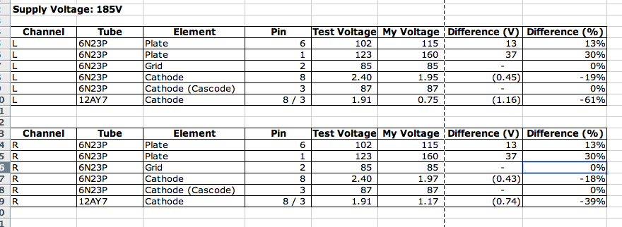

Kofi Annan said:
6N23P Plate [Pin 1]: 140V (Channel 1) / 160V (Channel 2)
6N23P Plate [Pin 2]: 120V (Channel 1) / 120V (Channel 2)
You need to measure a few more things. Ohms law is very helpful at this stage.
Regarding the 6N23P: For pin 1, I assume we are talking about the top tube of the cascode (cathode in series with AY7). The 140V reading seems reasonable. My supply is 210V, and I get 142V at that plate (6922, but yours should still be close). Yes, 160 is too high (maybe not too high, but the channels should match better than that). Check the voltage at the grid for that section. Check the voltage across the cathode resistor for the AY7.
Check the voltage across the cathode resistor for the grounded cathode section (second 6N section). IR there should match IR for the plate resistor. Plate at 120V should be OK.

Here's a screen grab of a spreadsheet listing the voltages for my circuit. The supply is at the 185V referenced in the original schematic, but I'm seeing some strangeness...
I have some issues with the 6N23P plate at pin one in both channels now-- it should be 123V and I'm seeing 160V. Also, the cathode voltage at the 12AY7s is a bit low.
I'm still investigating, but I thought I'd post my test results for your review. If anything obvious is sticking out here, please let me know. I'll be checking resistances next.
