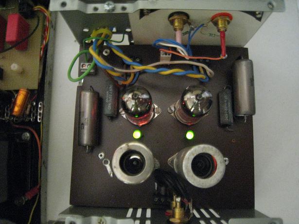

I attach a photo of HV shunt regulator.
Joe A
