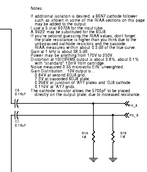

Thanks both of you Salas and Sheldon for the interesting discussion of Zo for this preamp. I still have to digest much of what you have said by referring to some of the literature I have on the subject. From a practical viewpoint it seems I have the following options:
1. Increase the o/p coupling caps (C6-C7) to 1-2.2uF;
2. Bypass the cathode resistor of the last stage (R5-R21) with a 22nF cap;
3. Add a buffer amp.
Is this correct? With these changes, I'm aware each option has its own set of characteristics/problems. With opt 1 Salas says "1uF is kinda OK for 50K and cutting rumble on phono, still night and day VS 0.15uF to 50K". What do you mean here?
Option2 is said (by Sheldon) to increase distortion in the long term due to instability of Rp. We'll have to see how significant this will be.
A buffer means another project and adding another link in the chain. Any quick fix suggestion for a v-t or SS buffer? Sheldon I had a look at your version of the SB preamp, but your last stage (ECC88 srpp) doesn't look to me like a buffer, or am I missing/mixing something/s?
Thanks again for your great contributions on this forum (together with some others as well).
Cheers.

For option 2. Sheldon meant you change C1,C9 to 22nF if you bypass 562Rk with an electrolytic (I would use 470uF/16V), so the HF of the Riaa remains OK with new 3K3 Zo. But SB already gives enough THD as it is in his comments, that will rise, the gain will take another 12dB also, and I don't know about total noise. What about changing the Log pot in the C-J to 100K? If its possible, then no changes beyond higher couplers, just 1uF output capacitors will be plenty.
*My phrase meant that 1uF is much better than 0.15uF for 50K line input, and rather enough. Because it will cut enough infrasonic that turntables produce, maybe a good compromise.

You have a fourth option, which I noted earlier (and which is the easiest to implement). That is, use a CCS load instead of an anode resistor for your final stage, and take the output from the top of the source resistor. http://pimmlabs.com/web/Active_loads_and_signal_current_control.html This will give you a low output impedance. If you can't change the pot on your pre amp, I would recommend this one. A fifth option, if your power supply has some current reserve, is to add a source follower stage as a buffer. I can draw these up later for you, with part values.
Option 2 will increase the distortion, because the unbypassed cathode resistor acts as a type of internal feedback to reduce distortion. Drift is a separate issue, and will cause your response curve to drift over time. If one channel drifts relative to the other, it will affect the imaging.

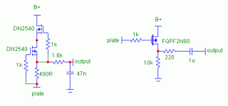

Values for CCS: This is the easiest approach. Take a look at the depletion mode CCS cascode in the link above. You will adjust R to set the current. Measure the current across the anode resistor for the second stage of your phono amp to get this value. If you use DN2540, this will be about 400R for 5mA. You can use a trim pot here for set up, and replace it with a fixed resistor. If you do this, then just measure the voltage at the tube plate and adjust in situ. There are some refinements we can discuss if you choose the CCS.
No gate stopper is shown for the upper device, but you should use about a 1k resistor for this. BTW, you can use a small JFET for the lower device, and this will improve performance, as the capacitance will be lower. It will only see a few volts, so only the upper device needs to have a high voltage rating. The R will be different, according to the device chosen.
Values for Source Follower: See the first diagram in this link for the general schematic:http://www.geofex.com/Article_Folders/mosfet_folly/mosfetfolly.htm For this you can use something like the DN2540 (depletion mode device) or an enhancement mode Mosfet. I like the FQPF2N80 for it's low IDSS. You will want to run at least 5mA through this, and 10mA is better. Make sure your power supply can handle the extra load without a significant increase in ripple.
For this, the voltage at the gate will be the anode voltage of the Bench second stage, which is around 100V. Therefore the voltage at the source will be a few volts higher (for a depletion mode device) or a few volts lower (for enhancement mode). We will ignore that and call it 100 volts. So for 10mA you need a source resistor of 10k. Simple.
Sheldon
Sheldon

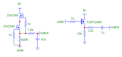

Here is an example of a CCS, connected as a mu follower. The series output resistor sets the output impedance of the stage. The cap to ground is the RIAA cap, set to the resistor (1.6k x 47nF = 75usec). The 400R resistor should be adjusted to that the current matches what you have across the 20k plate resistor, which it replaces. You could use a good quality 1k pot here too. I left off the coupling cap after the CCS, but you will need on the output. The minimum value will depend on the input impedance for the following preamp, but 1uF will cover most any.
The second circuit is a source follower. It's simpler, but will draw extra current from your B+ supply. The output impedance is set by the series output resistor (220 Ohms here, but this is not critical). Everything else stays the same before it, except the coupling cap, which is after the follower.. I would change the final RIAA resistor to about 7nF, instead of 5.6nF.
You can use IXYS 10M45 in the CCS, but the source resistor will need to be adjusted. Check the data sheet for an initial value.
You can use the IXYS or DN2540 for the source follower too, with no value changes. Other Mosfets than the one I show can also be used, but pick one with similar low Crss (reverse transfer capacitance).
Salas can pitch in with any comments too, as he knows circuit design better than I do.
Sheldon
Sheldon
Values for Source Follower: See the first diagram in this link for the general schematic: http://www.geofex.com/Article_Folders/mosfet_folly/mosfetfolly.htm For this you can use something like the DN2540 (depletion mode device) or an enhancement mode Mosfet. I like the FQPF2N80 for it's low IDSS. You will want to run at least 5mA through this, and 10mA is better. Make sure your power supply can handle the extra load without a significant increase in ripple.
Sheldon
Just to make sure I have understood you correctly, we have two options to achieve a similar result, i.e. to lower Zout - a CCS to replace the anode resistor or a Source Follower which basically adds a buffer stage to the SB preamp. From my viewpoint the SF is the simpler circuit to add on to the preamp circuit.
I think I will use the DN2540 which is more readily available. In that case does the 10K source resistor still apply?
On the implementation side, I will break the C1-C6 connection in SB's circuit, then connect the gate to C1 and connect C6 to the source. Is this correct?
Do you still think I should increase C6 from 0.15uF to say 1uF?
As regards my power supply I'm using Salas' shunt regulator and I believe the transformer is up to the task.
Thanks for your patience with my newbie questions.
Joe A
You've got it.
Yes.
Yes.
This depends on the input impedance of the following preamp. You'd like the roll off to occur below 10Hz. For 50k impedance, a 0.47u cap gives a -3dB point at about 7Hz. A 1uF cap would be fine here.
Sounds good. Check with Salas on adjusting the regulator current to account for the added load. As long as your transformer is up to it, and you can handle any extra heat, then this is the easiest solution. BTW, you don't have to take the power supply B+ for the source follower. You can take it before your regulator, because the follower has very good psrr.
Sheldon
