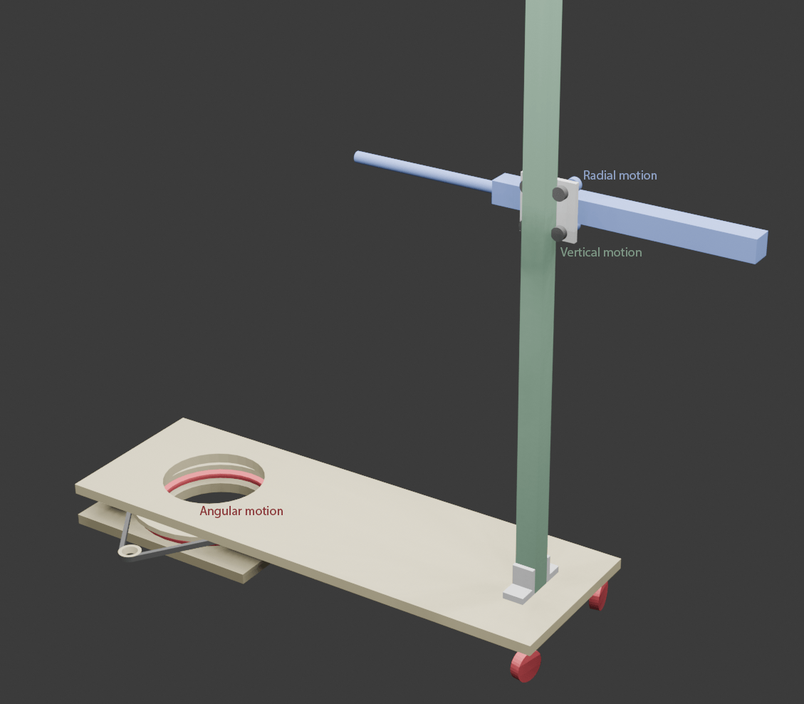

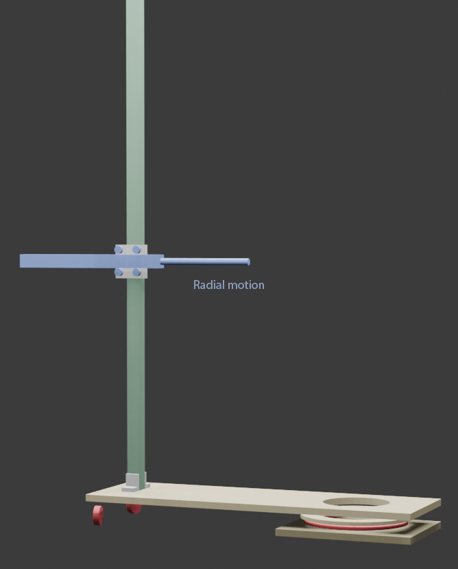

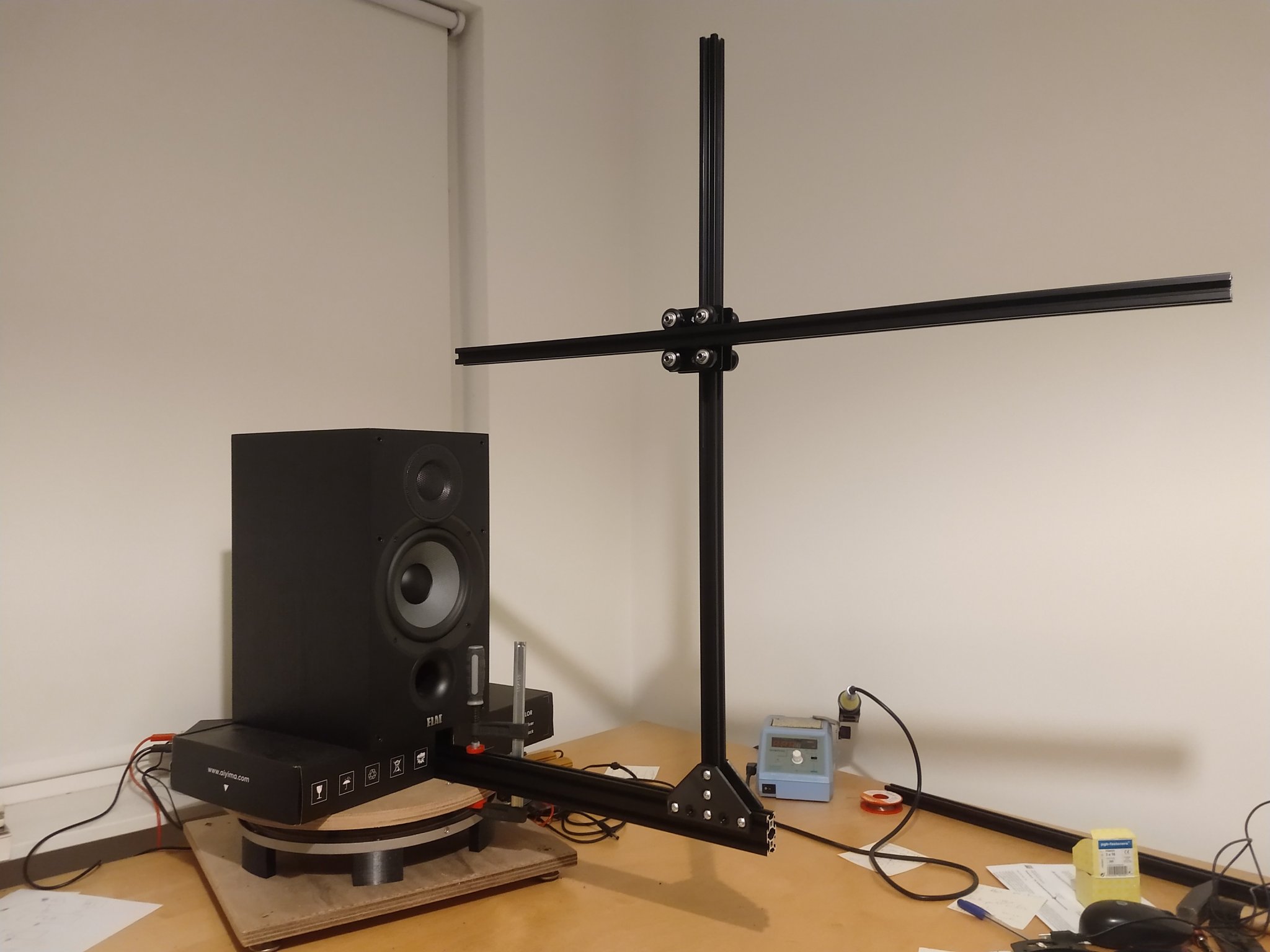

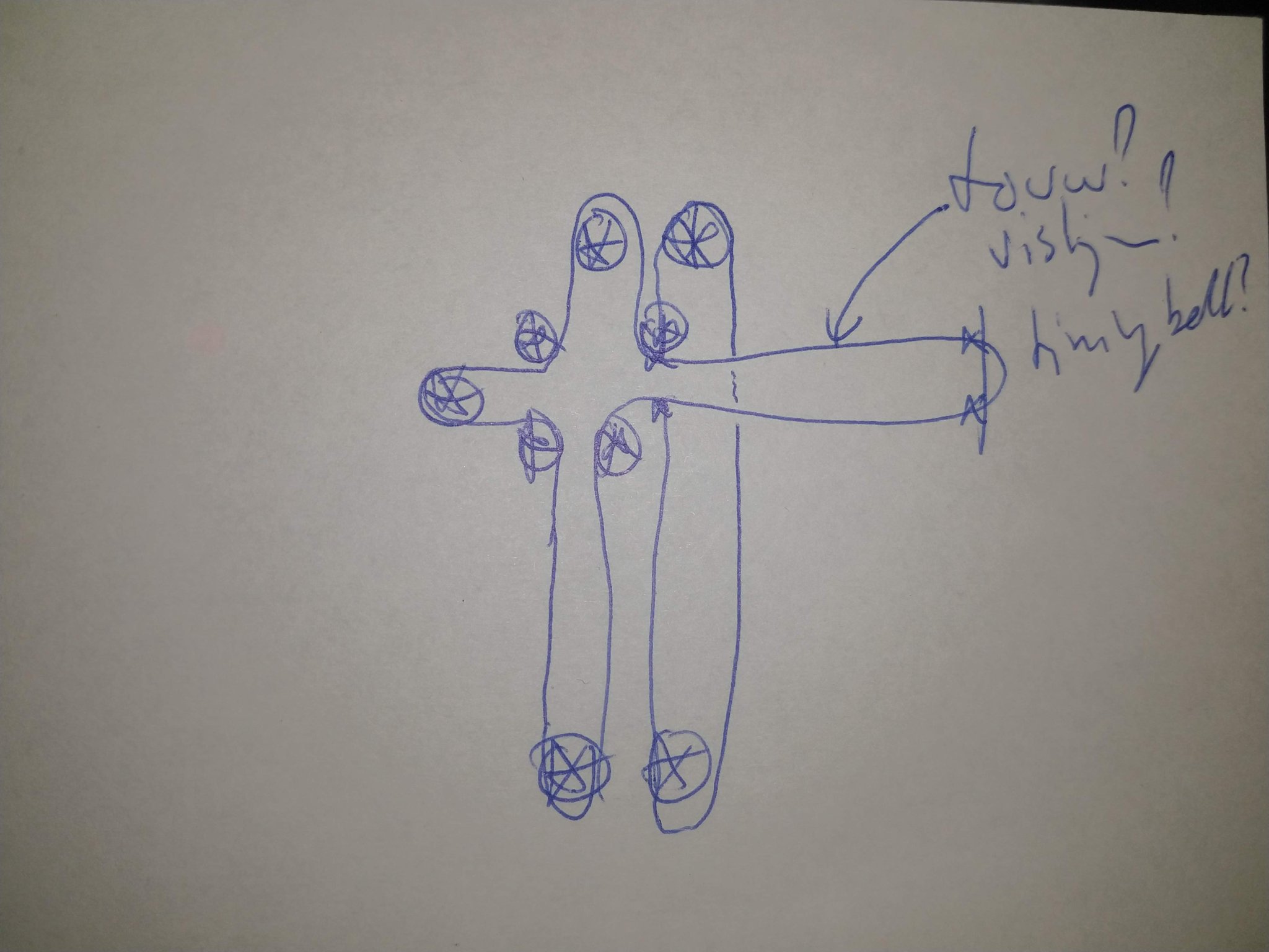

My first thoughts for the motion system might not have been that weird after all:
Definitely the same vibe. Pro would be that the motors are stationary.
Edit: It seems to be called T-Bot: https://www.buildlog.net/blog/2017/10/the-midtbot-a-new-flavor-of-h-bot/
I will look !My first thoughts for the motion system might not have been that weird after all:
Might be a great idea.

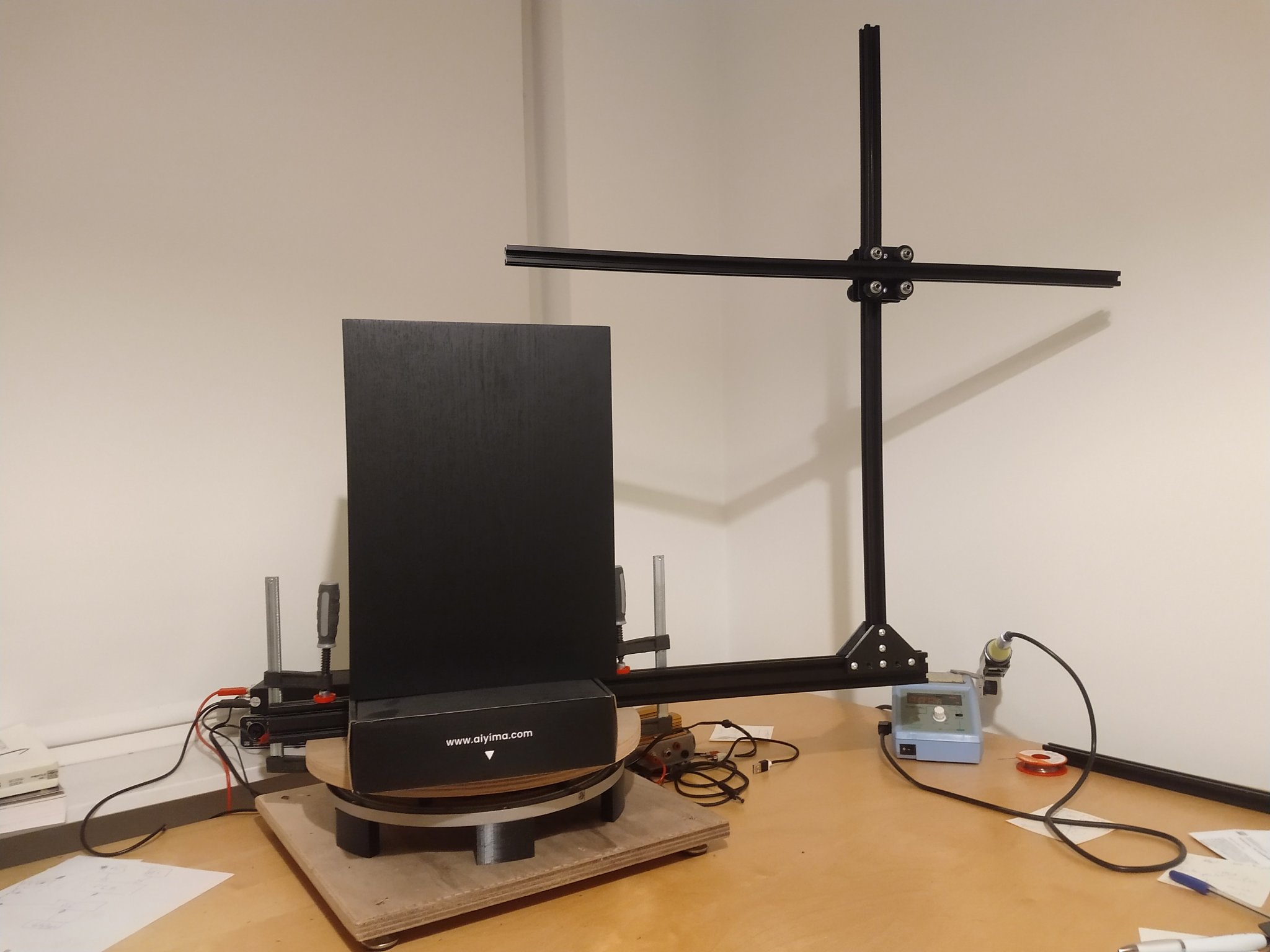

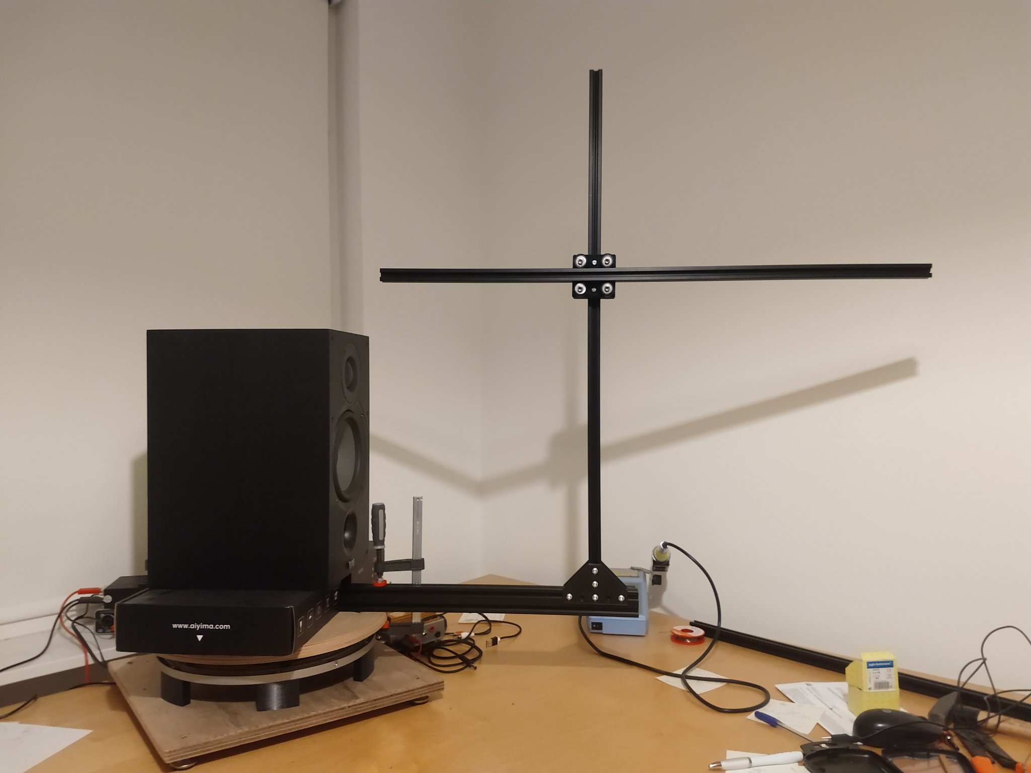

Table top NFS:
This was the easy part 🙂
Friction is keeping the horizontal arm where it is. Of course that will change with a microphone, but my guestimate is that the stepper should have no problem keeping that at the desired position.
The flexibility is a point of concern. I have an extra 2020 profile that I could add.
Now I will need quite some time to get it moving. The internal gear rack is probably the easiest solution. However, if we could keep the steppers on the turntable, the steppers are stationary (so no moving electrical wires) and the arm light.
Anyway, I will have to fight with Fusion, 3D print stuff and order things. But now I at least have something tangible to think about and look at.
Ps. Of course the speaker should not rotate.

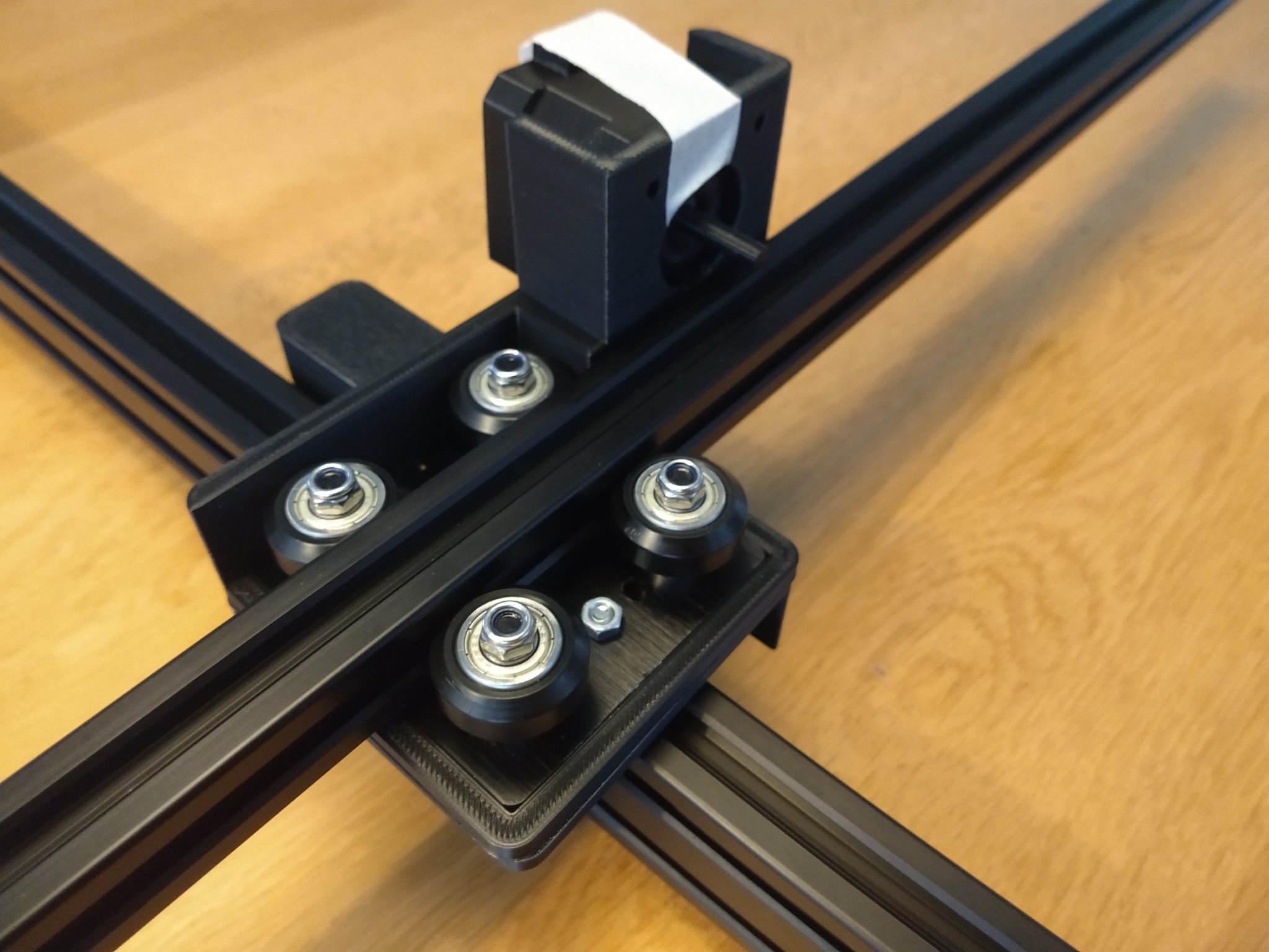

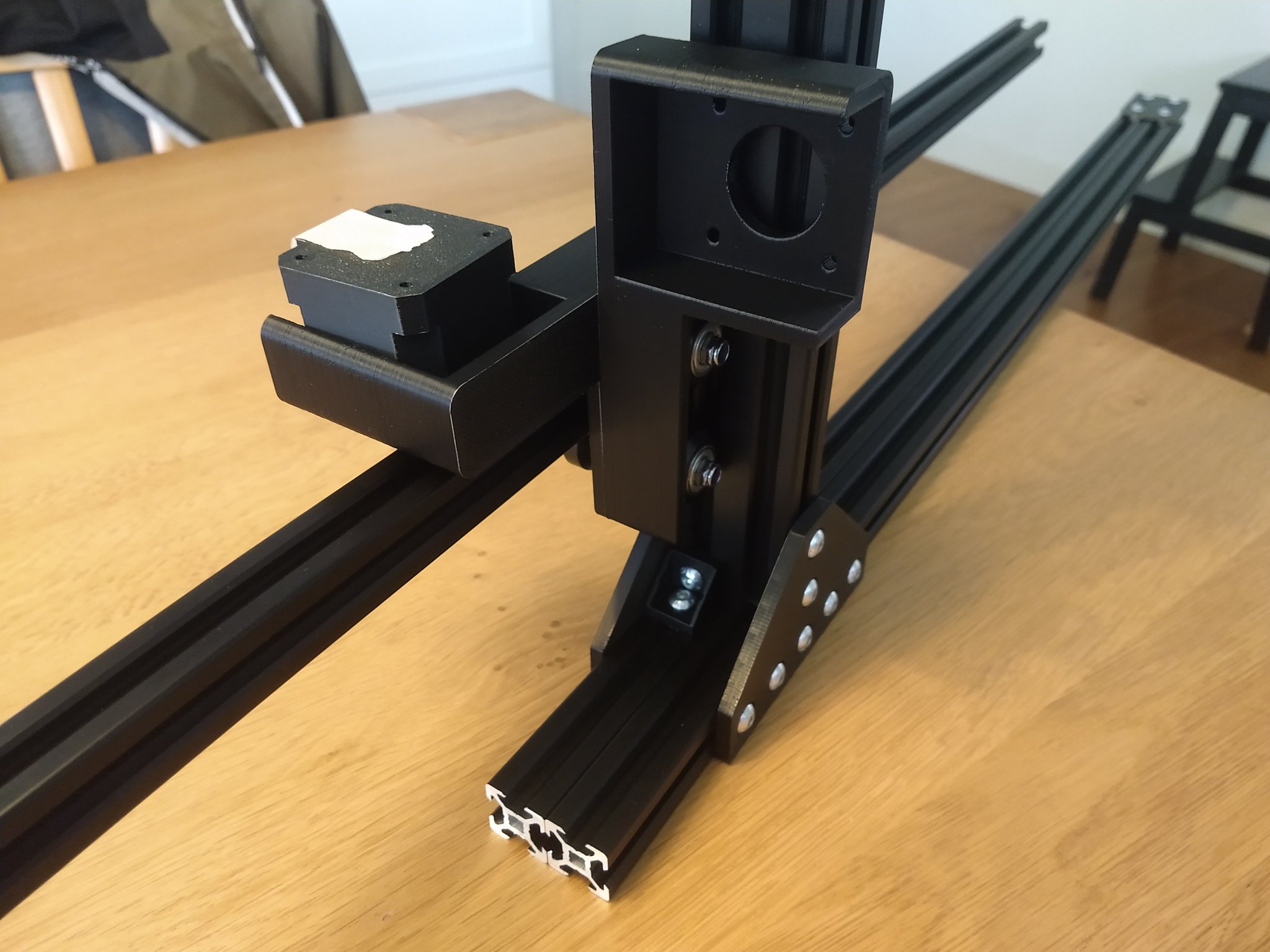

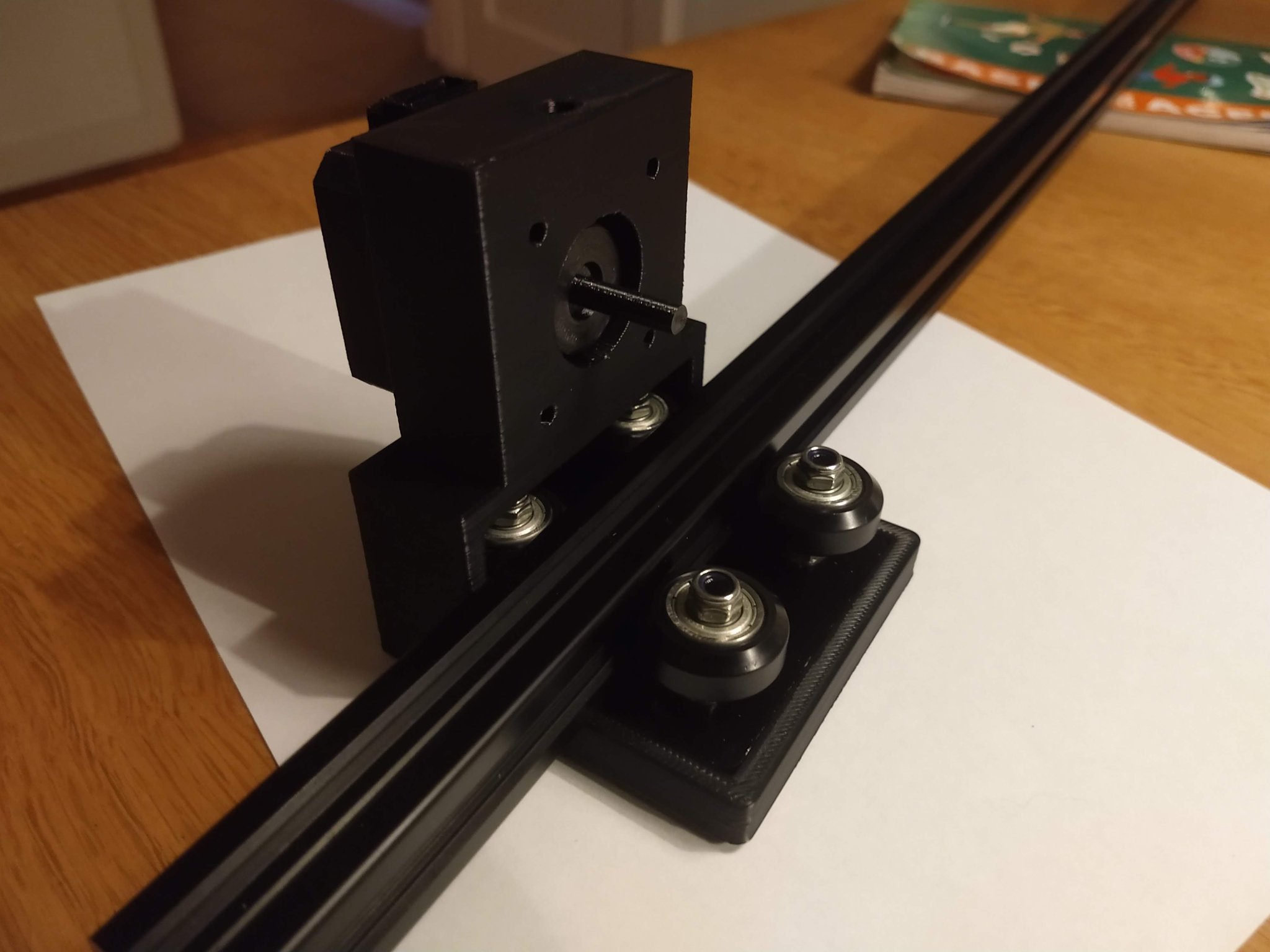

Just an update, nothing special:
Although I would love to make a belt driven motion system with the steppers and control box on the turntable, I'm too unfamiliar with CAD and the mechanics and where to source the materials, that I've chosen to go the direct drive route; at least for now 🙂

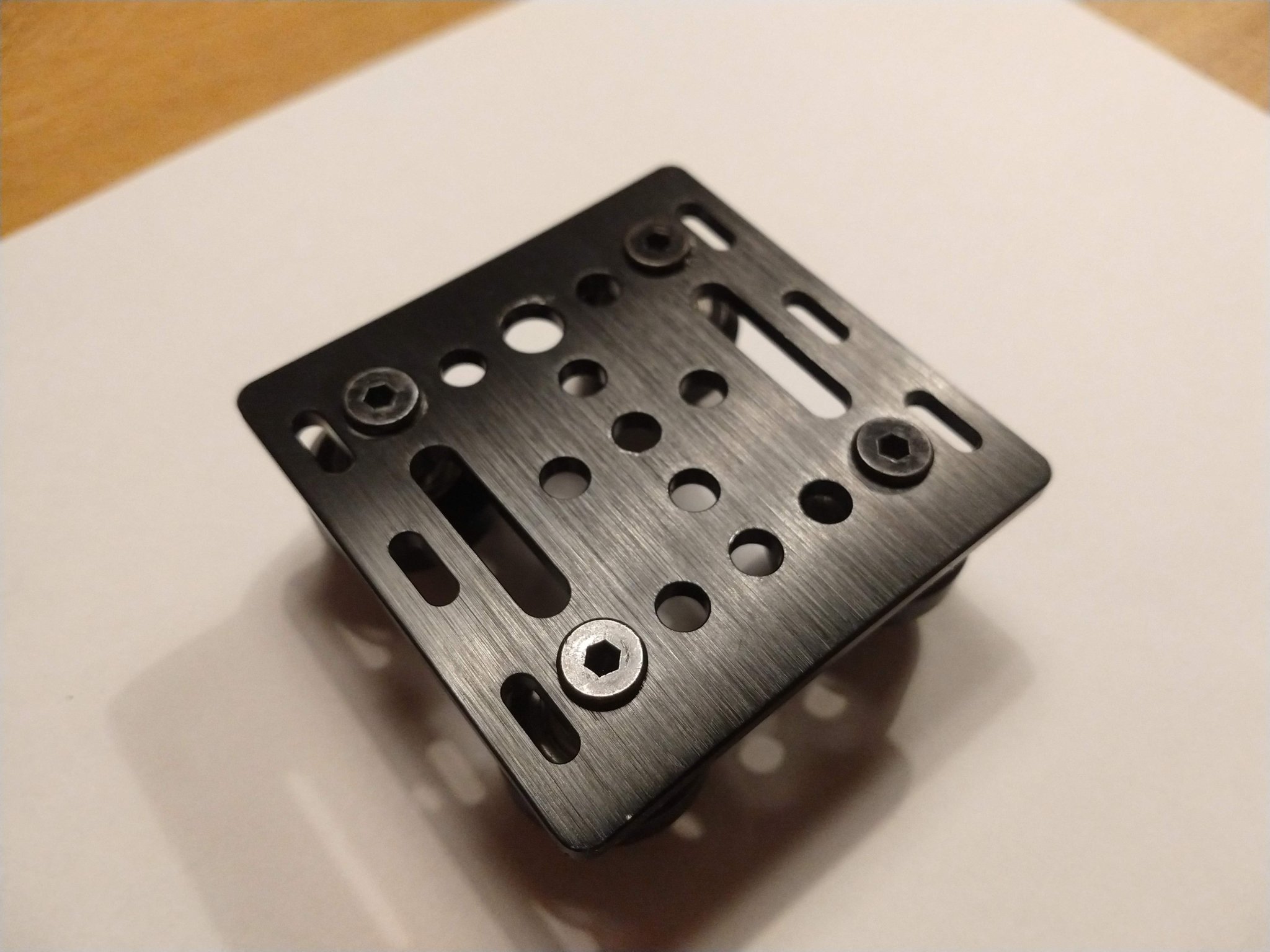

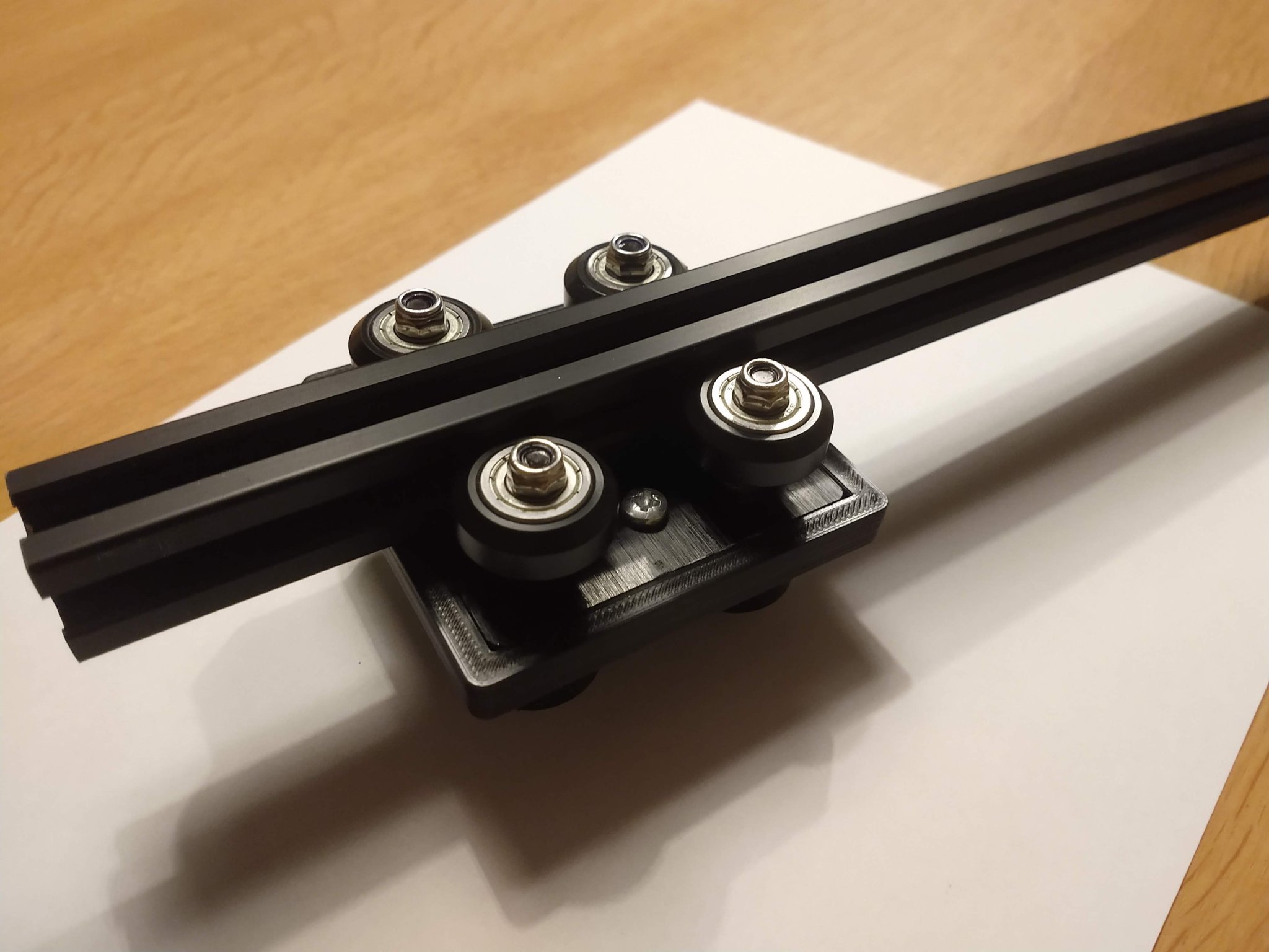

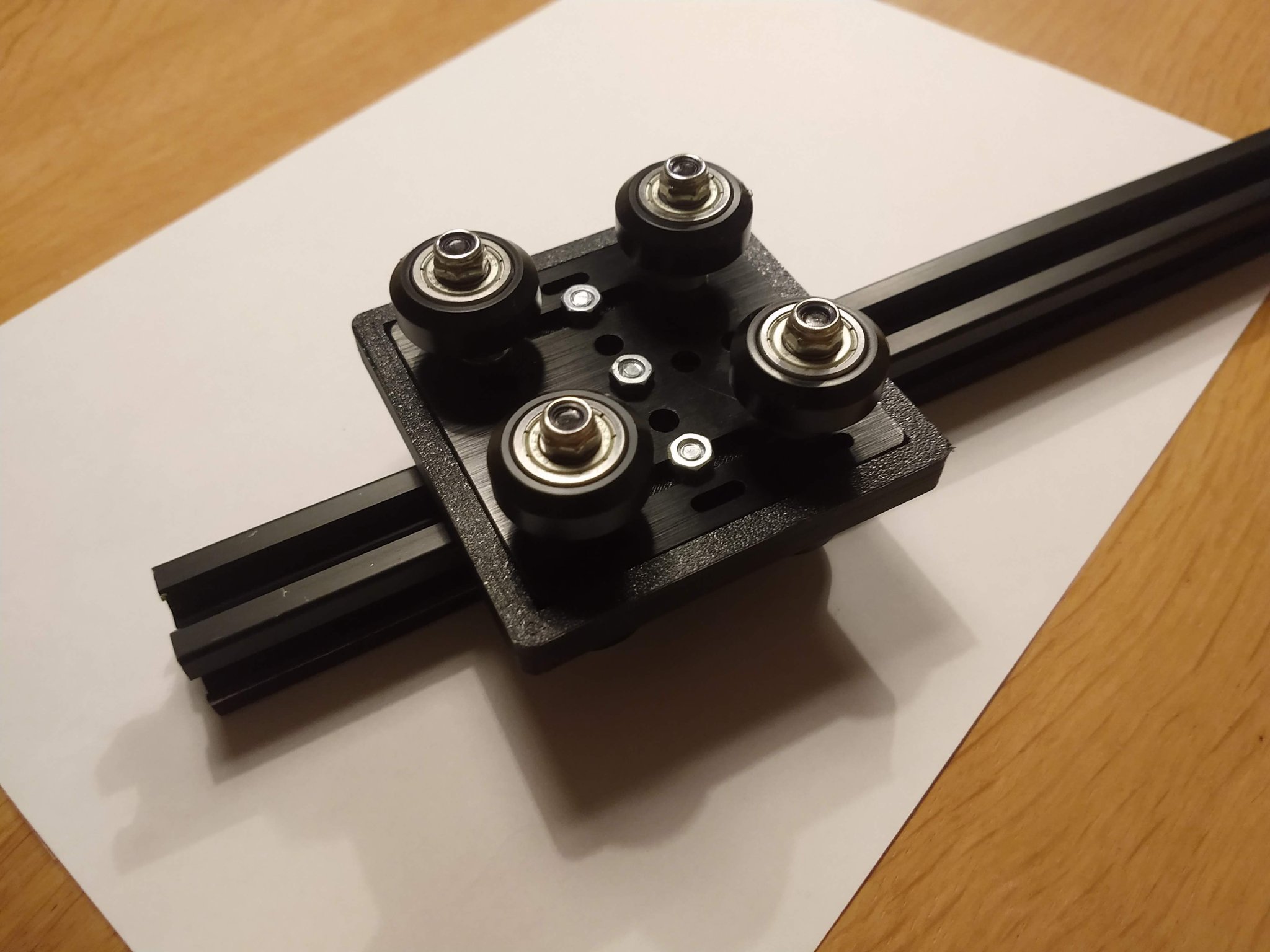

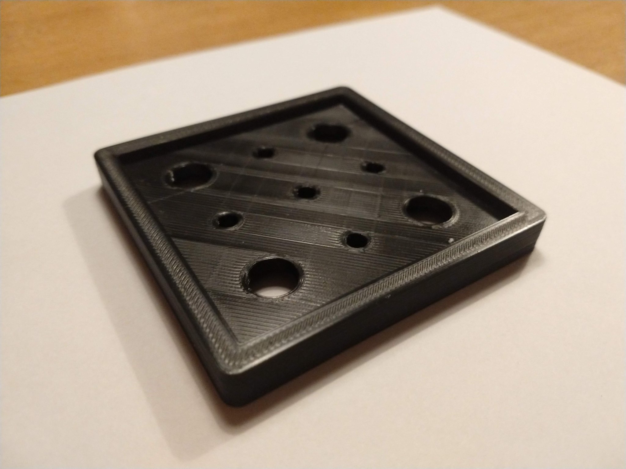

The wheels of the gantry plate are attached to the plate with screws. The heads are protruding a bit. We need to mount two of these gantry plates back to back and rotated 90 degrees. The plate below allows that:
Attached to (one) profile, that looks like this:

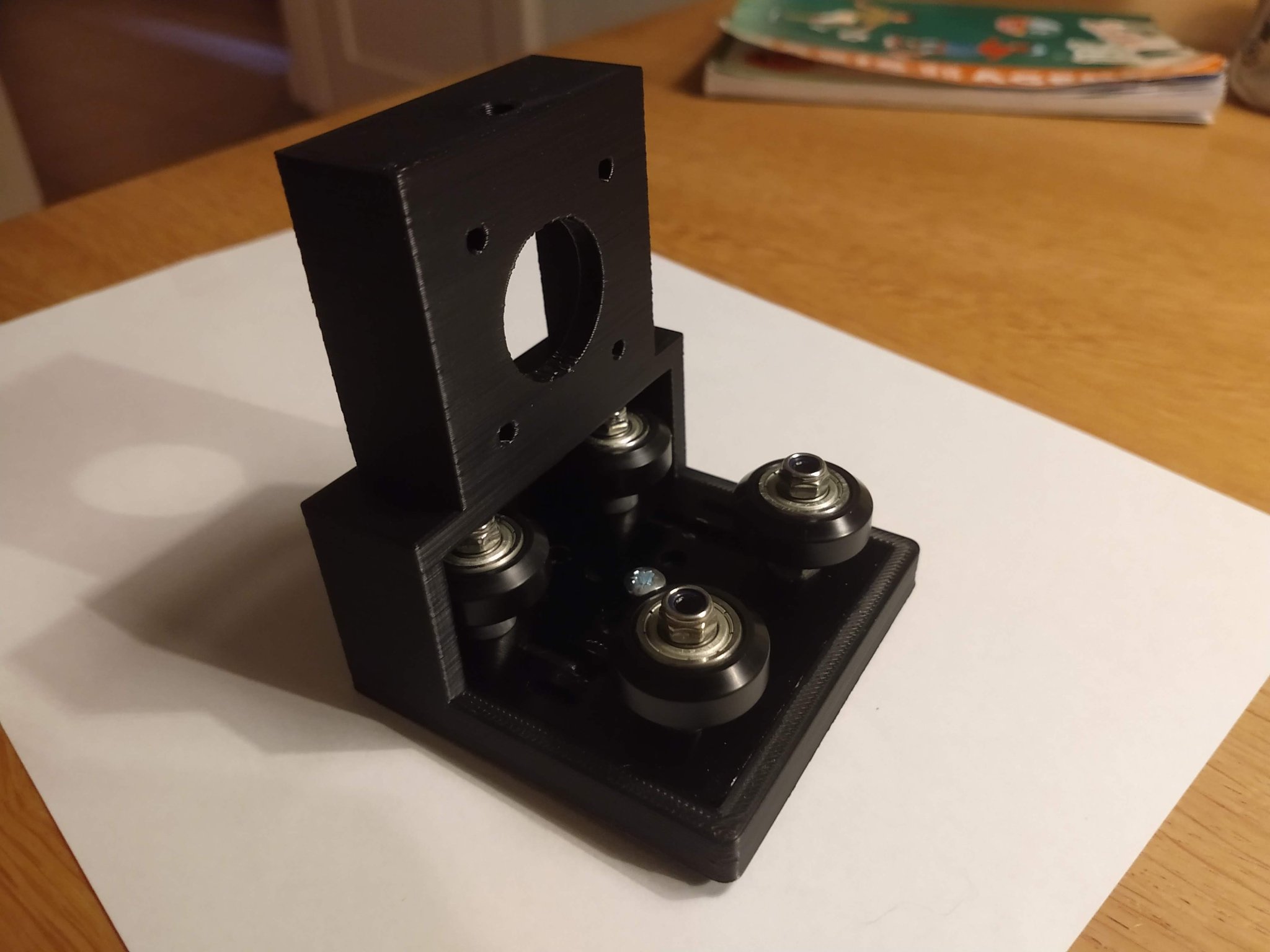

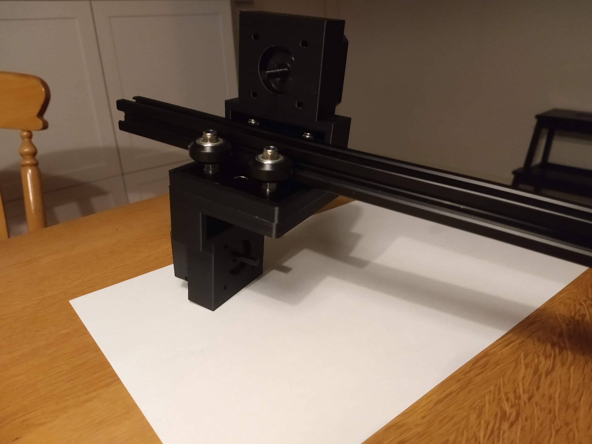

Now we need a mount for the stepper. Both steppers will be attached to the gantry plate combo. A (lucky) benefit is that all the mass is close to the vertical profile, so not much bending because of the steppers.
My CAD skills don't allow fancy shapes, so the stepper/gantry mounting piece a little boxy. Here is it with a single gantry plate attached:
And with a (3D printed) stepper model and profile it looks like this:

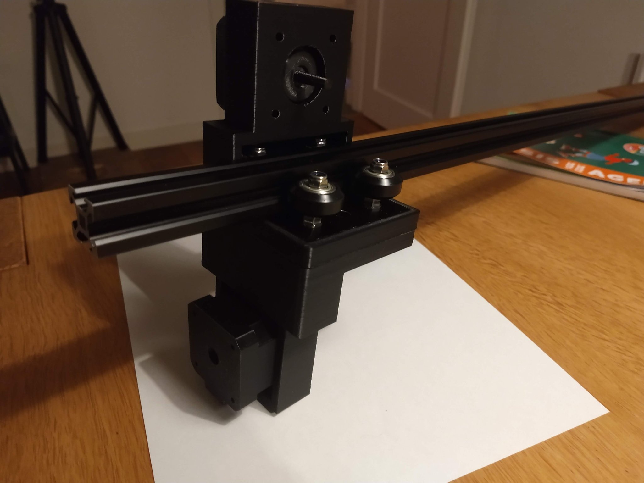

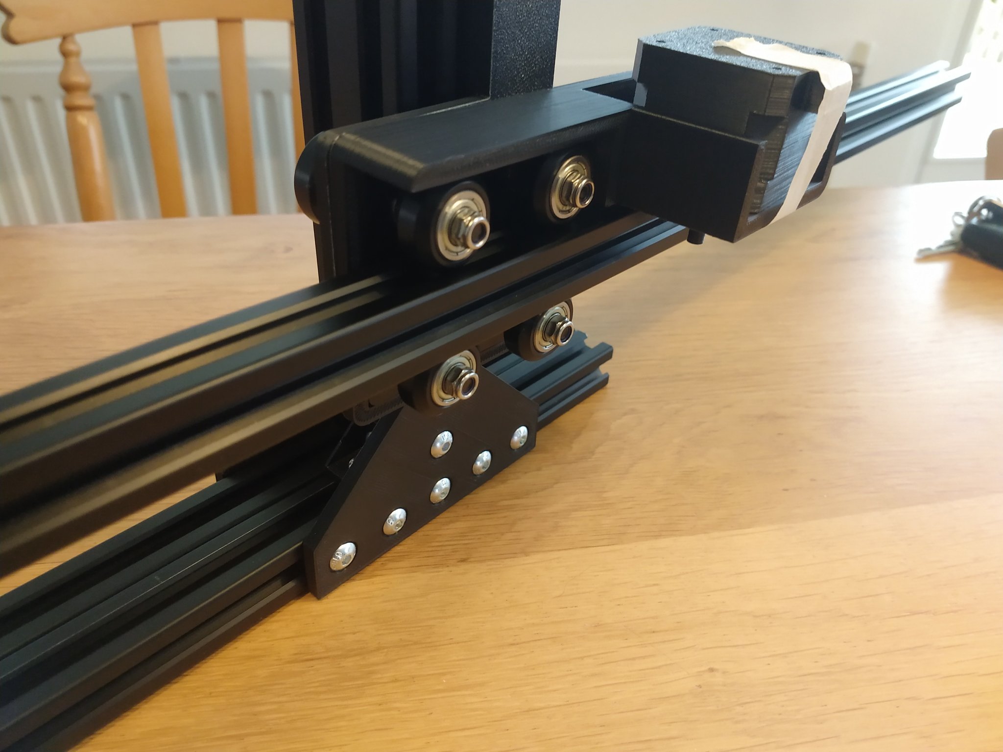

And here is the first problem: The motor is probably too far from the proflle. The stepper torque is ~40Ncm, the arm is 3cm, which results in a little more than a kilogram of 'force'.
And finally an impression of the complete gantry thingy:
