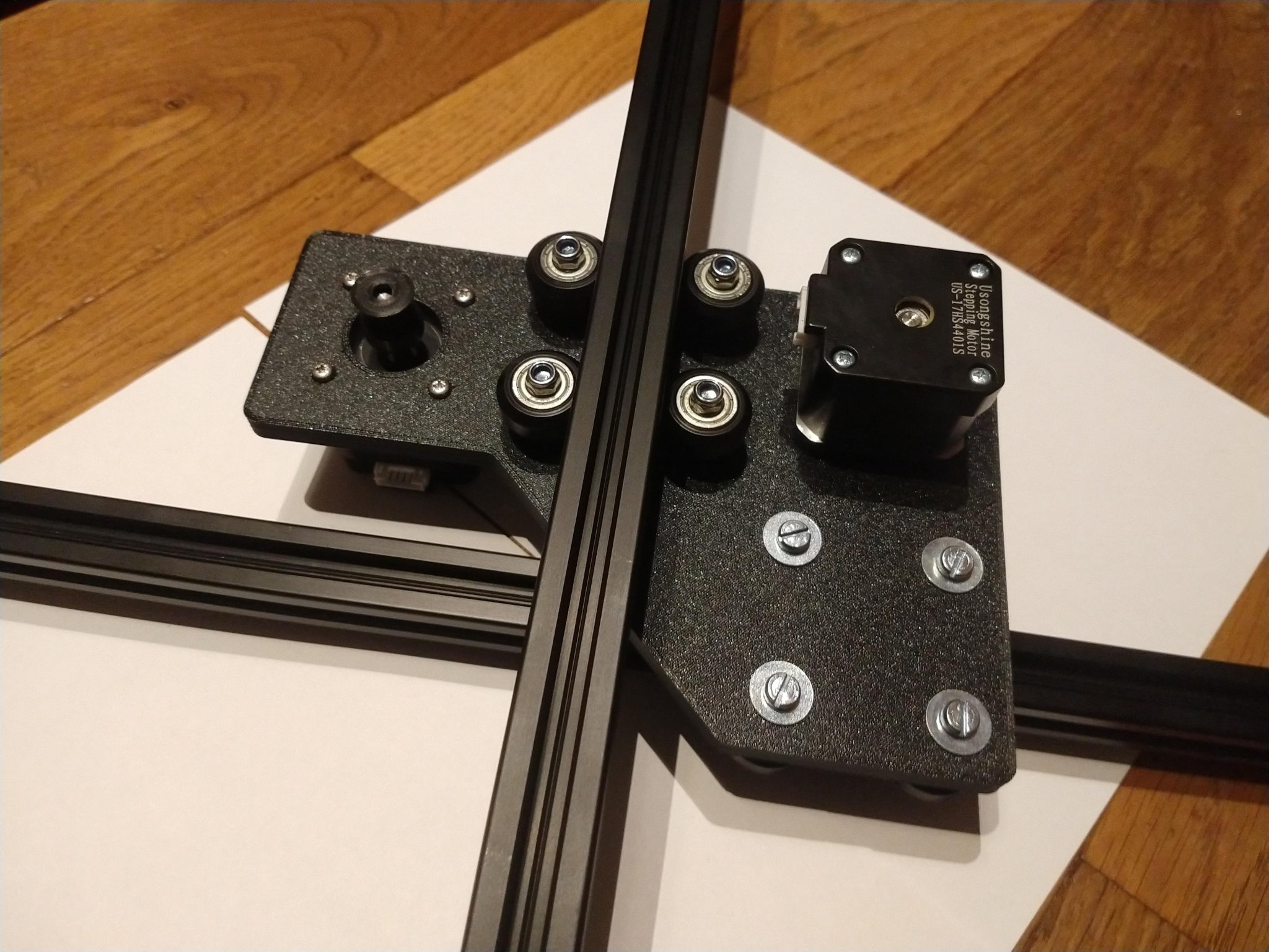

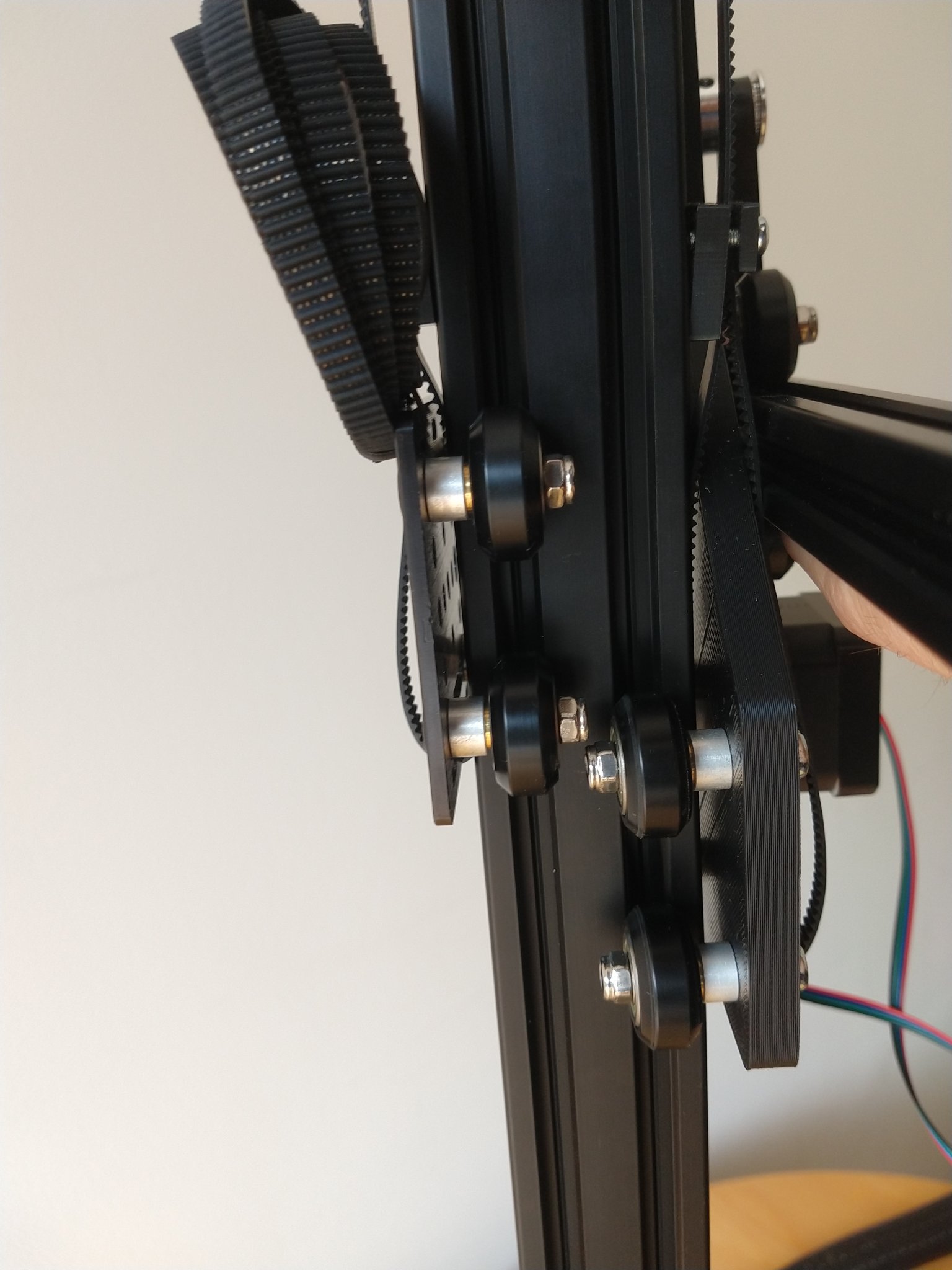

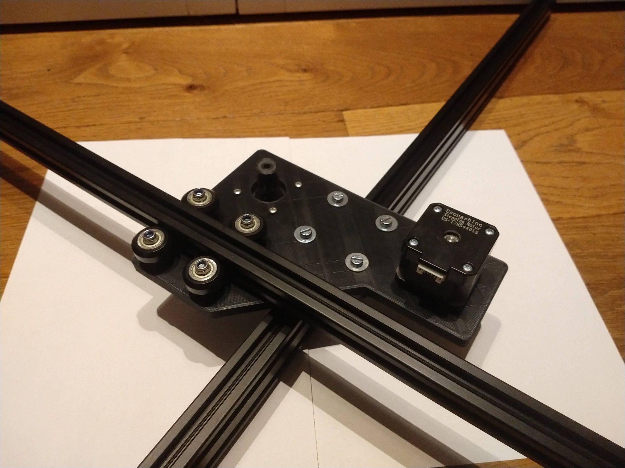

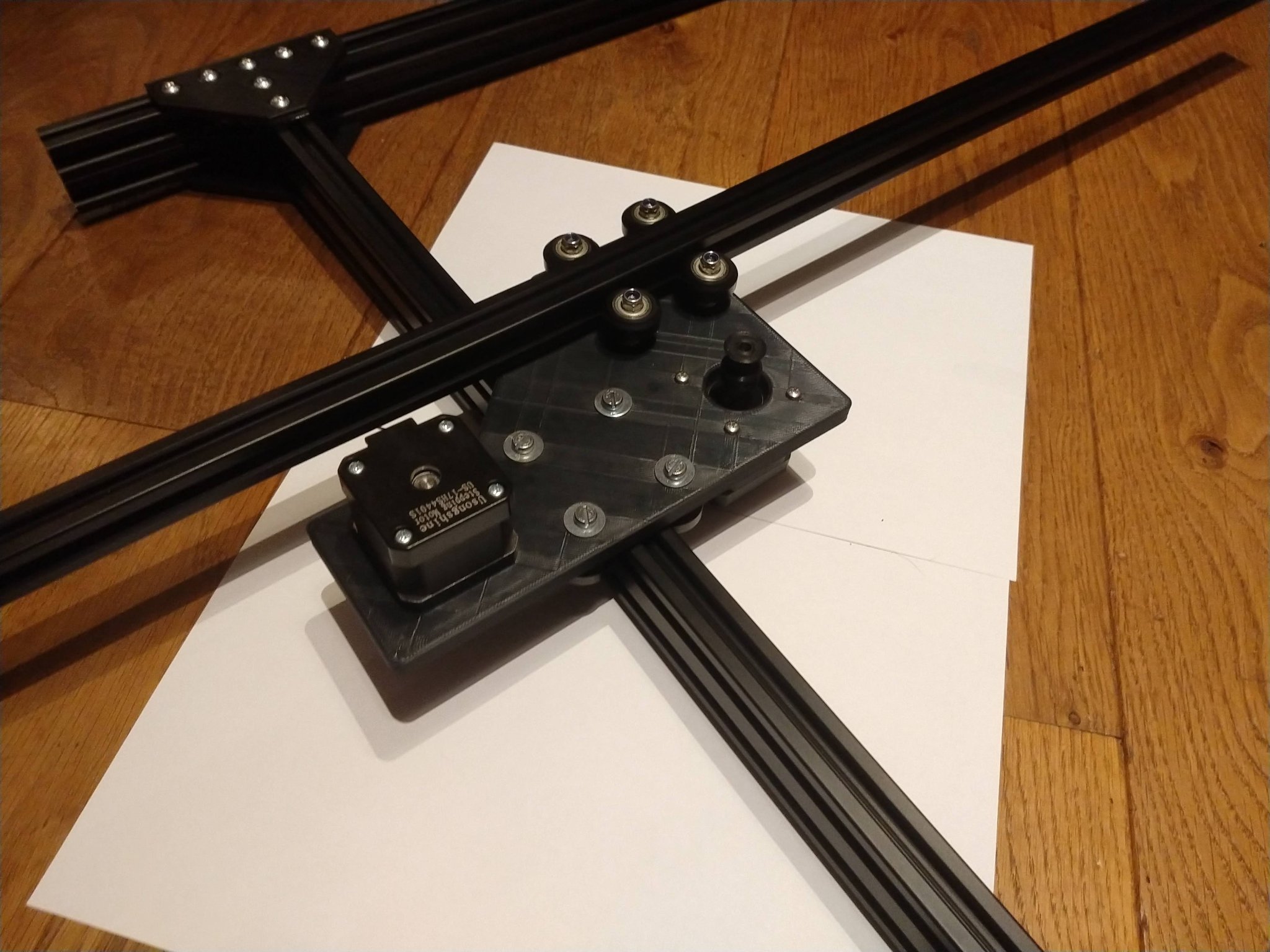

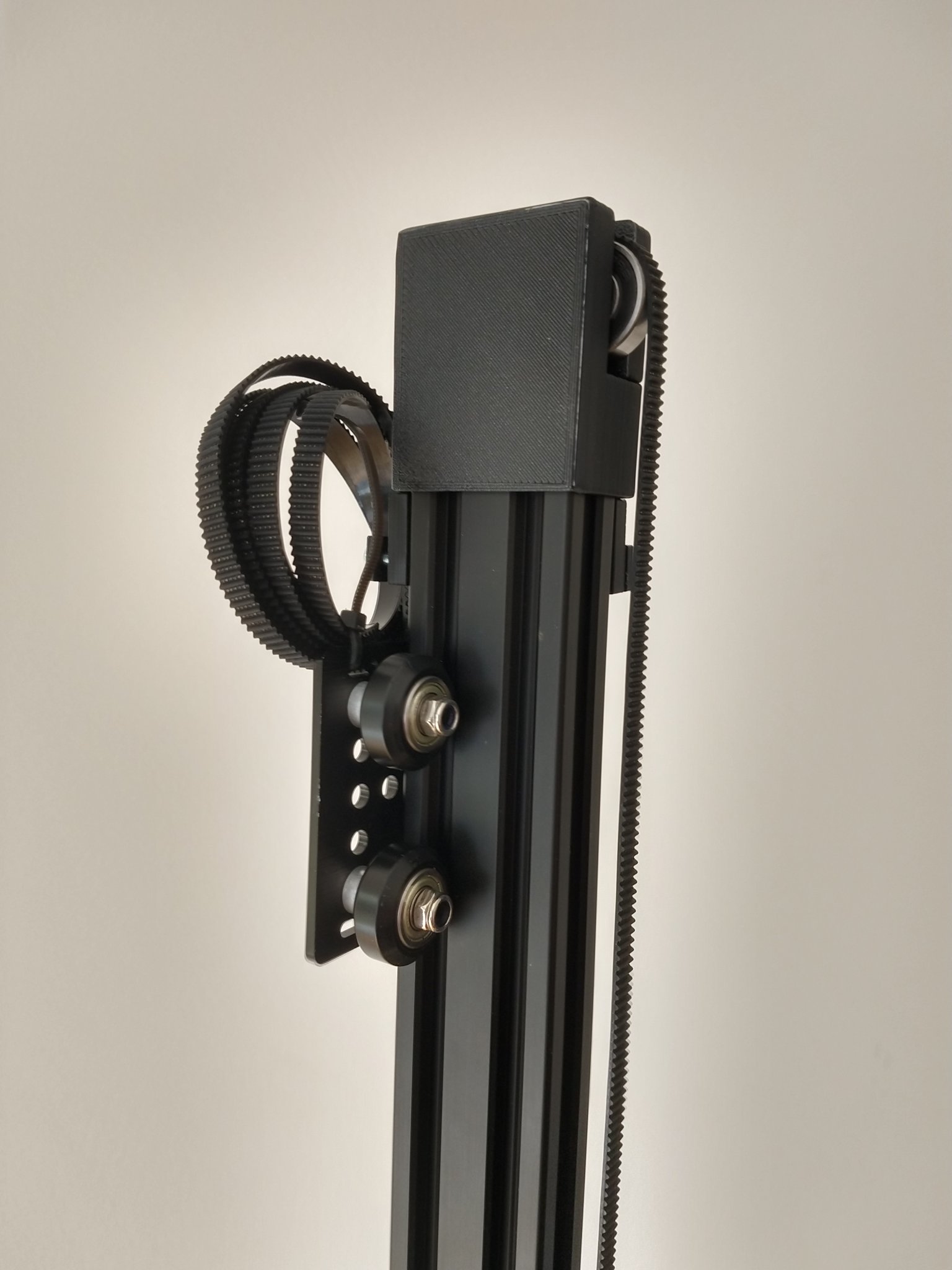

An interesting approach in this camera slider
And once again: @fluid to the rescue!
So simple it was first time right (enough ;-) ). It's a little less compact and limits the maximum motion of the system a bit, but that's ok for me.

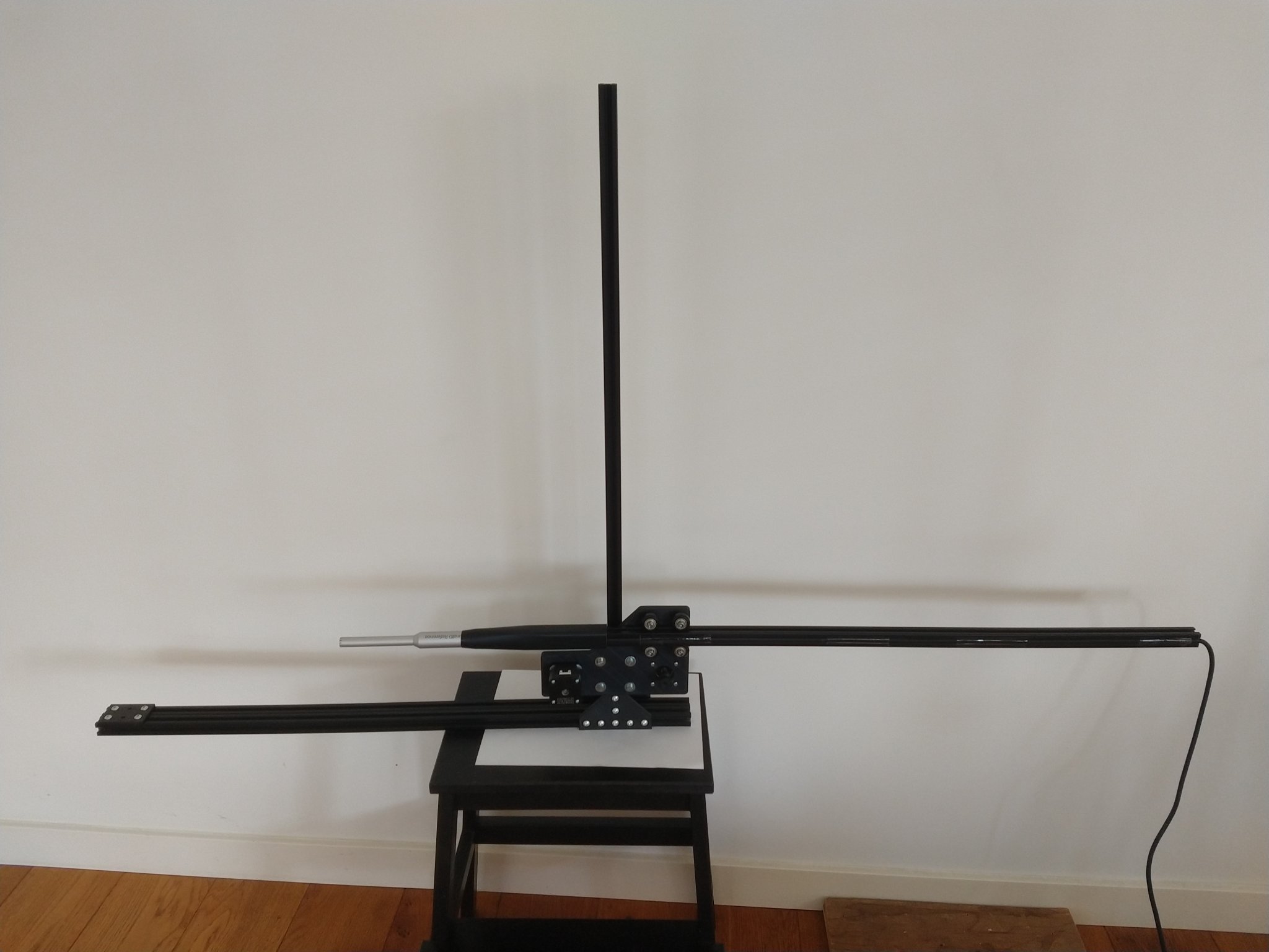

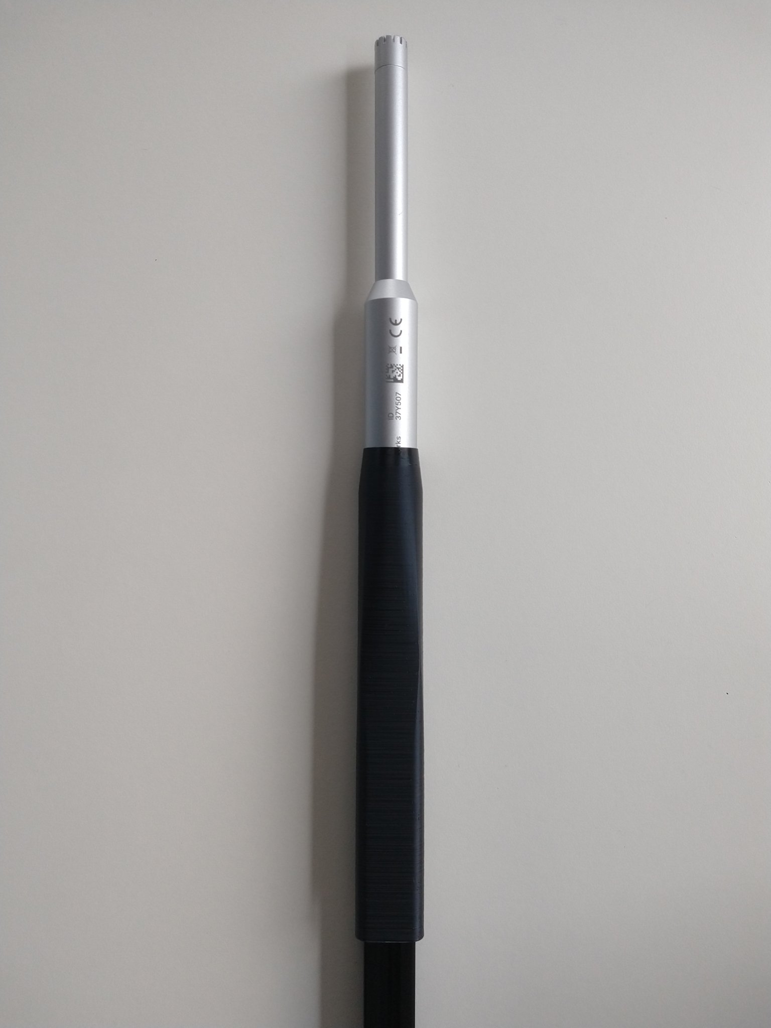

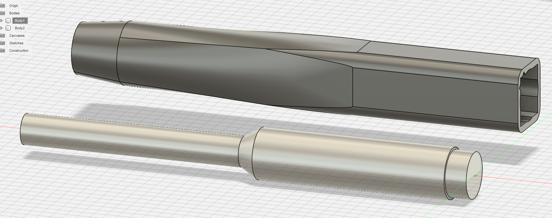

And a sneak preview of the microphone holder:
It looks like the cable just fits the slot in the profile.

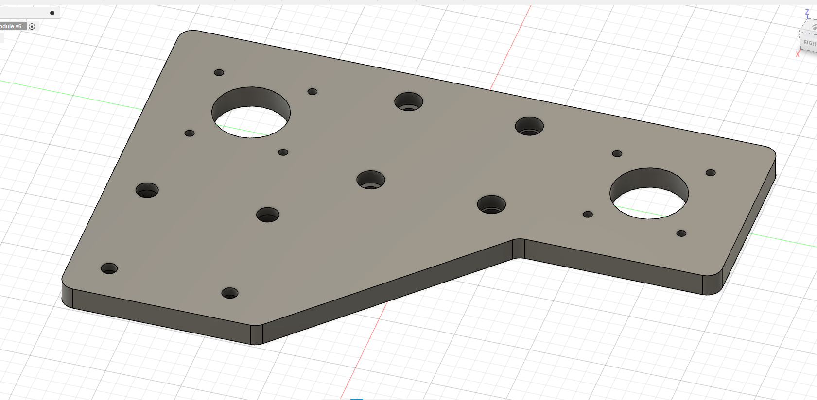

Kind of why I mentioned a 1500mm boom arm, plus whatever you loose on the cross connection coupling for the motors. I like the ideas. It is brilliant! And Fluid's refinement of your roller motor mount is true engineering. As complicated as it truly needs to be, and no more. The mic shroud is brilliant. Have you allowed the push button on the XLR connector to have room internally with a channel? I remember that you showed a channel on your rendering.The fit is better than expected. But measurement volume is getting rather small.
I have some additional extrusions coming. And maybe I can optimize stuff a bit. We'll see.

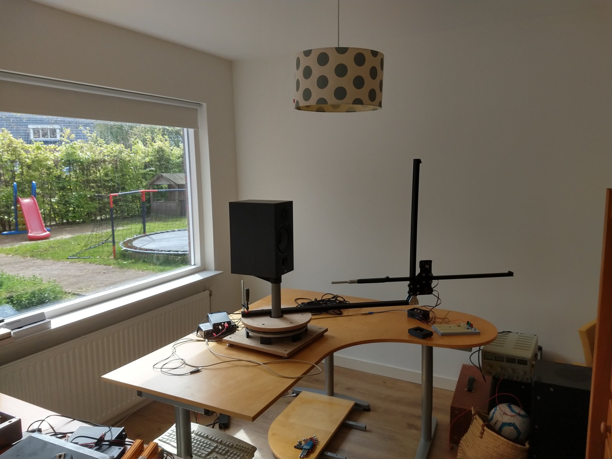

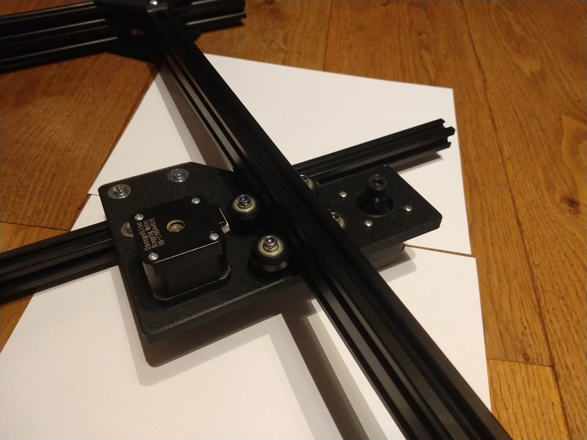

There is an obnoxious whine...
For the movie above, the motors can be turned off, so it's completely silent. The vertical motor has to stay on (it is off by default, don't ask me how I know) and that makes the whining noise. It needs some tweaking, but I'm pleased with the progress so far.

If it makes any noise while not moving, that tells me the voltage holding it still is generated by PWM. Full DC voltage could be applied, but that may increase heating of the coils, perhaps by too much. Ideally, a lower voltage DC could be applied to brake the motors, or alternatively a string-and-weight system added to balance out gravity pulling it down. This of course would double the weight of the vertically moving system, so may not be acceptable.There is an obnoxious whine...
I wonder if the code is microstepping and stopping in between two poles. If so, it could instead stop at the nearest pole and hold it with the voltage fully on. The position would end up off by less than the distance the motor travels between two poles, hopefully less than a mm or so.

As far the loud moving noise, I would take a look into Trinamic stepper drivers, like the TMC2208/09, TMC2100 etc etc
They are A LOT more quiet (as in almost totally silent)
Here a very quick example that I could find;
I have used them in the past and they work extremely well.
Would be definitely the goto in these kind of applications.
As for having noise being on hold, I don't know, usually they shouldn't really do that, so I am a bit confused by it
