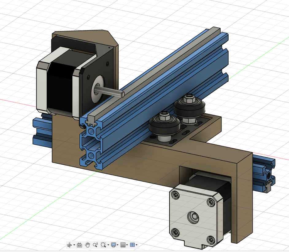

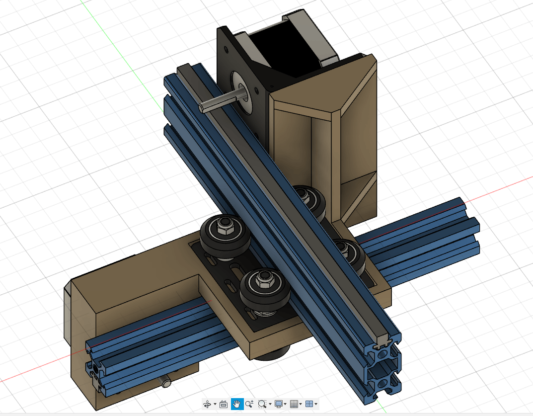

Next mistake:

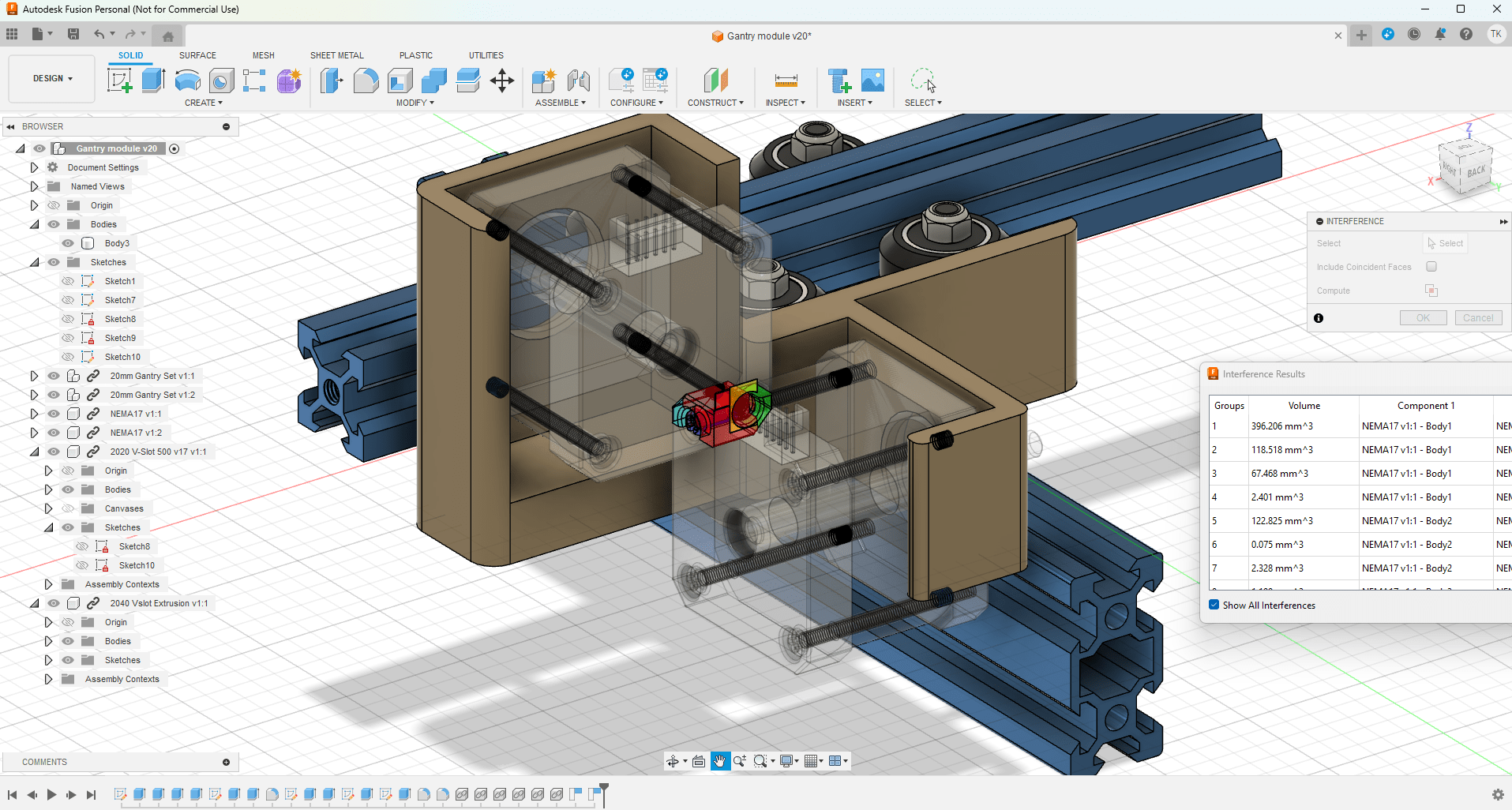

The motors touch...
I personally would first make up the design, either a simple sketch or in CAD, get an understanding where all the important parts and sections are and than come up with what to get.

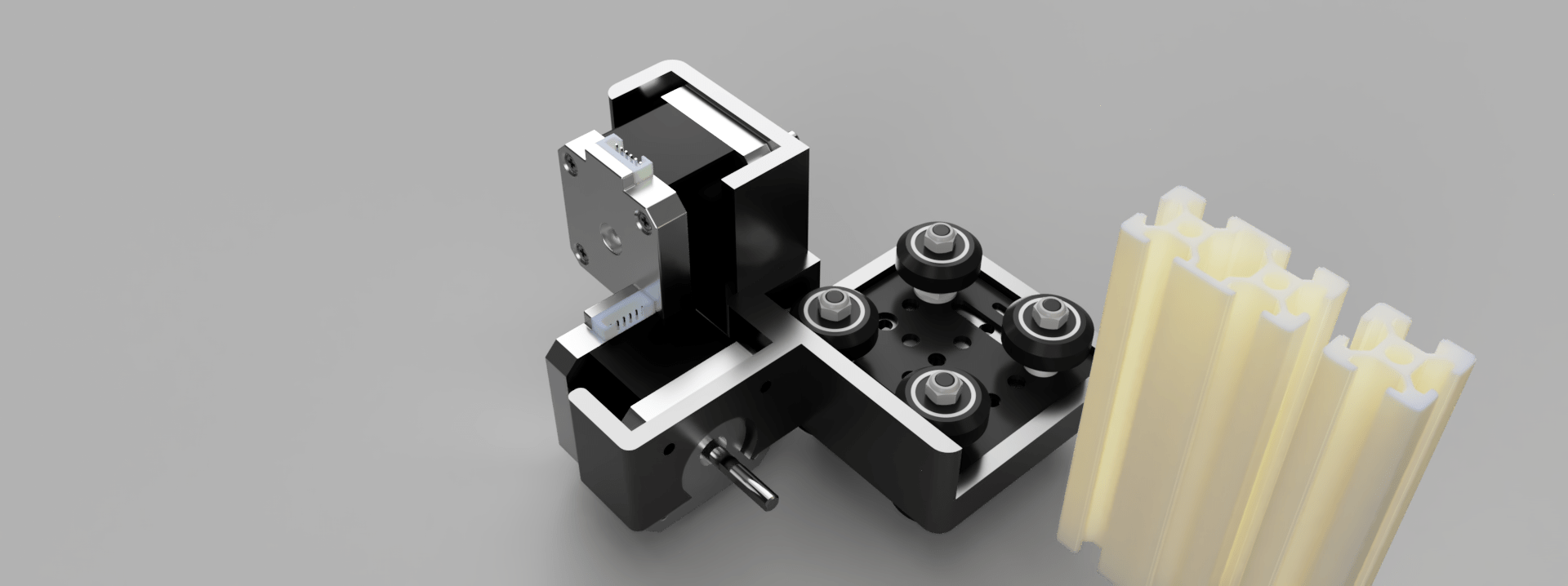

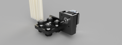

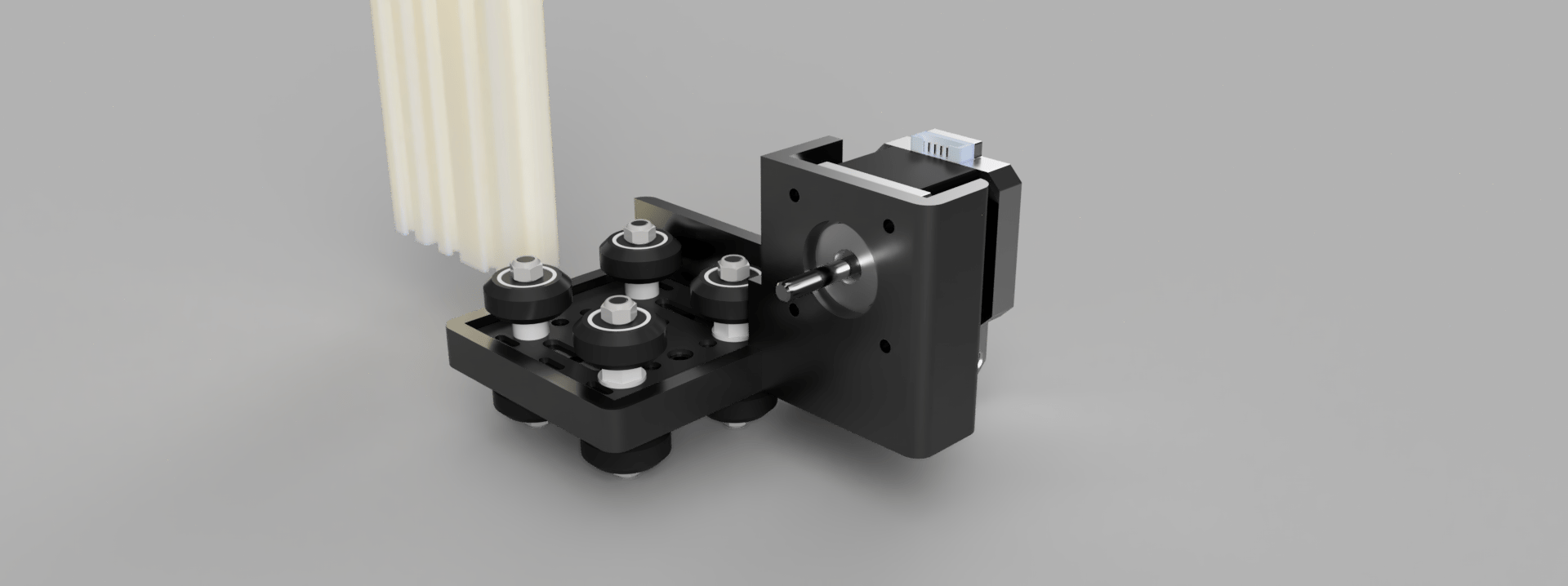

Encouraged by my CAD progress I tried to incorporate the different parts in Fusion. Models for the profile and steppers are freely available.
And indeed the steppers don't fit...
Making steps in all kinds of directions. Still lots to learn and lots to do; progress is slow.
Reactions: 3 users
I can see that you have worked out where you had interference between the motors and the rolling platform. This is making design sense. What I am thinking now is stiffness. That may only be able to be tested when you have this all made and determine that with a mic at full extension everything is sitting correctly and not sagging due to much weight and a not robust enough dual motor bracket.

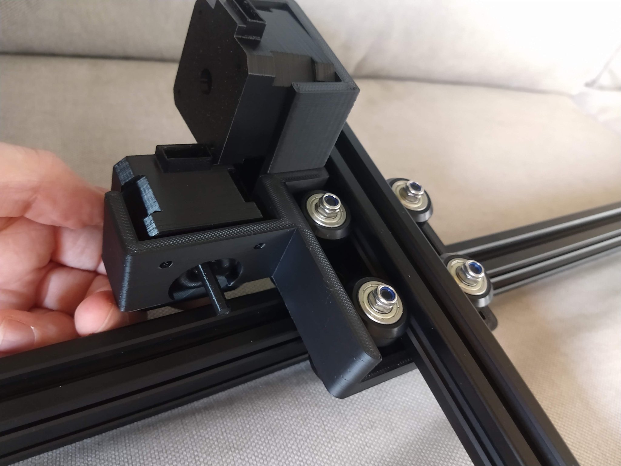

An interesting approach in this camera slider
There is a lot of food for thought there. The belt drive is simple.

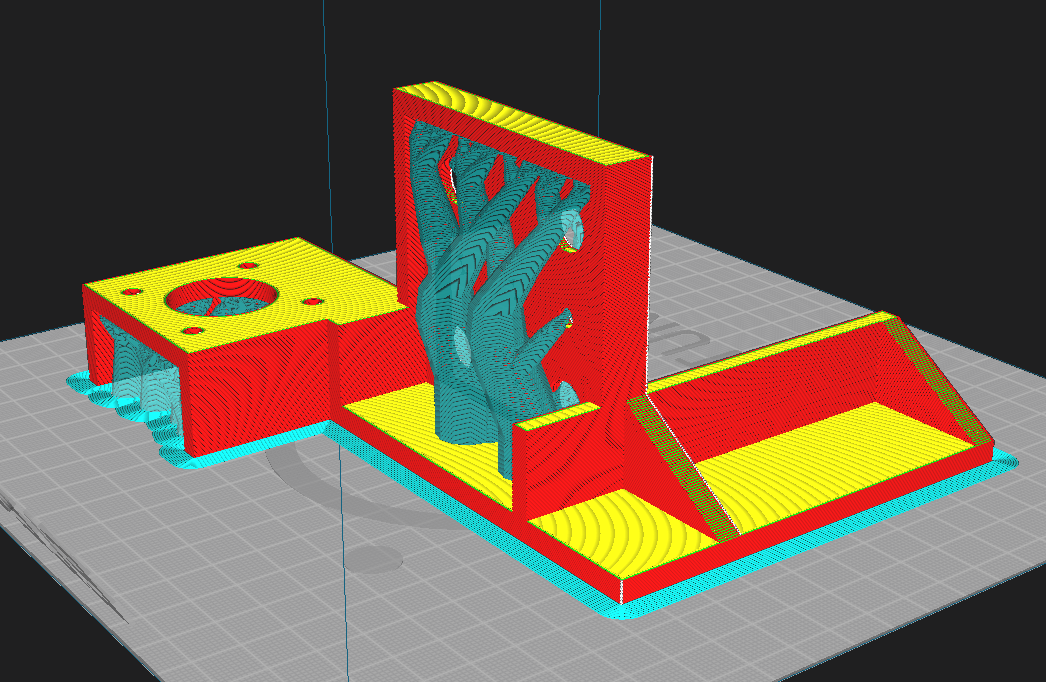

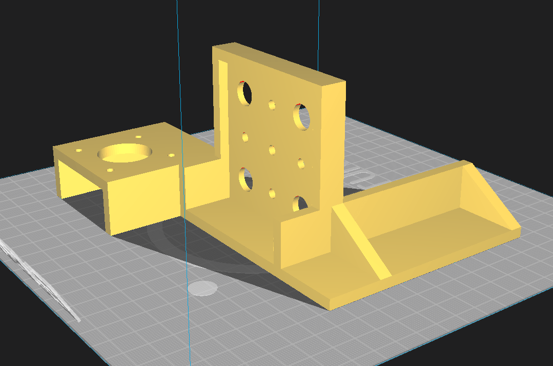

Printing the parts, or having them printed is not impossible.
Once Tom has something that gets the motion down I am excited to try and get this all together.
