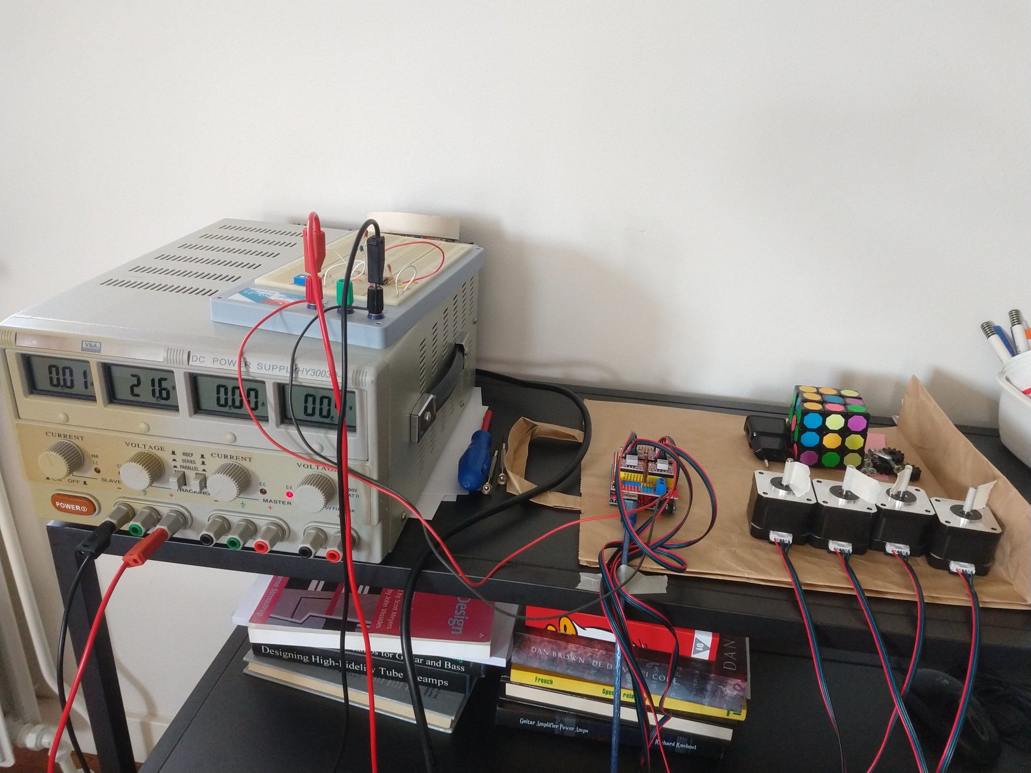

I can control 3 stepper motors via arduino/grbl from octave. The startup ritual is still a bit sketchy.
Next step will be some aluminum profiles, gantries and other small stuff.
I'm interested in design/visions by others. Otherwise I'm just going to build something that moves and find out along the way what works and doesn't.

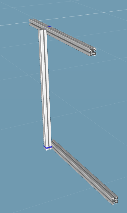

Basically for rotation I think that FEW has the best idea. The slewing bearing with the gear teeth from Hafele. I was going to augment it with the largest reasonably priced slewing bearing so that I had support farther away as I will be needing to measure many sizes of loudspeakers. So a center ring with geared teeth driven via a stepper motor and a gear, and then another ring for further support. I am planning on cutting a sheet of flooring type OSB in half to make two squares for a sturdy base that can still be moved around. And then a mic boom. Bottom swing arm I think will be wood. The rest will be the extrusion idea. Those POM rack teeth that fit within the extrusion slots ScottG showed sold me on the extrusions. Makes this quite simple to have vertical and horizontal movement with modest weight. ( Sadly my idea with the drawer slides while robust, still needs a linear rack or best setup and it is much heavier. ) Those little plates with the POM rollers that fit again within the tracks are the last part of the puzzle.
I'm guessing 1.5 meters for the horizontal boom and 2.3 meters for the vertical boom.
Some cable stays that can be tightened via turn buckle to keep everything tight. Internally if at all possible. I hate messy work.

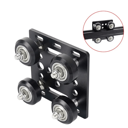

I'm thinking something like this:
With these:
as connection between the aluminum profiles so they can move with respect to each other. A stepper motor is connected to these gantries by a GT2 belt. Normally the gantry moves, but it might be handy that the profile is moving. One could put all the motors at the rotating table and route the GT2 belt in a complex manner (like CORE XY), but I think I will try to keep it simple and put the motors close to what is being moved at the expense of some extra weight/moment. Low accelerations will keep vibrations under control, hopefully. Speed is important eventually, but first let's simply make it work.
With these:
Note 2020 will only go so far before it starts to bend just under its own weight (with a typical lengthwise use).Yes, I'm thinking 2020 extrusion and other 3D printer parts for my cute little learning platform.
Still, if you are just testing-out basic movement then a 2 foot section for the inward/outward axis (and vertical) should be fine. You will also need t-slot gear-rack that slides into the 2020, along with the sliders and connection plates for the motors.
EDIT: I would NOT use a belt; rather direct-drive. IMO a belt might only be truly useful for the vertical when compared to direct (with a counter-weight to offset the weight of the vertical motor + mic./boom and connection plates and slides). Still, up to you (and my guess might prove incorrect).

Tom look to see if you can find V Slot extrusion locally. It has been designed just for this purpose and is very reasonably priced. Most of the hobby cnc kits use it for good reason. Look at 2040 extrusions much straighter and stiffer and still light.
Most of maker stores also carry all the linear motion parts and connection fittings too.

My current (manual) mic stand is a six foot tall section of 1 x 2 inch aluminum extrusion. Works great. My suggestion for the diy-Klippel is V-groove 40 mm x 40 mm to accommodate the wheels necessary for translation, and ensure bending won’t be an issue. My 1 x 2 inch vertical extrusion is plenty stiff, but guy wires, as suggested by Mark, would make it even stiffer if it isn’t stiff enough on its own.
I have a quick sketch nearly completed, and I can post it if it clarifies what I’m saying, but in the meantime I‘ll say a large diameter lazy Susan bearing near the floor would provide rotation without cutting so deeply into the speaker height capabilities. A support of whatever height is convenient could be positioned through the hole in the lazy Susan bearing, so speakers of different heights could be accommodated conveniently. Plus the bearings are cheap and don’t require fancy fitting. Casters can support the vertical post so the lazy Susan bearing isn’t trying to support a mass that is a meter away. Sorry if this doesn’t make sense without the sketch. I’ll try to finish that up.
