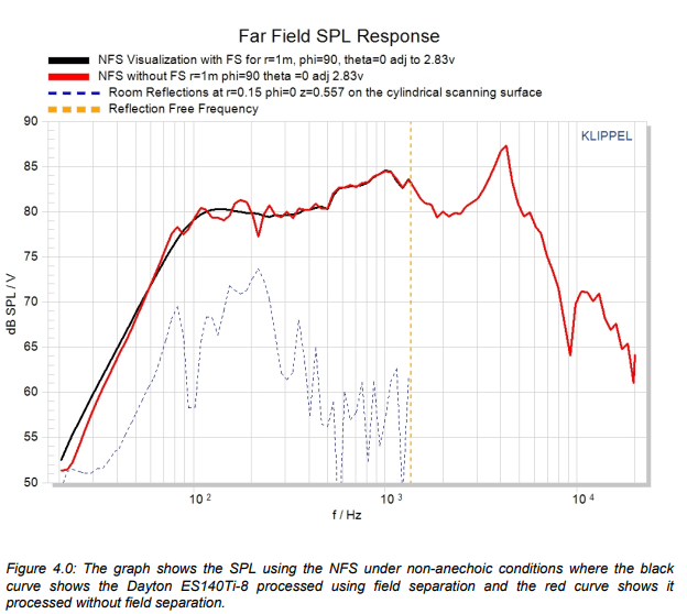

This review from Amir makes me question that assumption. Here he only shows the computed measurements which are unreliable above 6 to 7 K. He says there are redundant measurements that show the unreliability but they are not used to make up for the problem with the computed result. I don't know if that is just a choice made or the way the software forces it to be.
https://www.audiosciencereview.com/...l-conceal-c83-invisible-speaker-review.53010/
I'm a bit unclear about what Amir means in that review. The legend of the first graph says red means "measured," which is then labeled "Actual" on the graph. The blue is labeled "Radiated" in the legend and "Computed" in the graph. Is "Actual" the gated result? Does the "Radiated" label not mean what was actually radiated?

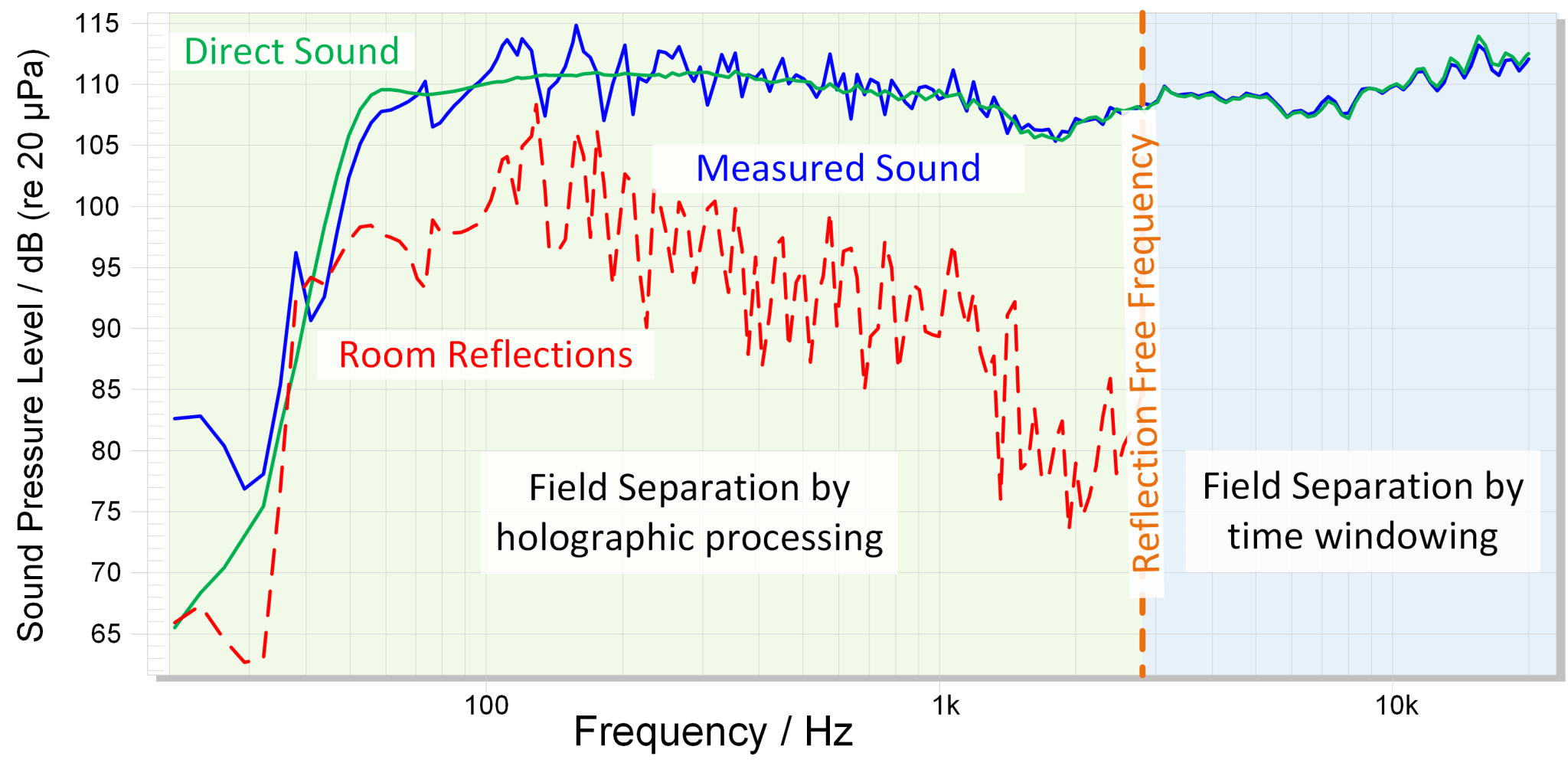

In any case, when I viewed videos put out by Klippel some time ago, I'm pretty sure they said they just use simple gated measurements above some frequency. It's been awhile since I viewed those videos, but that's my recollection. I believe they said that at higher frequencies field separation breaks down, but it doesn't matter because gating yields reflection-free results anyway, and that's what is needed to determine the nearfield behavior. I don't remember what frequency they specified as the cutoff, but Amir's graph shows it to be around 2 kHz.
Plus I just found this graphic on the Klippel site:
That seems to make it clear that gating is used for field separation at high frequencies.

There are no far field measurements, they are all done near field. The field separation is simply not done on the data above some point, but the data is still fitted to the spherical harmonics.
Reactions: 2 users
I think the idea is that by gating out reflections you're left with only outgoing waves. Because the incoming reflections are eliminated by the gating the fields are effectively separated.
