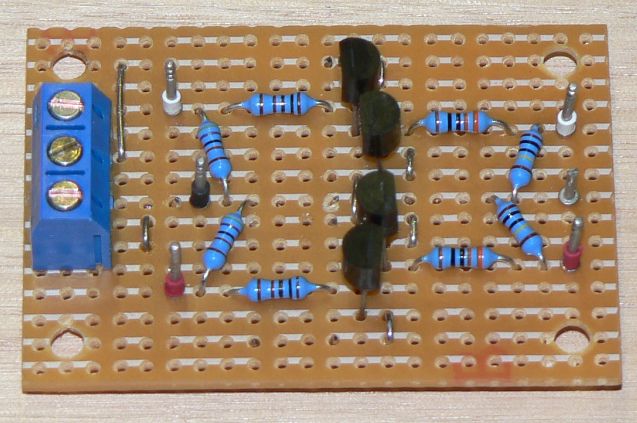

Now I have a question for you guys, it has nothing to do with the speakers but I figure this is the easiest place to ask.
What does a buffer do? (Such as this one )
And more specifically what does it do in a preamp?

A buffer provides no gain but it will, if the upstream component or stage does not have a very low output impedance, reduce the output impedance. This increases the current driving capability of the system.mattcalf said:....What does a buffer do? And more specifically what does it do in a preamp?
Putting aside subjective claims, a buffer does neither good nor harm if the upstream stage already has sufficiently low output impedance to drive the next component or stage in the audio chain. It is therefore not necessary unless your components are not well matched, i.e. not capable of driving the next component in the chain. This is not usually a problem but can arise with valve preamps and with SS or valve headphone amps.

The B1 buffer is very good indeed and extremely transparent.
Just does what it's supposed to by sorting out the impedance issues between the source > pot > power amp. I've found every power amp I've built did benefit from a buffer or an active stage as the pot alone caused roll offs and loss of dynamics.... that's even with following the 100:1 rules and a source with Zout <50R. The only amp that I've built that works well with a pot alone is a LM3875.
I built the no cap version (Zout 330R) by Salas and is about as simple as it gets. The power supply was a modified Jaycar / Altronics (Silcon Chip) and the pot remote controlled via an Altronics (Silicon Chip) kit. I mention those to give you an idea of where to source some of this stuff.

I recently did one for a friend in Melbourne for use with a PrimaLuna valve power amp while he was waiting for a valve pre to be completed. He was using a DACT attenuator and noticed the benefit of the B1. A much smaller board and layout.... virtually point to point.

I've come up with a basic list of things I think my Pre-Amp will need:
2x B1 Buffers (for total 4 inputs 2 outputs)
1x 18v-0-18v toroidal transformer + 5v for volume controller
2x 18v regulators
1x 5v regulator
8x rca plugs (3 in/1 out)
2x XLR/jack combo (1 in/1 out)
1x remote volume control
I'm really hope for 2 outputs at least but I'm not sure if the bbp board will supply them. If not can two buffer board or a modifier buffer board give me an extra output?

Forget about the regs etc.... just get this kit as has all you need including 5V output for remote etc.
http://www.altronics.com.au/index.asp?area=item&id=K5501
It just needs the 1K1 resistors changed to 680R (mine used 5k trimpots for fine tuning) to give 9.75VDC. You only need 1 transformer with this a 15-0-15 or better and safer a 16VAC plug pack. It's connected to the lower 2 inputs of the power supply which is the junction of D1, D2 on the +ve rail side plus ground. The other AC connection on the -ve rail side is not used.
For the remote look no further than this. The pot is rubbish but the circuit is good.
http://www.altronics.com.au/index.asp?area=item&id=K5026
As far as inputs go just use a 4 way break before make 2 pole switch and for 2 outputs just use 2 RCA sets wired together as it will give 2 pre outs.
