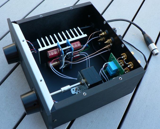

The LM3875 will have no problem driving these at all. When you do build one, use a 160VA 18V-0-18V transformer as that will give 25VDC rails after rectification.
http://www1.jaycar.com.au/productView.asp?ID=MT2113&CATID=19&form=CAT&SUBCATID=539
Should give around 37W for these speakers and allows you to also drive a speaker with an impedance down to 4 ohm. If you use a higher voltage transformer like a 25V-0-25V (about 35VDC) then the power goes up but has problems driving a lower impedance.
Here's the amp section of a LM3875 that was built from an AudioSector kit. All it needs is a good 10K pot for the volume and source selection if required. The power supply was in another box.
Matt

From what I've read a 300VA 25v-0-25v is suggested, but I'd love it if I could sub in the 160VA 18V-0-18V transformer as it is a good $40 cheaper! But I'd rather spend an extra $40 now, so in the future I can use the amp to power other (bigger/more needy) speakers?
Thanks again for all your help!

I bought 50K Alps pots in a rush the other day, will that be alright?All it needs is a good 10K pot for the volume

A 300VA is overkill an not required. Christ, I run a 300VA in my AKSA 55N+ which puts out heaps more power and current and drives a speaker from hell. It's just not required in the real world and to me is a DIY thing because they can. Some go to a larger VA transformer for better regulation. I've even ran a LM4780 with a 80VA with no issues and that's equivalent to 2 LM3886 chips.
As far as voltage goes, the 25V (35VDC rails) is fine when you run 8 ohm speakers but start dropping the impedance and they start running hot, lose stability and the protection starts cutting in a lot. Have a look at the LM3875 data sheet and there's a nice little graph that shows rail voltage / power / impedance. The difference with say 37W to 49W output is virtually zilch... probably only about 1dB. As the rail voltage drops (35VDC vs 25VDC) more current is supplied which is required for lower impedance speakers (4-5 ohm). The speaker that you are looking at building is a 6 ohm speaker and has dips down to 4.5 ohm and is less than 5 ohm from 100Hz to 600Hz. A LM3875 chip will thank you for running lower rail voltages.
A 50K pot will still work fine so don't sweat over it. A 10K may have a little less noise and may have a little better detail but I've seen that work the other way.
