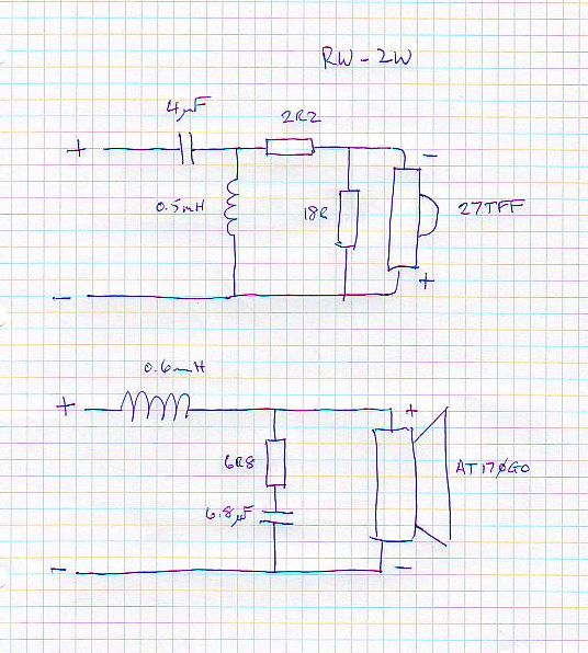

I've done a few numbers and a bit of modelling of this design.
I've attached a schematic of Raph's crossover. Ralph is on the money with his values as expected and I think the zobel is required as it does help with phase at the crossover point, the overall impedance and the impedance phase. For the few extra dollars it's worth it. His L-pad values gives a slight downward response (BBC dip?) very similar to what Troels uses on his designs.

I forgot.... the tweeter is connected reversed polarity as shown in the sketch. The +ve lead is connected to the tweeter -ve terminal.
Thought I'd save you some head scratching.

Thanks for the reply rabbitz. I saved all those pages, cheers. 😀
And the schematic puts everything in better perspective!!

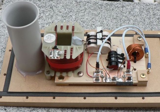

A vented box has a port (tube) that starts from a hole in the back of the box and goes inside the box. It's length determines the box (bass) tuning (Fb). Have a read of that guide over the next week and it will make it a lot clearer. It's been written in as simple terms as I could.
If you have a look at this picture, it shows the port tube (white PVc pipe on the left) and this is a removeable back panel from a box. When it's installed, the port and crossover are inside the box. If you grab a cardboard box, seal it cut a hole and stick a toilet roll tube in it and that becomes the same as a vented box. Tap the box while having your ear up to the tube and you'll hear the box tuning frequency set by the tube. Put the tube in a larger box and tap again and you'll hear it's a lower frequency as the box volume has increased but the port has remained the same length... hence it's tuned lower.
