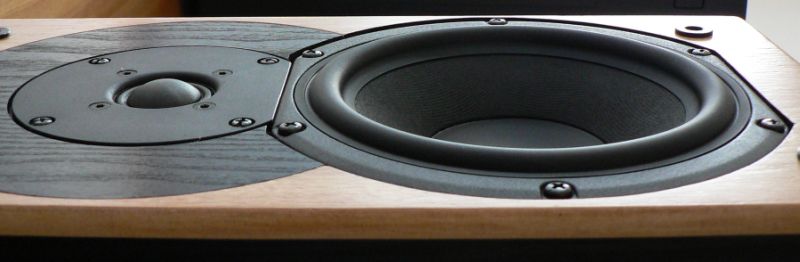

Rabbitz would routing the tweeter plate to give closer CTC distance have much effect?

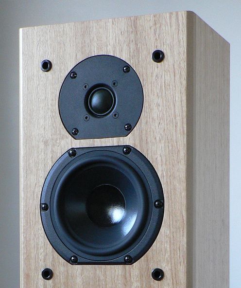

No benefit here as in theory the drivers would need to be at 90mm centres which is impossible. What we try to do if possible is to have the drivers centres less than the wavelength of the crossover frequency but if that can't be achieved (in a lot of cases) I'm not going to pull my hair out.
The crossover frequency has been set by the Ralph W crossover and I can understand what he's done. He has the AT170G0 that can be extended further than most 6.5" mid woofers due to it's great top end roll off behaviour and has matched that to the 27TFF which has a highish Fs. So he's using the capabilities of the mid woofer and keeping the tweeter well within it's range.
I've tried cutting back tweeters to get a closer centre but not worth the effort. The one in the pic is a 27TFFC with a 830875 Peerless HDS. Lucky I was still able to use the tweeter in another speaker as was paired with another smaller HDS driver.
The other easy option is to overlap drivers like the Dynaudio Audience 42 where the tweeter is rebated and the woofer isn't and have used that in a little Vifa P11 speaker.
One thing's for sure, I don't think Matt will be rebating the AT170G2 mid woofer due to the basket shape. HDS drivers are hard enough.

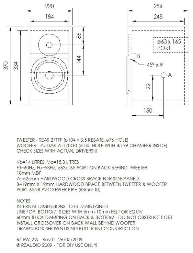

The design is done and will get the drawing done in the next couple of days. It's 370 high x 220 wide x 284 deep outside using the thickness as suggested.
I'll send a PM with my email address so you can send me yours. That way I can send the drawing to you. The one that is posted here might be a bit small as there are size restrictions.
Matt
Here's the drawing of the 14 litre vented. I decided not to do a hybrid box that can do a 10 litre sealed as well but this size would work for sealed. I had to reduce the size so I can add it to the post.
For anyone interested in a floorstander using the same design whilst the drivers were still available on ebay oz, 27 litres vented with a 76mm x 165 port gives an F3=45Hz. The same drawing can be used for width and depth but height and bracing would have to be changed to suit. The port would be about 35% of the box height from the floor.

Rabbitz I see that you've not shown corner blocking and vertical bracing battens on the long sides of the box in the drawing, are these not needed given the small size of the box or have you treated this as a "Given"
That is a standard box treatment that Matt may not be aware of??
Matt my usual treatment of the dowel that Rabbitz has shown is to run a 40 X 19 hardwood brace from top to bottom of the side panels and then to run the brace from side to side using 40 X 19 again actually glued and screwed to the side braces, I also usually use small square blocks of MDF or hardwood quad to tie the corners together
Given the small size of the box it is probably overkill, but I'd be interested in your take on the side panel bracing Rabbitz.
Regards
Ted
Ted
It's not warranted in this design and is part of the decisions that we make to achieve a small size and suitable for intended use. Basically you don't want a panel larger than 400mm without some bracing or support. Each designer / builder finds what works for them.
There are several school of thoughts on box construction from built like a tank with the associated knuckle test plus hernia and lighter construction with selective bracing. Both methods can achieve good results. I've taken the path of lighter simple boxes with selective bracing. It's not the number of braces but the location to achieve the best results. For example, the cross brace position is located so the side panels are broken up into irrational numbers and will push resonances to higher frequencies where damping is effective. It's also in this location to allow placement of damping in the volume and away from the back wall. One of the most effective ways of doing a cross brace is to use the driver cutouts on the side wall at the cross brace junction.
I do use corner cleats but in larger designs such as floorstanders. I've never found vertical strips on the side panels to be effective and prefer horizontal strips placed at irrational locations (such as Phi and other strange numbers). There's a good section on it in the Loudspeaker Design Cookbook.

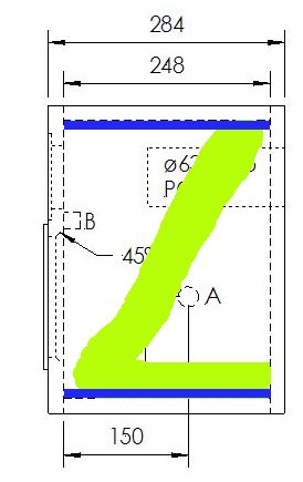

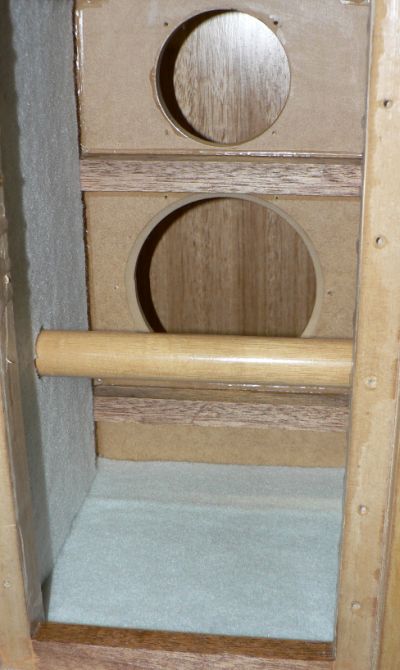

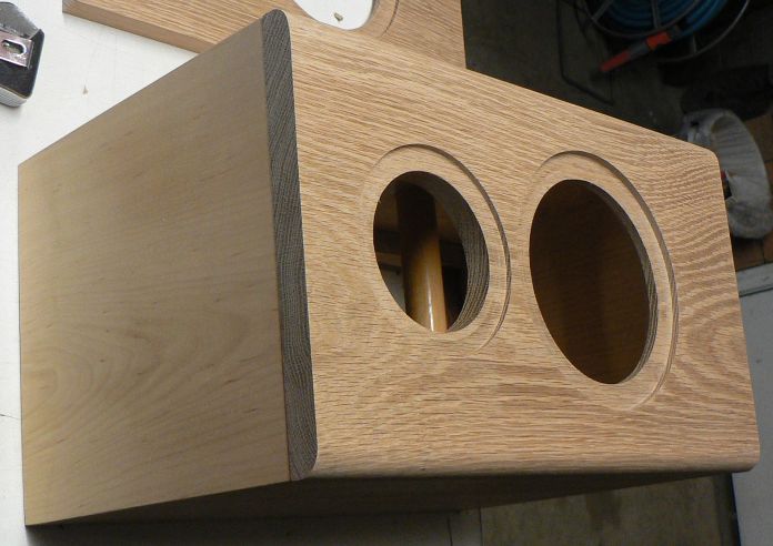

To help visualise the damping I'm talking about I've added some pics of a speaker I'm just finishing that's a similar size.
This pic shows the felt type material that's used on the perimeter walls. The stuff I've used is actually an ironing board underlay but carpet underlay, shipping felt etc can be used. Just has to be porous and is glued on.
The cross brace is a handle from a lawn edger and you can use what you want and doesn't have to be round. I do prefer round for airflow and reflection reasons. If you use a rectangular piece, the narrow side is in the vertical direction.
The brace between the tweeter is hardwood (stable species like Tassie Oak) and this box has one under the woofer as well.
You can see the chamfer on the inside of the woofer hole and is there to provide better airflow for the woofer.

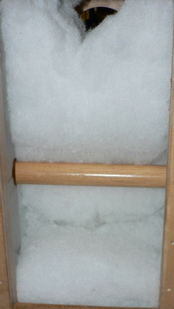

Next pic is the damping material that's in the volume of the box. It goes from the top back, between the brace and woofer and is folded to cover the bottom. The split at the top allows the port to poke through and damping has to be kept away from the port opening.
The stuff used here is from Jaycar and is a single piece but can be made with 2.
So what is the use of the 'floating' brace compared to the 'woofer/tweeter separation' brace?
I'm guessing the floating is just structual so the material + size isn't paramount to performance (so a thinner hardwood or MDF brace would do)?
Hand sanding that will be fun. 😀
My jaycar shopping list is evergrowing.
In reference to the stuffing: I should fill it with as much as possible without interfering with the crossover, port and drivers?

The cross brace is there to break up the side panels into smaller areas. If you have a large panel it resonates at a low frequency which can't be absorbed by the damping material so by breaking it into smaller sections you push the resonating frequency higher so it can be absorbed. Take for example Rolph Harris' wobble board (you may be too young to know him). As he moves the board it goes whoop whoop and if you made it half the size, the frequency would be higher.
The brace between the tweeter and woofer is purely structural as 2 holes have been made which weakens the baffle. It's there to provide a better foundation for the drivers.
Only the one layer of damping as shown. It comes as a sheet and just cut to size so it covers the bottom and goes to the top... sort of like a slanted "L". In vented boxes you don't use loose stuff like Dacron or pillow filling etc.
http://www1.jaycar.com.au/productView.asp?ID=AX3694&keywords=absorb&form=KEYWORD
The blue in the pic is the felt type material glued on the perimeter (top, bottom, sides) and the green is the damping material that's placed loose in the box. Boxes can be tuned with more or less damping but generally this scheme works fine.
