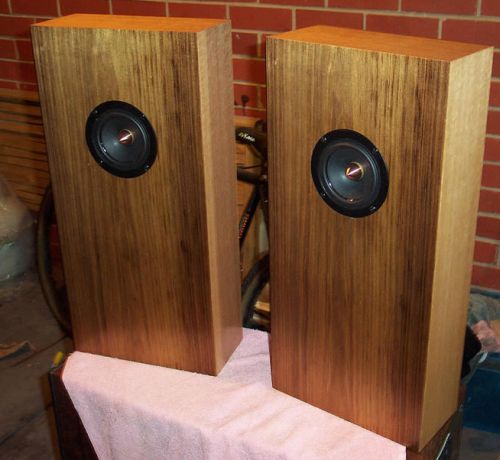

Funny you should mention the resistor. The second speaker I built with the CHR70 was a small 2 litre sealed (cut down from the first vented) and I used a 1R to 1R5 resistor to increase the bass output and not for impedance purposes. I think the SPL dropped by about 2dB but didn't matter as it was for a nearfield speaker (since scrapped) on a computer.
I haven't used many FR drivers and only tried the FR125S, FE127E, W3-871SC and CHR70 and I gave the first 2 away and sold the other 2 on ebay. I preferred the FR125S as it was the best balance and tonal quality. I'm a multi-way guy so gave FR the flick but was interesting to dabble.

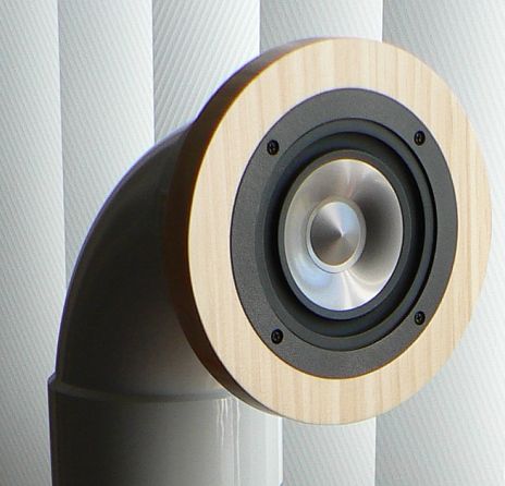

The same guy built a 12-13 litre BR design I did for the FR125S. It was a shallow wide baffle thingy and came up well. I heard the test box in a visit but never heard the final speaker shown in the pic.
He (lazyfly) may chime in sometime and tell you about the CSS.
