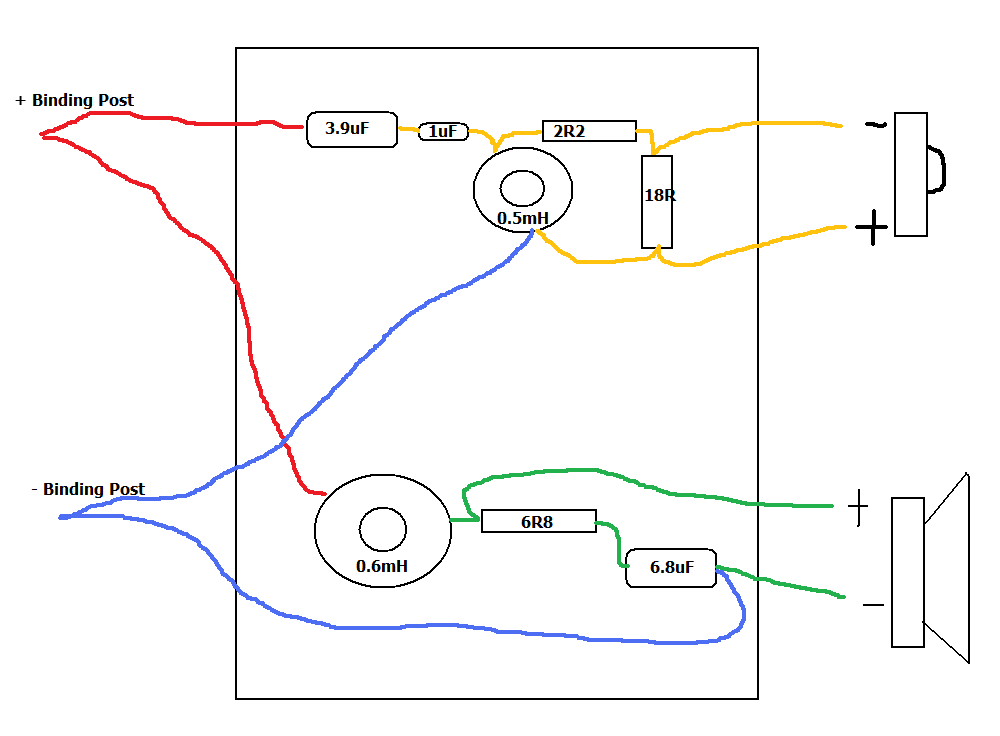

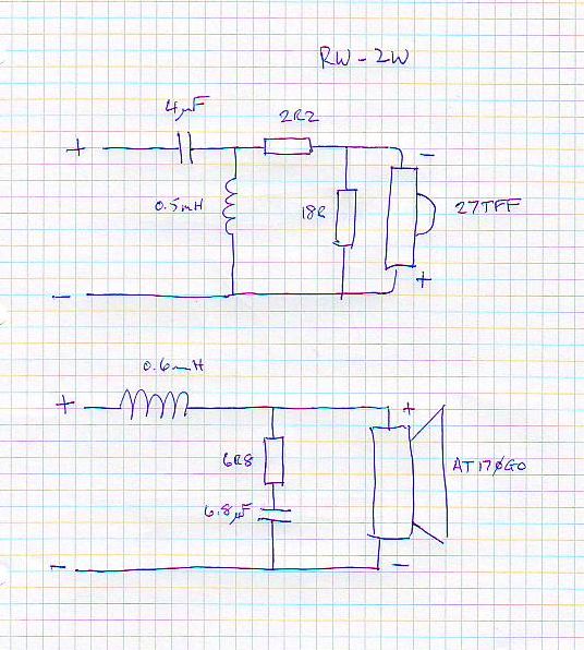

One thing I want to confirm is the crossover layout, I've drawn it up in paint just wondering if someone can have a look and confirm that it'll work. And if it could be more efficient let me know...

Does not look correct to me.
The capacitor and resistor on the woofer is IF I remember correctly a "Zobel" circuit; part of the driver itself.
So;- the inductor (coil) is in series with the woofer CORRECT!
But the capacitor connects to the positive side of the circuit and goes through the resistor to system ground, that is I usually put the capacitor before the resistor

Matt, it is as the little bit-map you attached, except that I usually put the capacitor first and the resistor second, I may be totally wrong too as that sketch was given to you by Ralph wasn't it?
I usually attach the Zobel directly to the back plate of the driver, usually with a dab of silicon; just because I find it easier that way

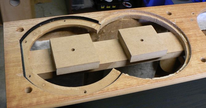

You may be able to do this free-hand, I have.
Use as big a router bit as you can and take it slowly, make sure the light is good and that the scribed pencil mark is easy to see.
If the rebate is too big you can fill it with bog or putty
Theres an easier way of doing it if the hole is already cut. You can put a piece of rectangular MDF through the tweeter hole and then fix it with screws through the baffle. Drill a hole in it's center to act as the pivot point for your router cut. After, remove the bit of wood and fill the screw holes with a filler. I use car body filler with MDF, dries rock hard.
Your crossover layout is fine and the zobel can be connected either way.... RC or CR.... makes no difference.... different builders do it different ways. I don't know what the 1uF cap is doing there as the series cap is specified at 4uF and 3.9uF is close enough. If it's a 0.1uF cap to make up the value then run it in parallel to the 3.9uF so it adds up to 4uF.

Rabbitz has already mentioned this, but this WON'T work as is.
Your two capacitors on the tweeter have an effective value of about 0.8 µF, not 4 µF! If you want to add capacitors together, connect them in parallel. But 3.9 µF is close enough and probably within the tolerance of the capacitors anyway.
The order of the capacitor/resistor on the Zobel doesn't matter at all, though.
