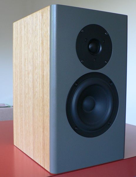

Whats a reasonably cheap finish for MDF, that looks decent. If it had a grain, I would just stain and lacquer, not sure how good that would look on MDF.
I had to pick between buying a house or new speakers to build, the wife ( SWMBO ) won.
I would love to join in on this build though, perhaps Ralph will still have some in 3 months time.
You could try gluing good quality ply to the MDF faces and then polish and seal, but for years I have been using plain old house paint as I care more for the sound than the looks.
What-ever you use don't forget to seal the inside of the box as well.
Enclosure cheap finish
Iron on veneer is not to expensive and not to difficult to apply. Stay away from the harder timber species (Jarrah, Blackwood) as they crack easily when applying the heat. Rock Maple, Pine and Tassie Oak are probably the easiest to work with in the Consolidated Edges range.
The other option is to get veneered MDF, mitred for top, sides and bottom and use a painted baffle. You can also use iron on veneer on those surfaces on top of the MDF plus then paint the baffle.
