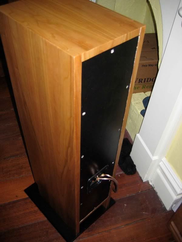

I have the back panel removable (screwed into Jarrah) and would like to ensure that it is sealed when screwed on.

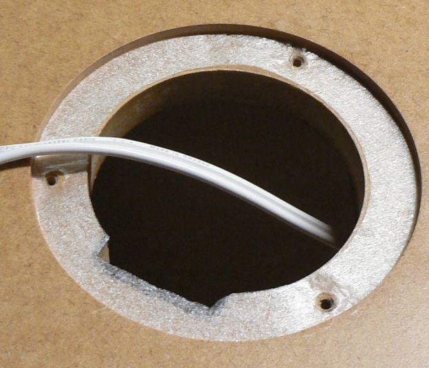

I have decided not to rebate the woofer, its not a round circle and using a router is quite difficult.

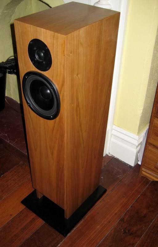

Otherwise everything is on track to have it finished in the next couple of weeks, I have decided to veneer it using lay on veneer in American cherry, I much prefer African hardwoods but choosing a veneer was very painful, so I just chose a trusted speaker finish.

The stuff I was referring to is the shipping protection they place over screens on LCD and Plasmas TV's as well on front panels on amps and DVD players. Here's a pic with some cut to suit a tweeter gasket. I can't remember what it's called. What makes it very good is it doesn't stick to the box or driver which makes removal easier.

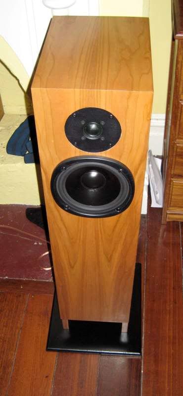

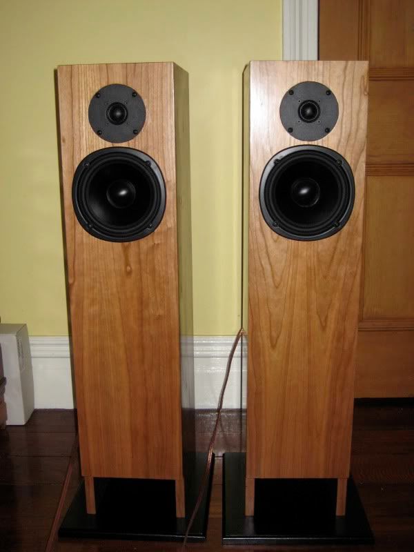

Speaker cabinets are built, just need to be finished (hopefully this weekend).

Awesome work vovo, put's mine to shame. I think that'll be my next project, rather then new speakers turning these into floorstanders... because to be honest my first box effort is sub-standard. 😱
However, I'm really looking forward to finishing these speakers but the amount of school and basketball at the moment is ridiculous.
Can't wait for the holidays and to hear these beauties!
Matt.😀
