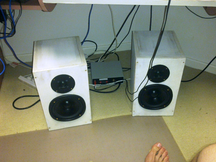

Finally finished. Well, kinda! 🙂
I haven't attached the back because I want to do it properly so it's removable and dad said to wait until he gets back from his next swing.
The important thing is I am listening to them as I type and I'm already very happy even without acoustic stuffing or back of the box and through a $30 T-Amp 😛 (probably sacrilege around here.)
Anyway, just want to thank you all for being a part of this amazing journey! They aren't pretty but they hold a special place in my audio menagerie purely because of the people here that have taught me so much!
Sorry I took so long! 😉 😱

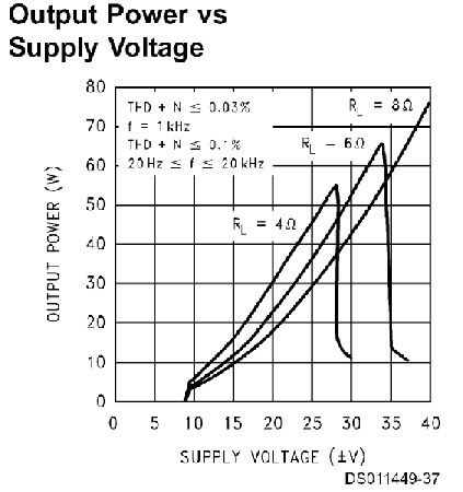

Hi guys,
I'm a new member wanting to build a set of book shelve speakers similar to what matt built himself in this thread. I'm also from the land down under (Tasmania specifically) so I thought I would just add to this thread rather than start a new one.
I have recently completed building a Peter Daniel (audiosector) LM3875 gainclone amp which is working very nicely. I have used a 25V 300VA toroidal transformer which is producing roughly 35 volts after rectification. Speakers with an 8 ohm impedance look like the go.
I really have no idea when it comes to building loudspeakers, I've had a look through this thread but I really need to do more research. If anyone can give me some advice, that would be great.

1. Is the impedance of the speaker solely determined by the speaker alone or is it influenced by the crossover also? So if I want some 8 ohm loudspeakers, do I need to buy 8 ohm speakers and tweeters?

The LM3875 with 35VDC rails really needs an 8R nom speaker as it would have problems with low impedance loads. I use 25VDC rails which allows use of low impedance speakers but loses power but gains current. Just choose a speaker to suit and all is well.
To answer your questions:
1. The final impedance of a loudspeaker is a combination of the drivers and implementation of the crossover. Best to use 8R woofers but tweeters can be a lower impedance to achieve the result. An 8R nom impedance loudspeaker can have dips down to 5R6 which is no problem. Remember the impedance plot is not flat but like a roller coaster over the frequency range.
