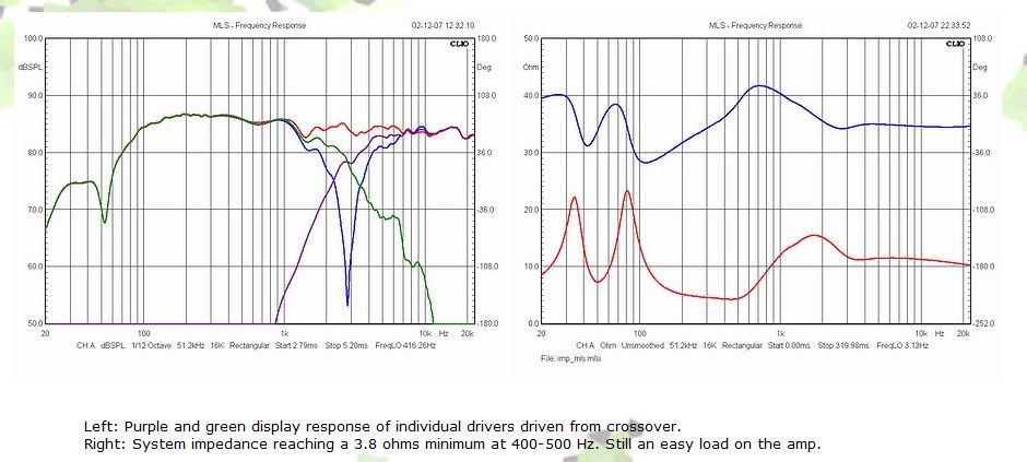

The crosssover can be one of the major contributors too the impedance characteristic. Often a big bump in impedance at the XO, and reactive components that increase the phase angle.
This is of particular concern with a GC as they are at their very best with a nice flat, benign load.

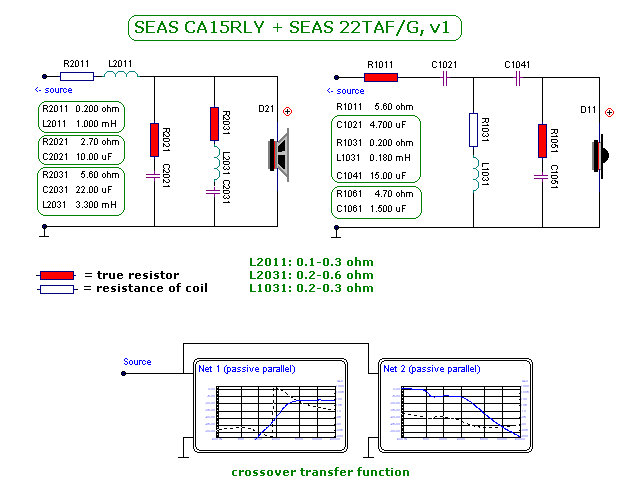

I'm liking the look of the Troelsgravesen SEAS 5INCH (CA15RLY version).

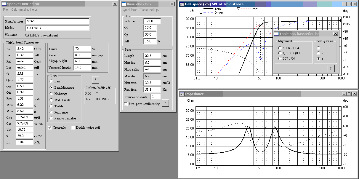

Can I essentially follow the schematic on their website to build the crossover, or do I need to make modifications. Is the impedence of this setup suitable for my amplifier, or will I have to make modifications to the crossover that is shown?
Can somebody also point out to me the details of the xover above as it will help me immensely.
I (think I) can understand that a 2 way xover consists of a high-pass filter for the tweeter, a low pass filter for the bass/midrange, L pads to attenuate the signal of the tweeter to better match the efficiency of the bass/midrange and zobel networks to stabilise the impedance across the frequency range.
What is confusing me is that a lot of the xovers I've been looking at are far simpler than the one I attached in the post above. Is it by any chance a combination of a 2nd order xover for the bass/midrange speaker, and a 3rd order xover for the tweeter?

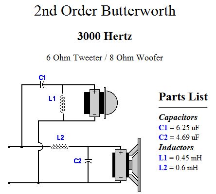

The price of the SEAS speakers isn't the problem, it's the crossovers as I mentioned earlier. Is it possible that I can just create a simpler crossover network such as the one that rabbitz made in the 2 way reference thread? Or based on my (lack of) knowledge in building crossovers, is this a one way ticket to disaster?
Would something like the crossover attached to this post be a possible starting point to which I can add to after, when I have a better understanding of the crossover's influence on a loudspeaker?
I don't mind if I end up with something that is less than optimal as long as it sounds decent to my ears, remembering that I am not yet an audiophile. It would be a better learning exercise for me rather than just buying a kit with a prebuilt crossover.

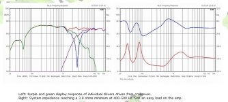

The CA15RLY speaker dips to 3R8 and would be roughly 5R4 nom so may be too low an impedance for the LM3875 with high rails. The low impedance occurs in a range where there is a lot of energy in music. You can see the impedance graph in the pic (red line on RH graph).
The crossover you've shown consists of 2nd order for the woofer with a LCR network, 3rd order crossover on the tweeter with a RC network and a series padding resistor at R1011. The crossover that Troel's has done is required to ensure correct filter behaviour, summing, phase etc with the drivers he has used so can't be dumbed down to achieve the same result. You just can't take textbook formulae and apply it to drivers as it rarely works. Any crossover is dependant on the raw driver behaviour, impedance etc. The one in the 2-way ref thread is very simple as the drivers are very well behaved and I generally spend most of the time during the design stage choosing drivers that are suited to simple crossovers. It's time consuming but in the end pays off and saves money on crossover components which means I can use higher quality drivers if desired.
I'm glad you latched onto what I was meaning with the costs as complex crossovers add up quickly and can surpass the cost of the drivers.
You are better off finding an existing design with the parts count that are within the budget rather than trying to mod a design like the 5 Inch CA15RLY as it will likely end in tears and more expense.... unless someone has already done one.
I'm amazed as to how much each one of your posts has helped me grasp more about what I am trying to achieve. I hope all of my questions do not scare you away, haha.
I have been reading the specs of the CA15RLY speaker and noted how low the impedance could drop over the frequency range, that didn't look suitable to me and you have confirmed that for me.

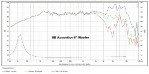

I've just received an email from Dan from Darcher Audio and he has made some suggestions that may be possible solutions. I've only listed the options that I feel are possible for me.
we have just received shipment of Mark Audios new woofer and tweeter too. Which would be a great start in the 2 way arena. The woofer itself extends up to around 5khz and the tweeter can be crossed over as low as 1.5-2khz. So you give yourself quite a bit of flexibility to crossover between 2 and 5khz. And crossed over high enough, you will be able to use a simple crossover, possibly first order. And the good thing about them too is they are inexpensive. You could build yourself a pair quite easily for $150. And efficiency is around 87dB Woofer details can be found here Mark Audio Woofer No. 6 - Black - PAIR [W6-White] - $89.00 : Darcher Audio <Mark Audio Woofer No. 6 - Black - PAIR [W6-White] - $89.00 : Darcher Audio> and tweeter details (yet to be listed on my site, should be on there in the next few days - $39 per pair) here Tweeter No. 3 | Markaudio
another suggestion
You could combine both the Mark Audio tweeter and the 6" SB woofer. Mark from Mark Audio generally designs drivers to provide a simple, easy solution to great results as shown in his wide range drivers, so you could one again use a simple crossover with the drivers and could end up with some great results. Only issue is with the SB Acoustics woofer, is the breakup from 3.5khz onwards would need some taming, so you would need a pretty steep roll off with the crossover to do that.
another
Another way is to go with a pair of small 70mm drivers (CSS EL70 or Mark Audio CHR-70) in series per speaker which yields a nominal 8 load and provides great dynamics. Once again, not all that efficient so comes down one again room size and amp output. Total there is around the $280 mark.

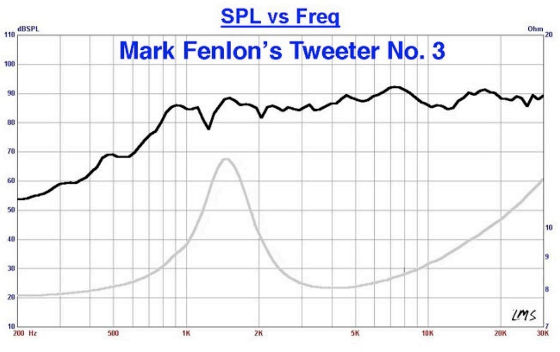

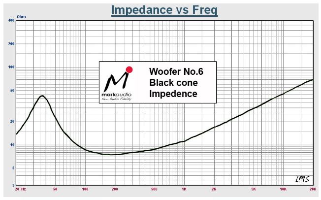

The fullrange drivers look to be of too low an impedance, but the graphs that support the MA tweeter, MA woofer and SB woofer look like they don't drop too low.
Though, this has me thinking, when 2 speakers are wired up together (assuming parallel), the combined impedance will drop if my thinking is right. I'm guessing this can be compensated by adding resistance to the crossover?

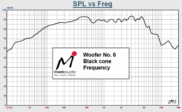

Nipper, for a woofer, a bass reflex (tuned) box will extend the lows about another octave; adding resistors to woofers is a bad idea, it wastes power & efficiency - better to choose drivers that match in efficiency - usually the woofer needs to be a bit more sensitive to compensate for the baffle step loss - that occurs below the frequency where the driver starts radiating into full space rather than half space - determined by the width of the baffle & speaker placement - if against a wall it's not a problem

Very interesting. My speakers are going against a wall which I guess from your post means that my bass should always be radiating forward into half space.
TBH, I haven't seen many cheaper woofers around that high higher efficiency than the tweeters. As far as I'm aware, this can be attenuated with an L-pad, correct?
I'll also mention that I misinterpreted Dan's suggestion with using the 4 ohm FR drivers. I didn't realise that you could wire drivers in series. That is how he came up with the 8 ohm nominal figure.
By going of Dan's previous suggestion, if I bought the MA tweeter and MA woofer and crossed them over fairly high, would I be able to get away with a simple crossover such as rabbitz in the 2-way reference thread. I'll attach the frequency graphs if it helps. When designing a crossover, are you looking at how the SPL fluctuates with frequency, I'm guessing the smoothest curve possible would return the best result?
Going back to my last post which probably didn't make much sense, this is my current understanding.
If I use two drivers that have an actual impedance that does not drop lower than 7 omhs anywhere along the frequency band, connecting them in parallel would see the total impedance drop to 3.5 ohms which is to low for my amp. I'm guessing the impedance of the xo itself helps to bring it back up to a more acceptable level. Hopefully not all of that is complete rubbish, I just want to try and grasp this better so everyone's efforts will not be put to waste.
I have a project using 2 of the MA #6 woofers in an MTM with an FF95 (could be any FR). I have the tweeters too but haven't slotted them into a project yet.
