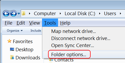

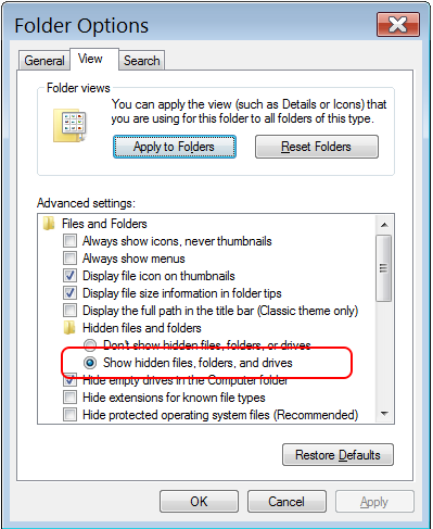

By default it is a hidden folder, and should already exist... Open any folder and press Alt, to get the File menu, then go to Tools and choose Folder Options. You can then turn hidden folder view on.

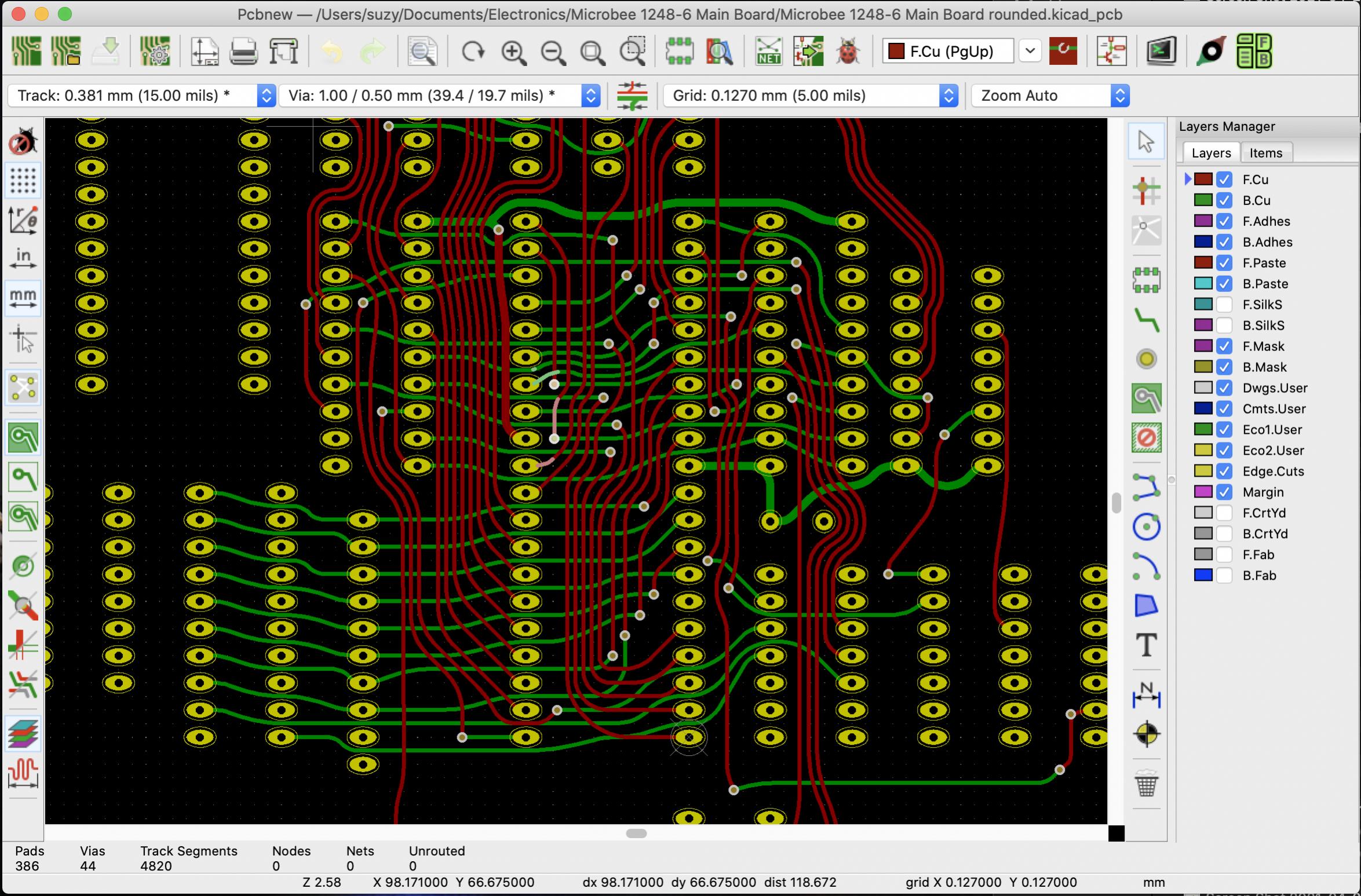

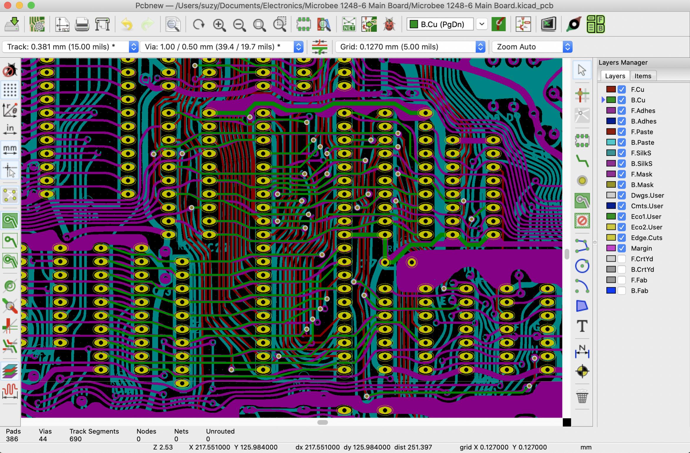

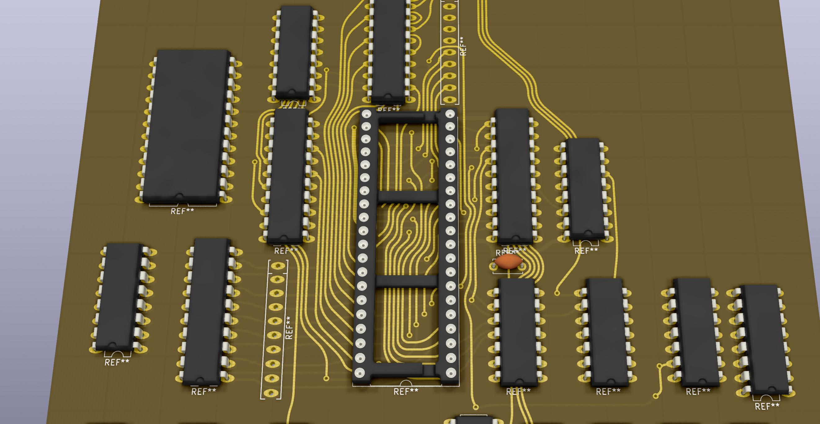

I've been playing with some designs for very old computing gear. The original stuff was done with crepe tape and bishop graphics. I thought it might be fun to use KiCad to replicate the look of this old gear.
It does a really bloody good job. Key to this is the "Round the Tracks" and the "Teardrops" plugins.
The design flow is straightforward - get an image of the artwork you want to work with - in my case it's 600 dpi scans of an old computer motherboard. Do some image processing in the gimp to improve the contrast between traces and PCB as best you can, then import the image into KiCad as a silkscreen component.
Then, place components and route, using the silkscreen as a guide. Finally run round the tracks to make your tracks flow nicely.
I've included a few images - firstly the screen I work with mostly, showing the scans on silkscreen layers, then the placed tracks after smoothing, and finally a 3D rendering showing how bloody nice the final result is going to look.
Another cool one is arbitrary pads. I've created an elliptical pad, which matches the old Bishop Graphics ones of the seventies and eighties. I've used it for all the DIP parts on this board. It's just two arcs and a hole, but it's a perfect model of these beautiful pads, and this is the first time I've ever been able to do that.
