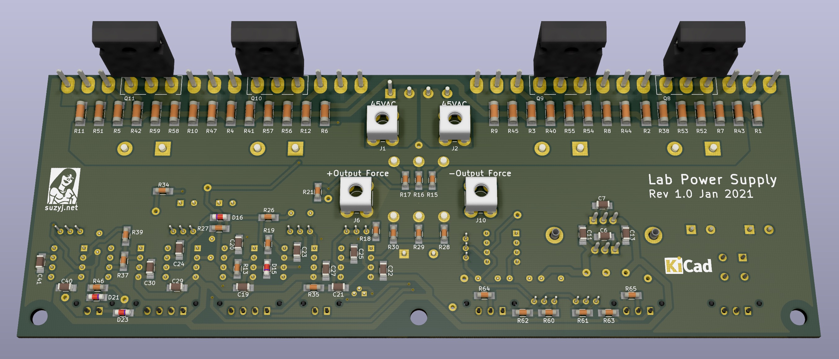

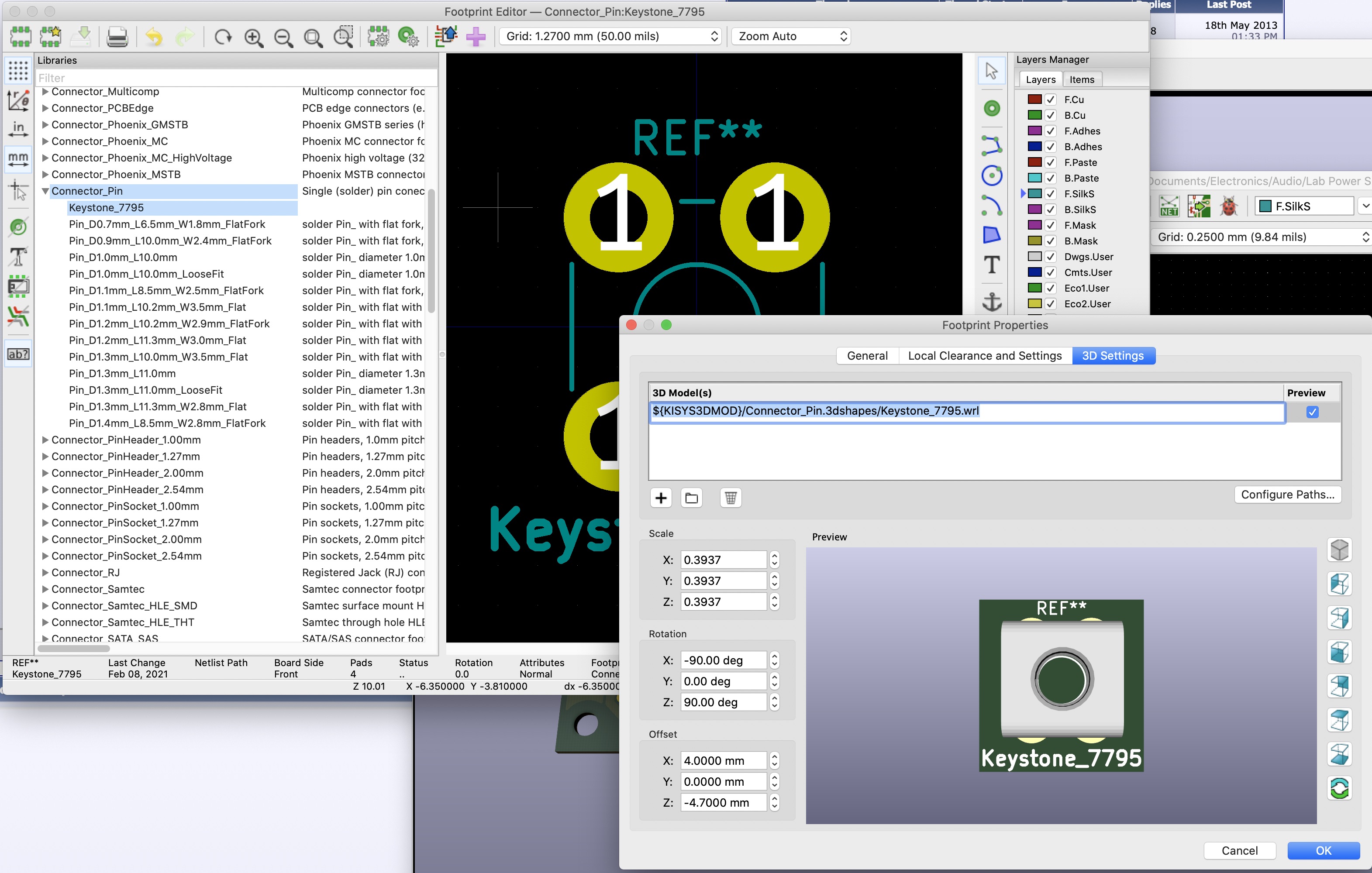

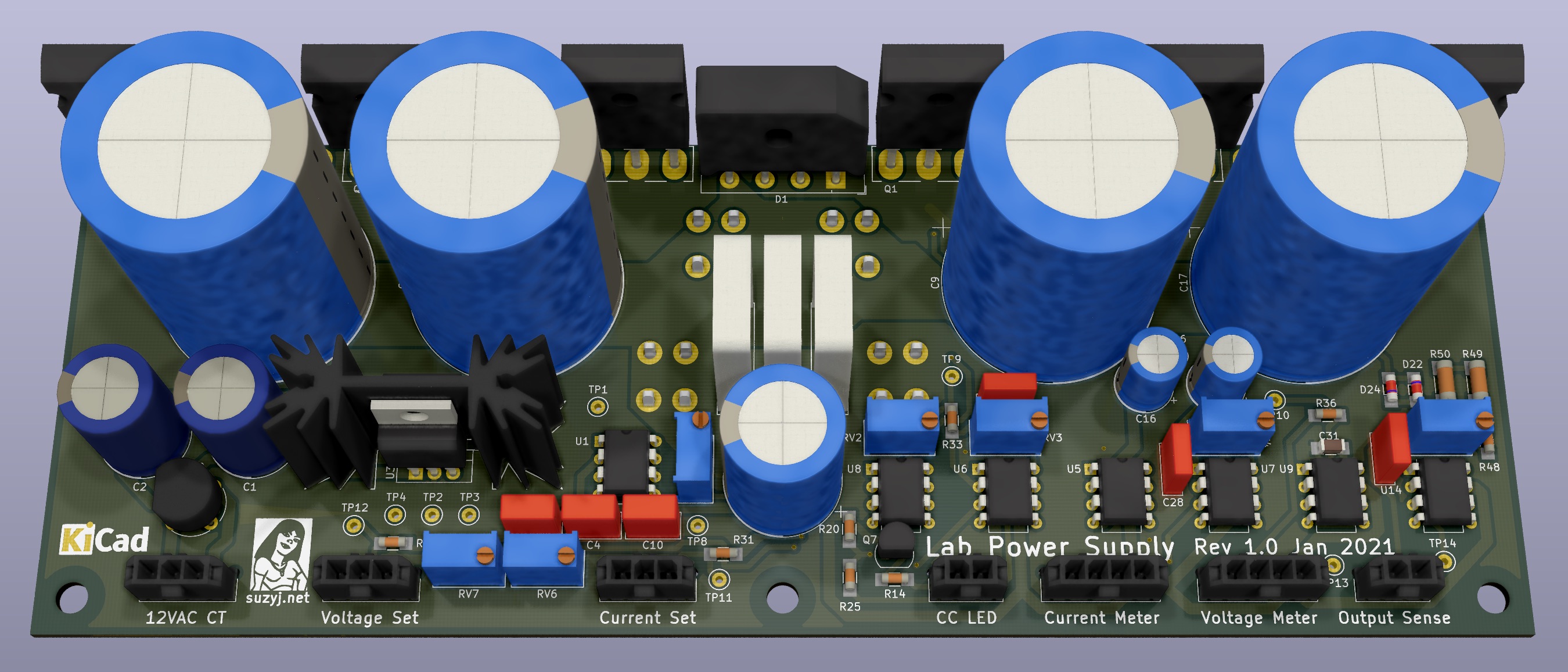

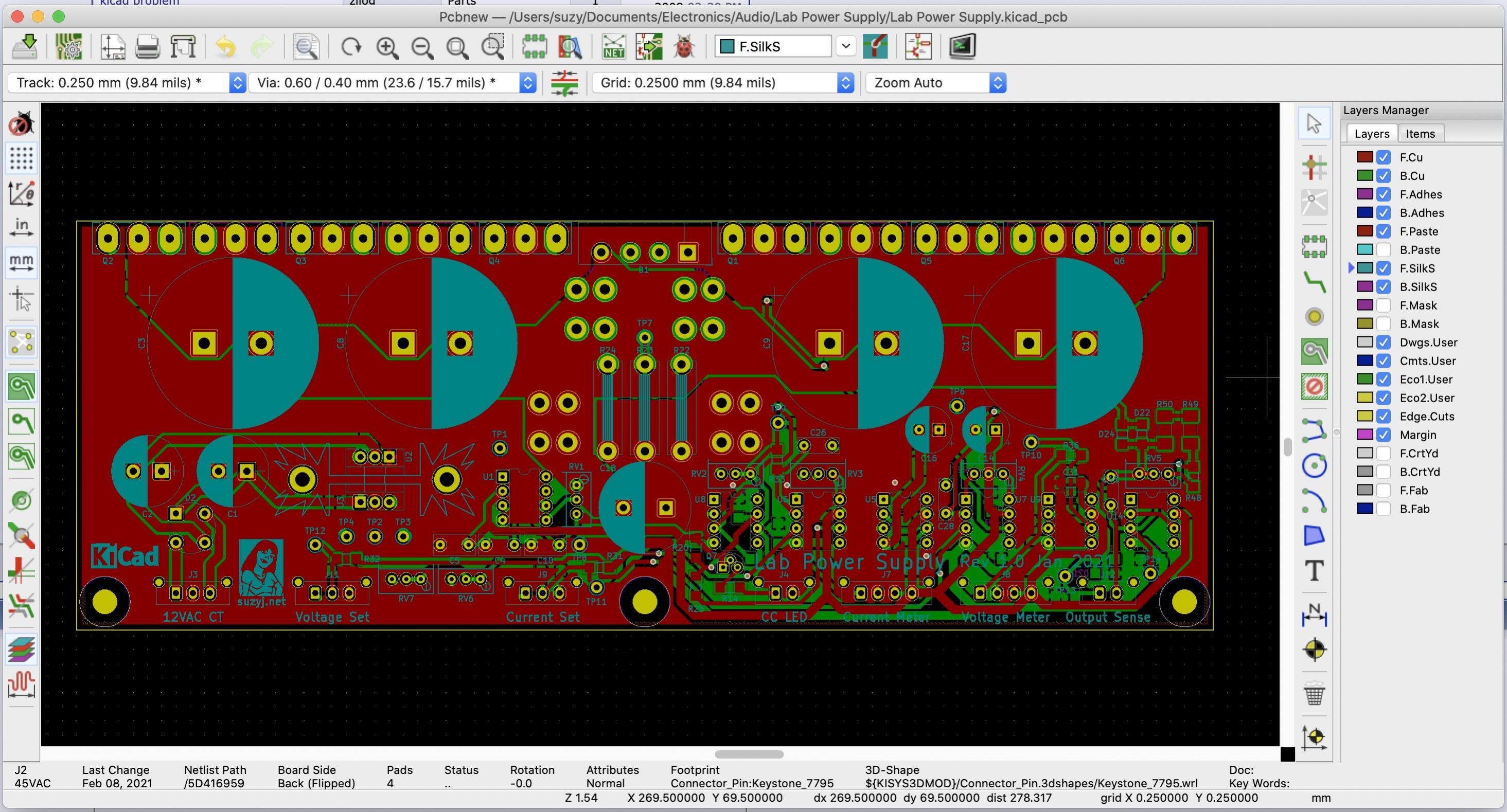

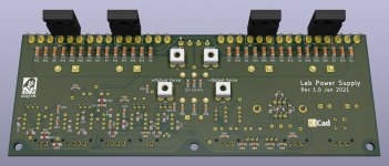

Newbie question finding component footprints
I'm trying to learn Kicad by modifying an existing project that a member has kindly posted on this site, namely Jeff Young's F3 PCBs.
I want to change the component footprint for one of the power semi's in the design. With a through-hole adapter made available in the Lu1014 GB thread, I figured I could just change the Lu1014 footprint to match those for the IRFP240s already used in the project and get by with a quick and dirty solution.
But I get the following error when I try to change the footprint for the Lu1014:
Error: Update footprint “Q2” (from “TO_SOT_Packages_THT:TO-247_Horizontal_Heatsink”) to “TO_SOT_Packages_THT:TO-247_Horizontal_Heatsink”: *** footprint not found ***
I'm guessing it's because the specified footprint was custom created by Jeff in his initial design, and so it's not in the standard footprint library for Kicad. I'll be going through Kicad's documentation next to try and figure out how to resolve this error message, but figured I might get a faster answer by asking in this forum.
Thanks (in advance),
Dan
Are you using 5.1 or 5.99? (If 5.1, switch now. 5.99 is much better.)
Do an 'Ctrl+E' ('Cmd_E' on Mac) over one of the IRFP240s. It should open it in the Footprint Editor. Now do a save-as to whatever library you want to put it in.
Now you can update the Lu1014 (and all the IRFP240s) to point to that library entry.
